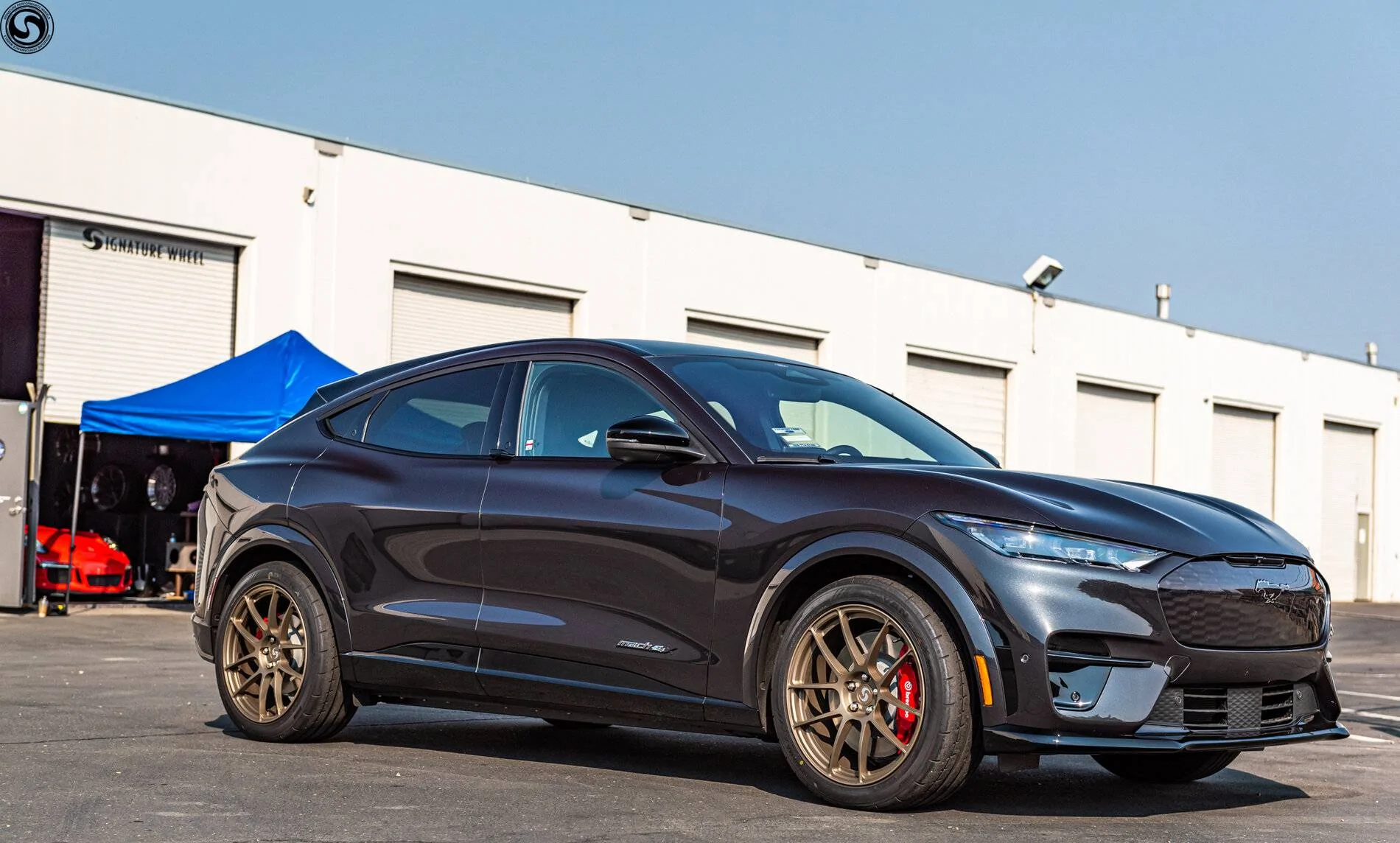

This is a good question but definitely a loaded one. When you are considering the best size tire to run you also have to consider what size wheel you are using. There is no benefit from running A tire that is wider than the Wheel you are putting on the car.
Ford Mustang Mach-E Square Tire Set Up... how wide? 4FDD780C-F992-434A-8A6F-6EE74A481616

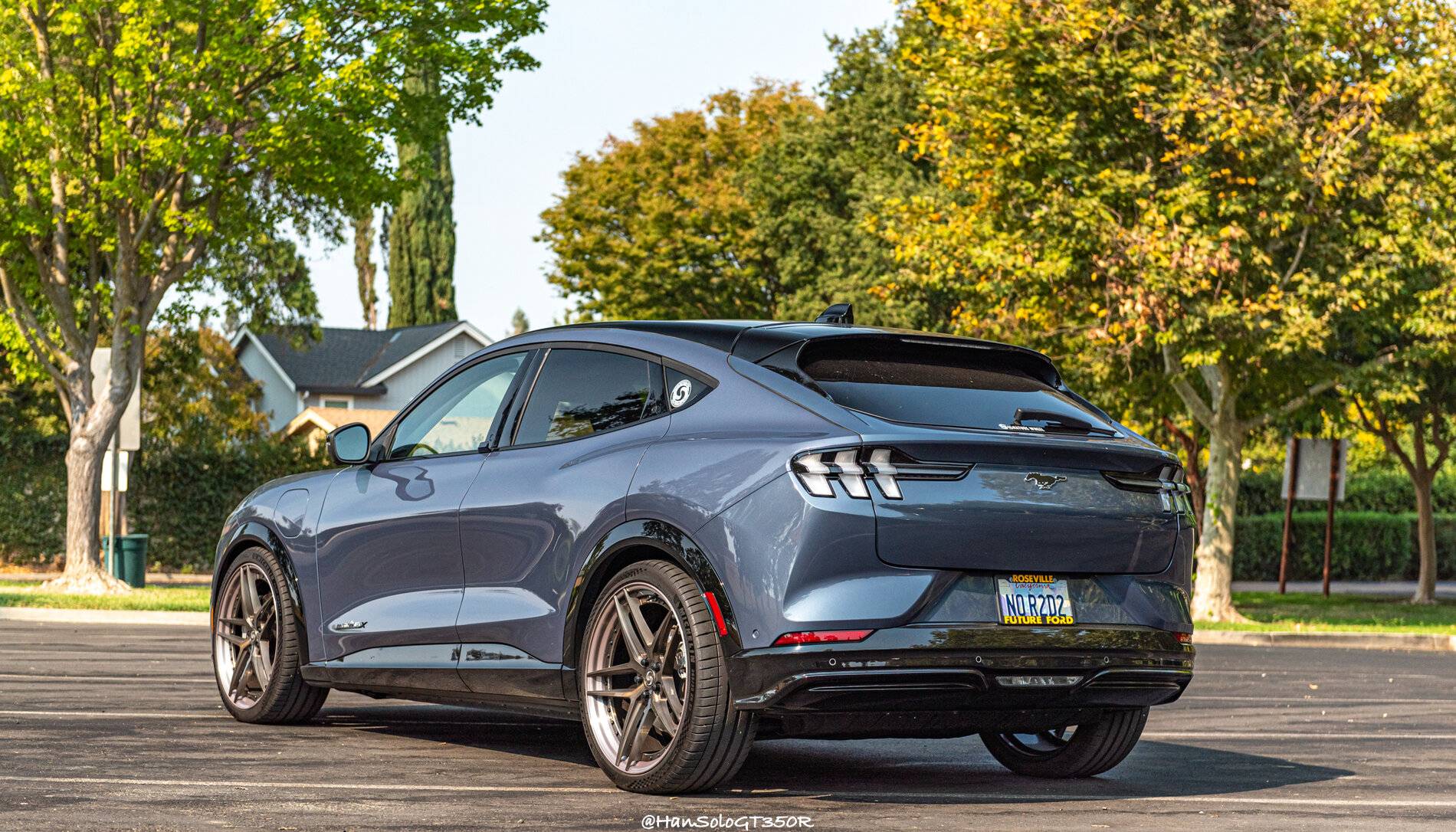

In terms of clearance that all comes down to the offset that is being used for your wheel. You will need to make adjustments to the wheel fitment if you want to run a wider tire. Assuming you do not want issues with rubbing on the strut or fender liners. One tire may fit a particular wheel and another might not.
