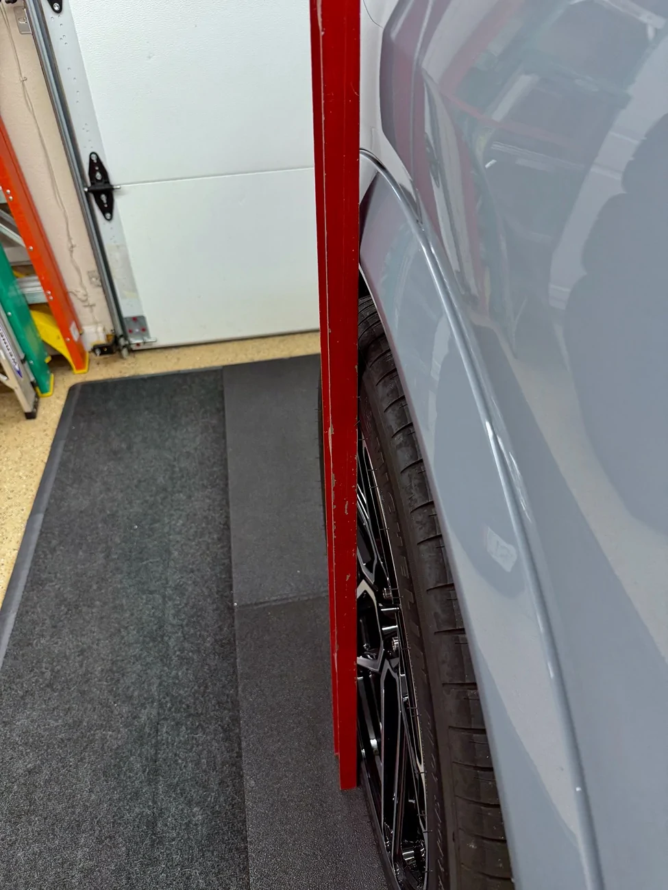

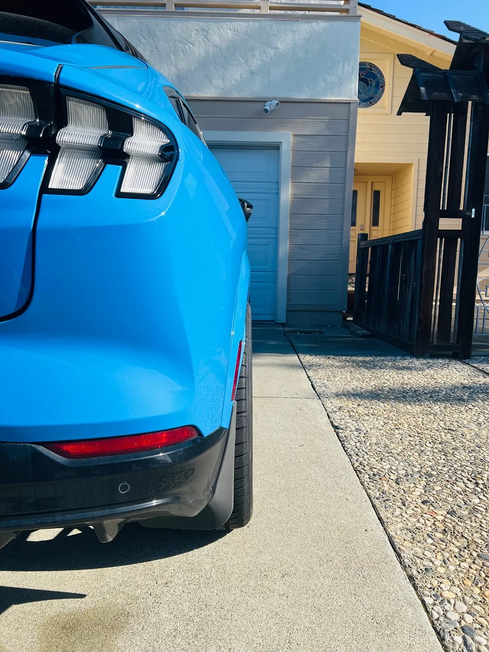

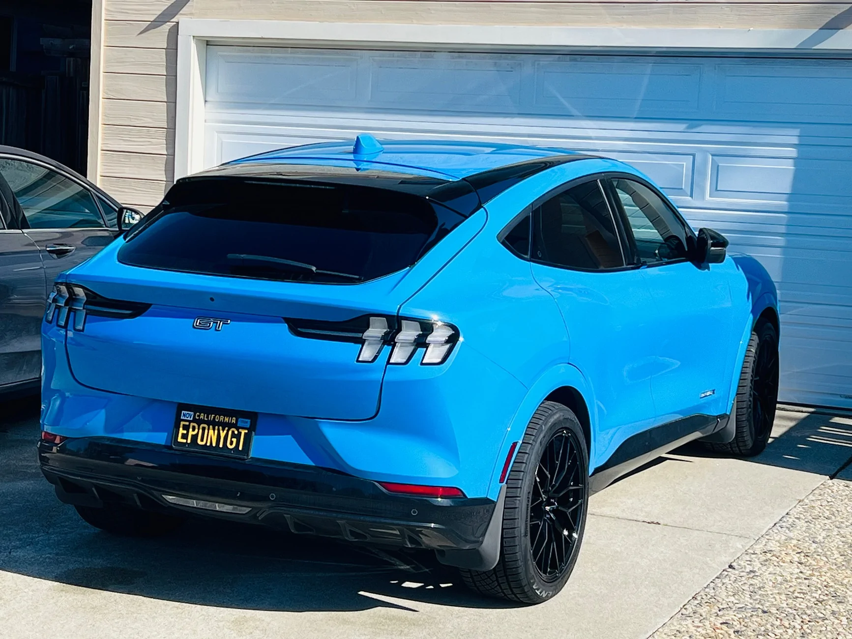

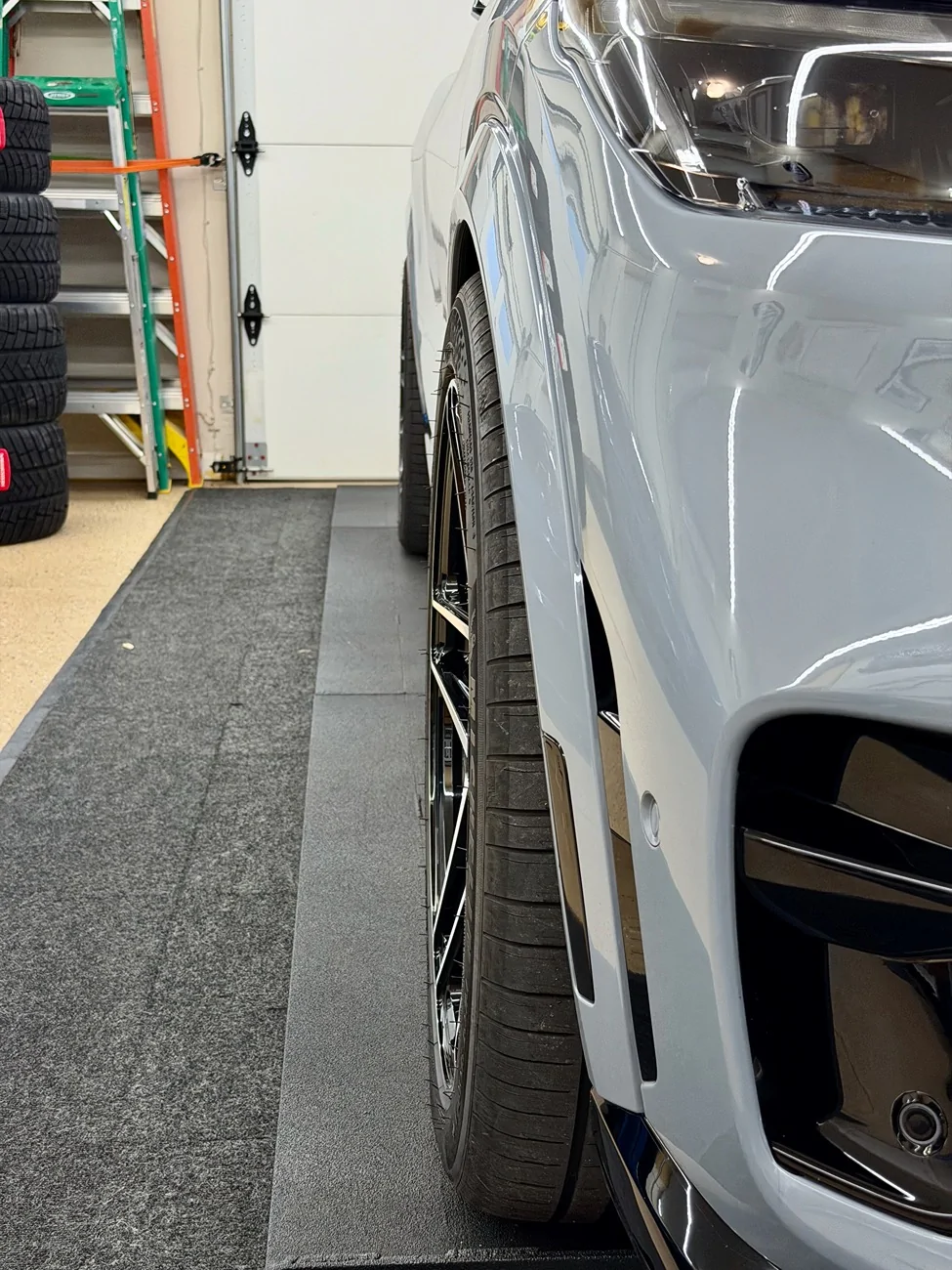

Yes Chris, this setup works. Either wheel size (9 or 9.5) and 35-40 offset. I have run this setup in the past on both my '21 and my '24 GT, a 9.5" wide wheel with 40 offset. I am currently running the same wheel width and offset but now in a 21" wheel. The 40 offset in the rear is no issue, in the front the tire inner sidewall is extremely close to the strut. Just want you to be aware of that. If you have the camber set to around -1, you are ok but any more negative camber than that and the tire sidewall may rub. Also depends on the shape of the sidewall. Some tires have a rounded sidewall while others are more flat. If you want to be a little more safe might want an offset between 35-37. I like to have as little poke as possible so that is why I run a 40 offset.

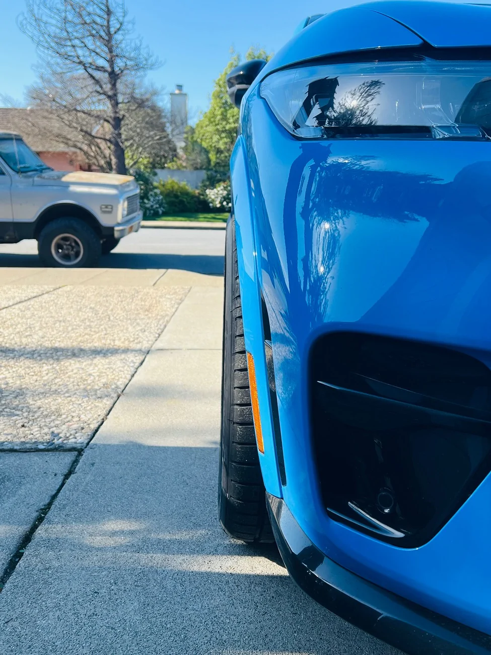

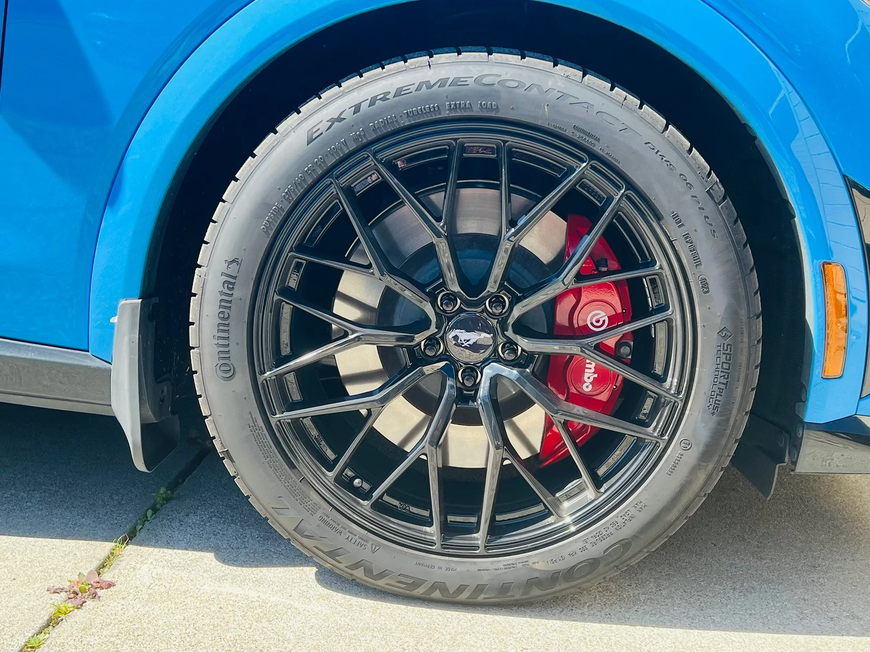

Steve (HuntingPudel) also runs this same setup with 9.5" wide wheels and a 38 offset with Continental ExtremeContact DWS 06 Plus.

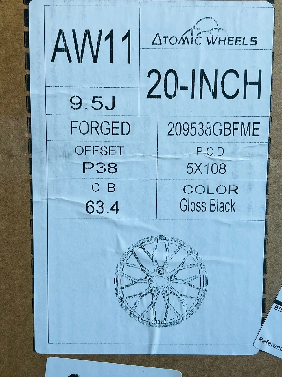

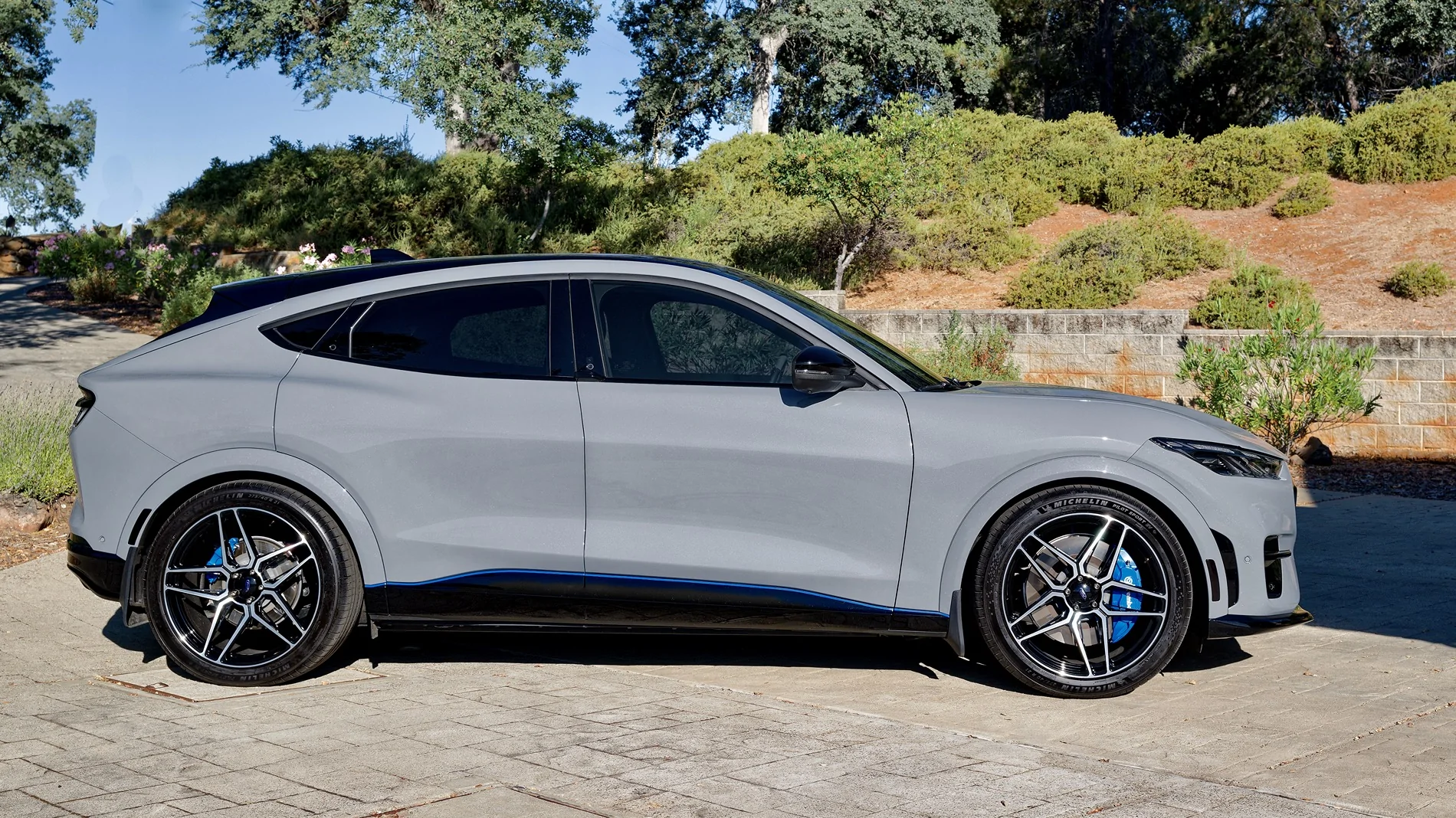

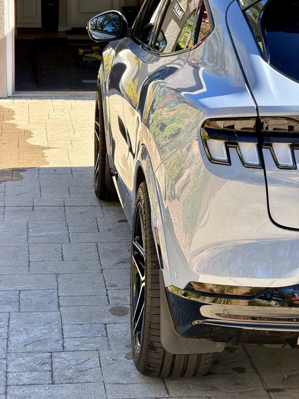

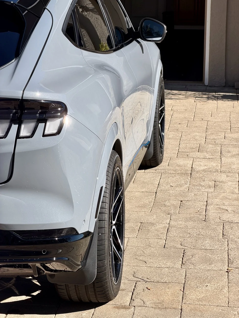

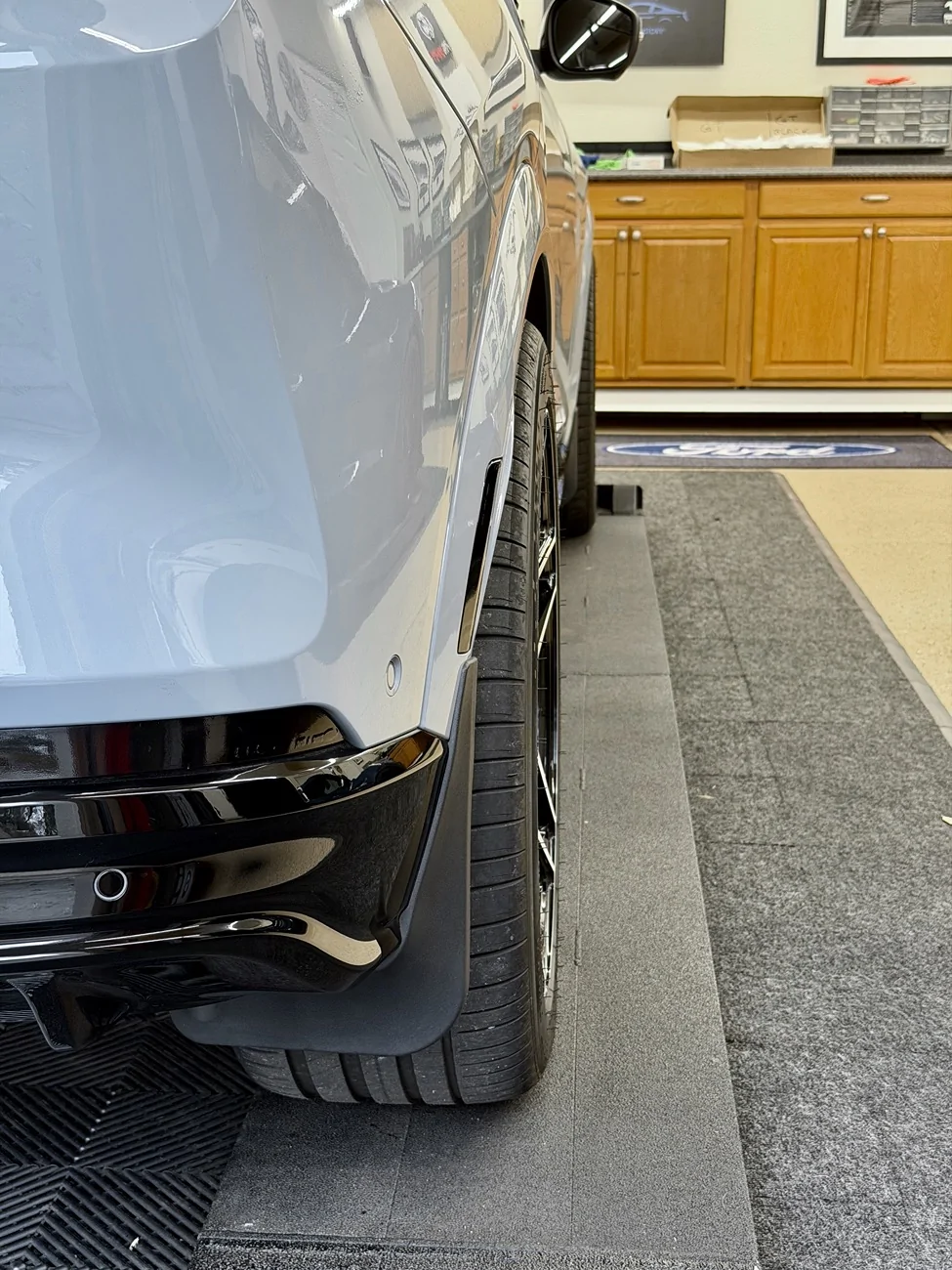

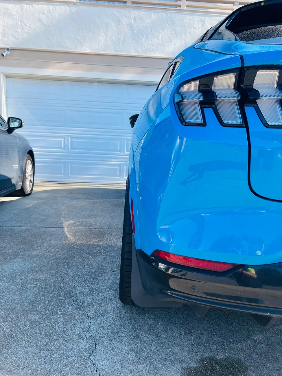

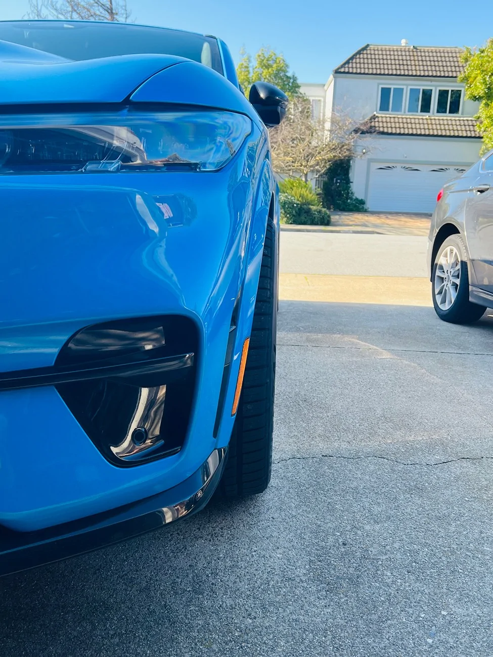

As @markboris said, I am running 20x9.5” rims with a 38mm positive aftermarket offset. 😁🐩
Ford Mustang Mach-E 275 square set up IMG_4170
I am running Continental DWS06 Plus tires in 275/40R20 and run them at 38 psi. You would need to drop the tire pressure on a 9” rim to 36 or 35. No modifications to the car are necessary to run this setup, but aftermarket anti-sway bars will help extract the performance capability of a wider tire. 😁🐩
