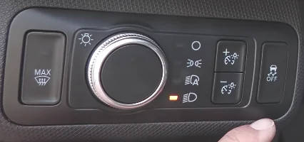

Also, you don't need to do a reset to get it to restore. Just use the +/- buttons to the right of the headlight dial and the screen will be bright again.I took The Pony in to get this problem looked at - my middle display has periods where it is dim or completely black.
