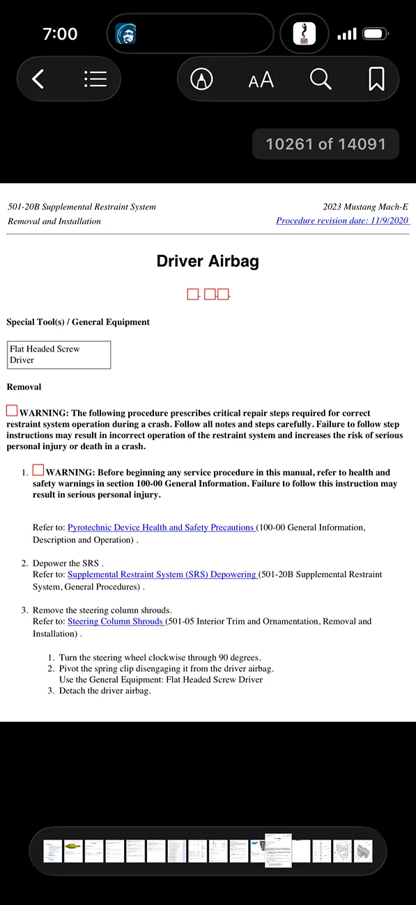

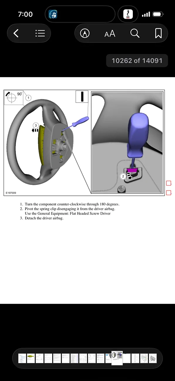

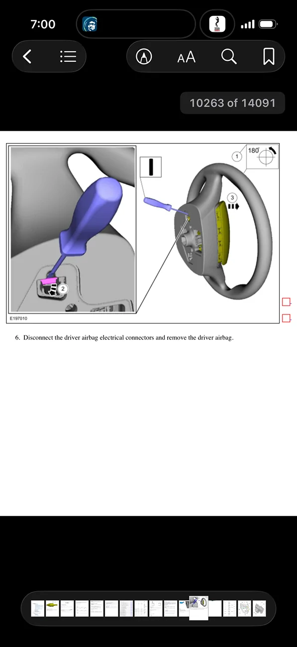

I didn’t see instructions on removing the steering wheel shroud. But there are two screws on the bottom part. Then take the bottom shroud off. Turn the wheel to the 6 o’clock to pop out the tab for the airbag. Then turn to 12 o’clock for the second tab.
Ford Mustang Mach-E Steering Wheel Accessory Switch Replacement IMG_0112
Ford Mustang Mach-E Steering Wheel Accessory Switch Replacement IMG_0113
Ford Mustang Mach-E Steering Wheel Accessory Switch Replacement IMG_0115
