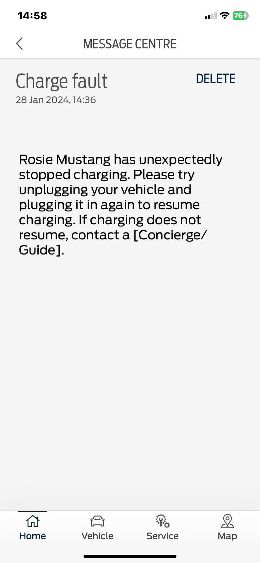

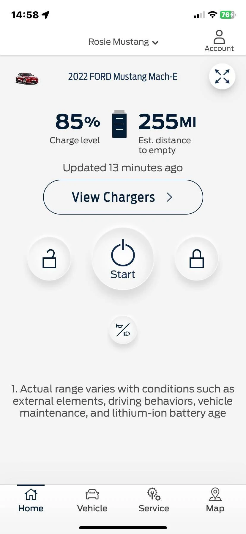

Firstly apologies if this is posted incorrectly.
My MME AWD EXTD built July 2022 is displaying the above warning. I plug into my home charger every day to keep topped up to 90%. Returned from a drive this morning car was showing 85% so I plugged in leaving it charging from the solar panels only (sunny here for a change). Charging port showing flashing BLUE so ok at that time.
Checked 20 mins later following the alert from Ford Pass and charging port was RED. Unplugged and tried again - same result. Unplugged - tried to start car - result as per video - will not start. HELP please! Only just had Rosie back from a successful visit to my Ford dealer to fix a rattle.
Ford Mustang Mach-E Stop safely now warning IMG_0489
Ford Mustang Mach-E Stop safely now warning IMG_0488

Aha - just found and read the excellent troubleshooting guide for this fault on the Forum. Left Rosie for 30 mins and normal function is restored - what strange but wonderful cars these are. Sunshine is over for today so have plugged her in again this time for a scheduled overnight top up on the cheaper rate - charging port light showing BLUE.
