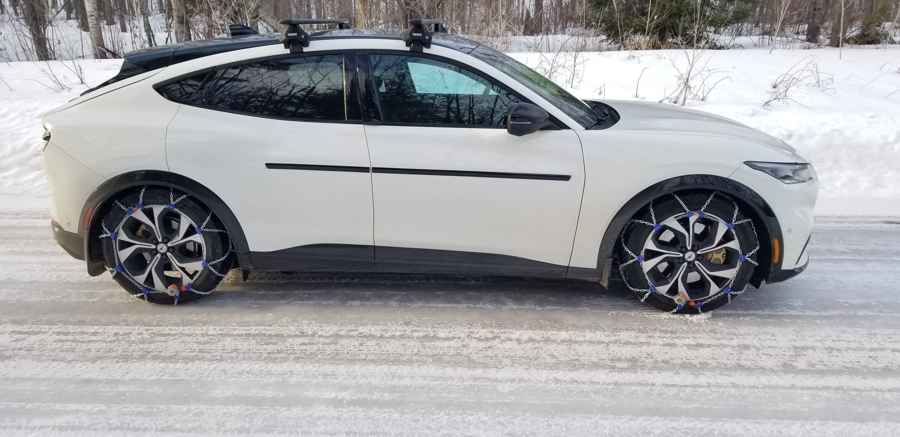

I chose to get (and by now, use) German RUD EasyTop V snow chains.
Easy to put on (less than a minute with practice), very easy to take off. Grip on snow and ice is very good. Just don't go over 35 mph while wearing them.
See pics.
Ford Mustang Mach-E Studded tire recommendations ? 20230219_155805
Ford Mustang Mach-E Studded tire recommendations ? 20230219_155818
Ford Mustang Mach-E Studded tire recommendations ? 20230219_155929
