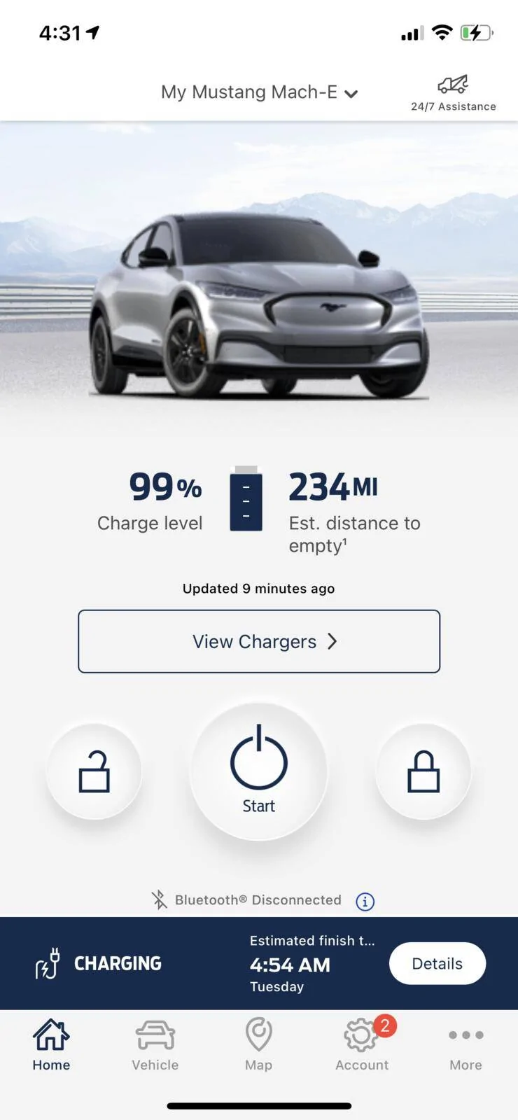

This is happening to me right now
Sacramento CA

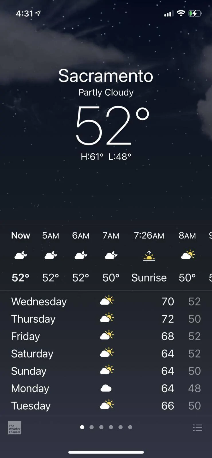

Here’s a pic of my scenario
50 degrees outside over night
I should be getting 300 miles - this is a CA Route 1
Looks like I’ll end up getting 235-236 miles
So, it's important to remember that it only "looks like" you be getting 235 miles. What is important is to track your consumption over your normal driving, and then use that to calculate your real range. My GOM range shows around 230 now, but my calculate range is 265 which isn't bad for 50F. The car will do this, but it is slow to correct, I'd guess 500 miles or more in these conditions.
Here's how I think the GOM at least partially works. It has a bunch of look up tables for base range in certain temperature windows. Those base ranges are incredibly conservative. Then the car looks at the driving history in each temperature band, and makes adjustments to the estimated range based on your consumption at that temperature. But, if all your driving is outside of the current temperature band, it only has the base range data. NOTE: this is just my guess based on how I've seen my GOM behave after taking delivery, after a 12V reset, and now as temperatures drop.
I am guessing that Ford is doing it that way since cabin heating can contribute heavily to overall consumption. If user A set the temp at 60F in the winter, they'll see much different range than User B who sets the cabin temp at 75F.

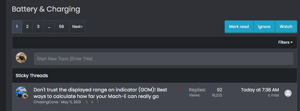

This section would benefit from a "sticky" specifically about cold weather and GOM range. There doesn't seem to be one specific to cold weather.
timbop
Jan 3, 2020
6,832
14,036
are you sure?
Ford Mustang Mach-E Sudden drop on range according to the GOM Screen Shot 2021-12-10 at 12.55.46 PM
KevinS
Oct 11, 2021
1,515
2,831
2021 Mach-E (sold), 2023 Ioniq 6 SEL
Doesn't say anything in the title about cold weather, which was my point.
