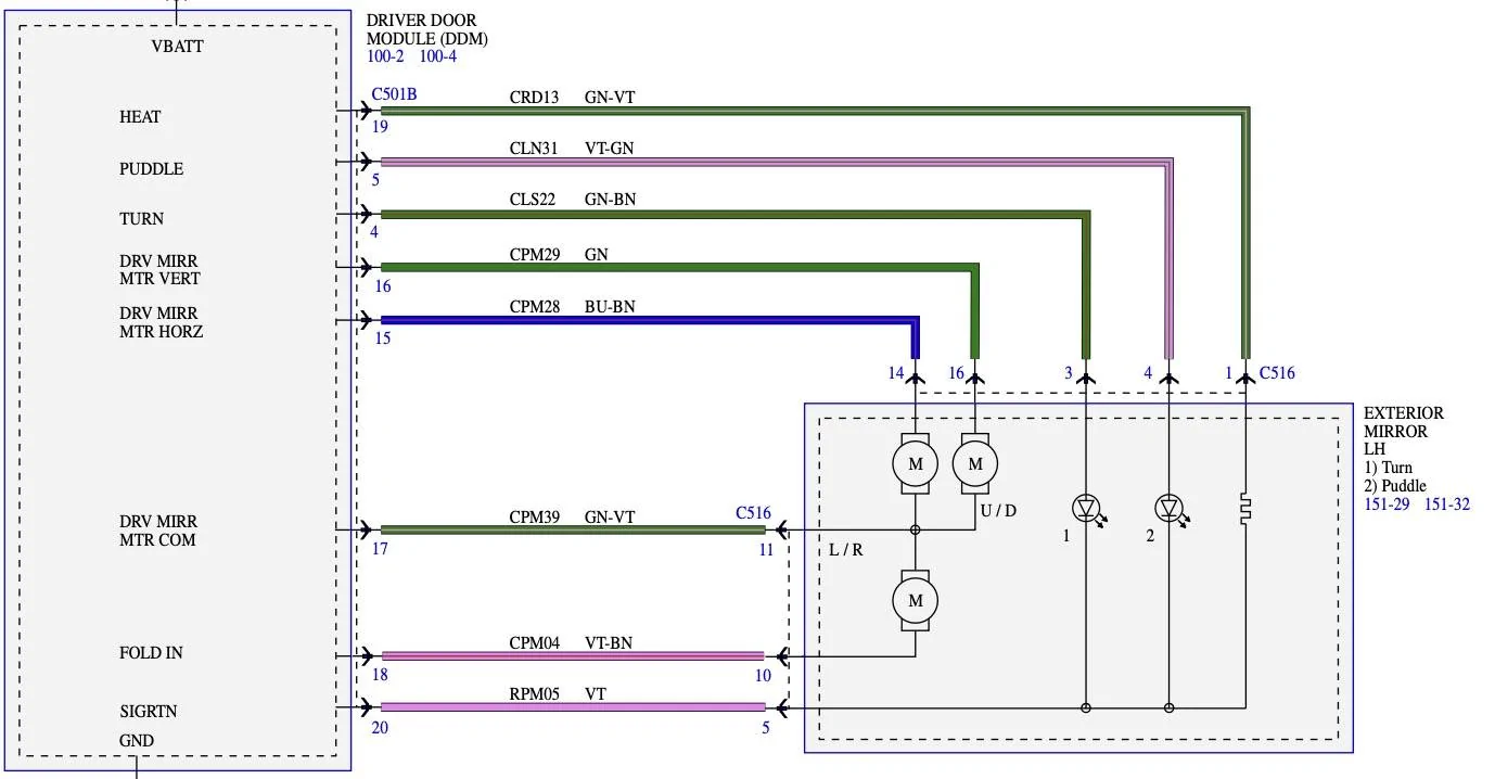

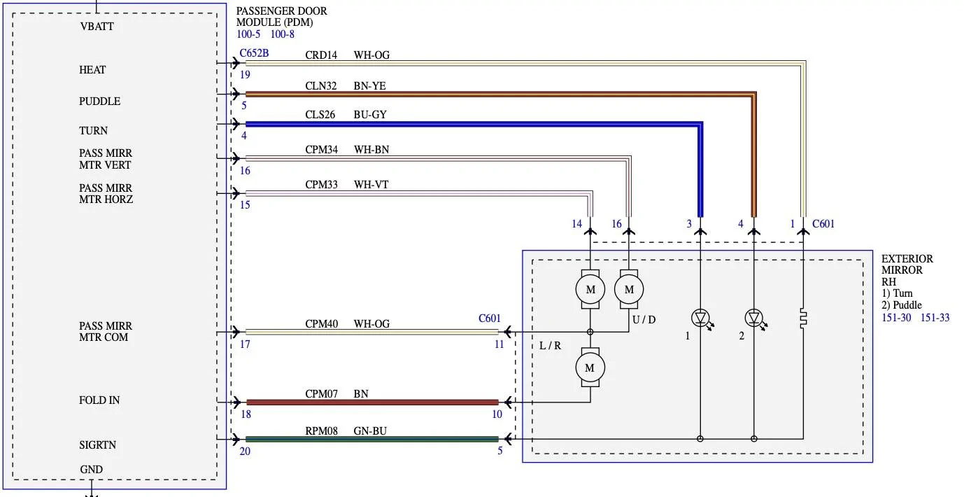

Chris, I don't know if you can tap into these wires to power the turn signal lamp in the mirror but you can try. Sometimes doing so will cause the door module to go crazy but it should not mess it up permanently. When I was wiring up the puddle lamps to come on any time the doors were open, I ran into crazy behavior of the door modules (but did get it to work).
Driver's door turn signal lamp is Green/Brown for +, Violet for -

Passenger door turn signal lamp is Blue/Gray for +, Green/Blue for -
