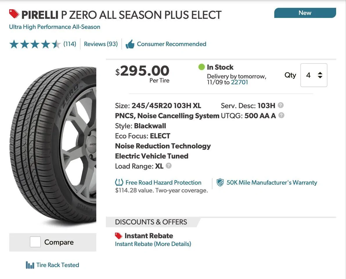

Bought mine first week of November in Virginia, and the seasons would change soon, making it difficult for the high performance summer Pirellis to handle things well, or perhaps even survive.
We don't have huge amounts of snow, but we have months of weather below 40. This morning it was 18 degrees when I finally got the courage to look at the thermometer.
This is what I ended up choosing after considering everything. These are the only tyres that looked to me to tick all the boxes.
Designed specifically for heavy EV, and to eliminate noise in addition to what you'd usually want out of a cold weather, all season tyre.
Very quiet. Range remains in the 3.3-3.7 mi/kWh range for me with about 120-140 miles/day.
Good lateral grip for a compound that doesn't reduce range.

These look like all season to me. I’m not sure if you’ll get any advantage with sub-40 degree weather as the compound is not specifically designed for low temps.
I’ve been running Michelin x-ice snow / winter on several vehicles including Mach-E and love the physics-defying performance. Range is great too.

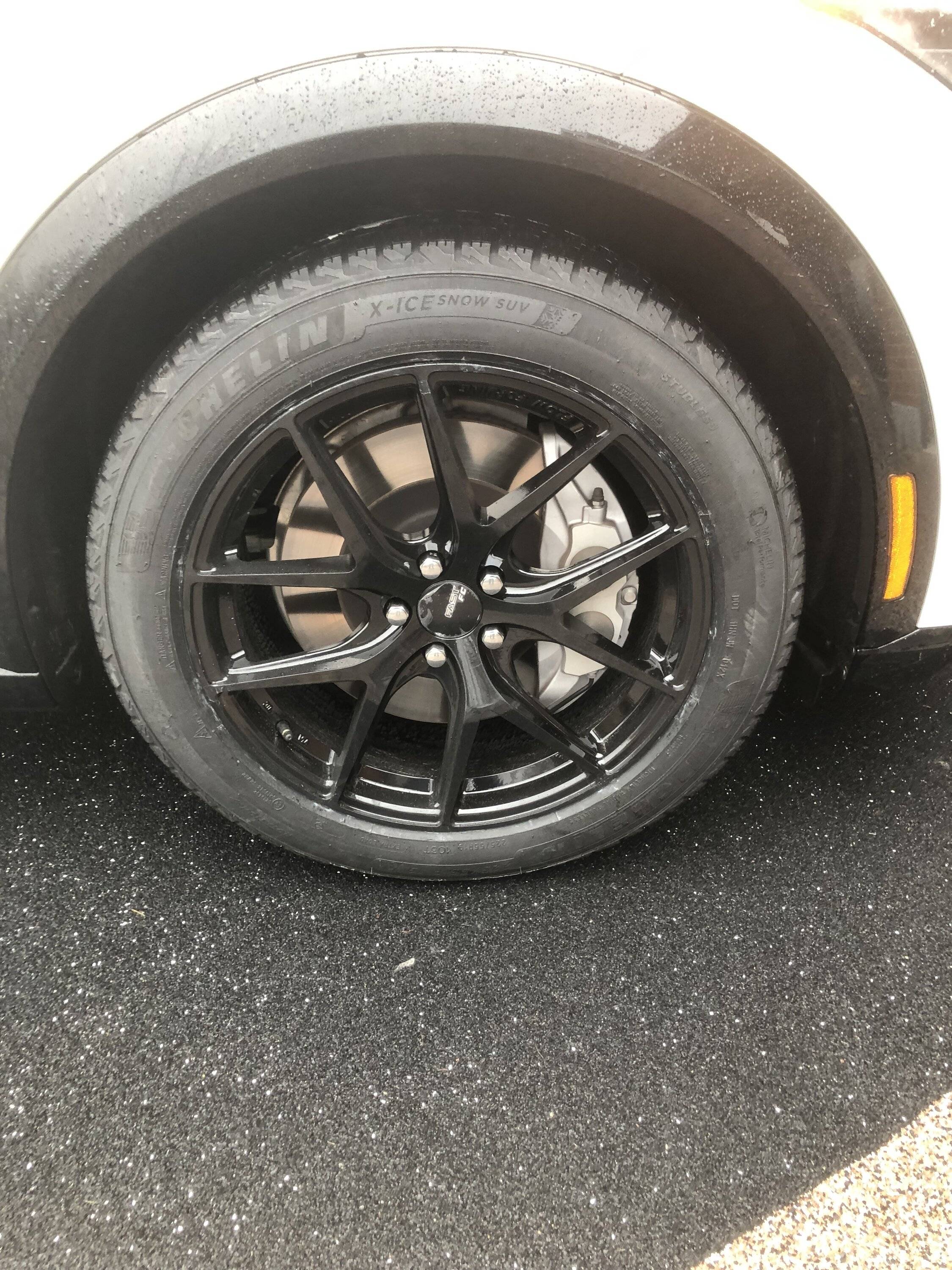

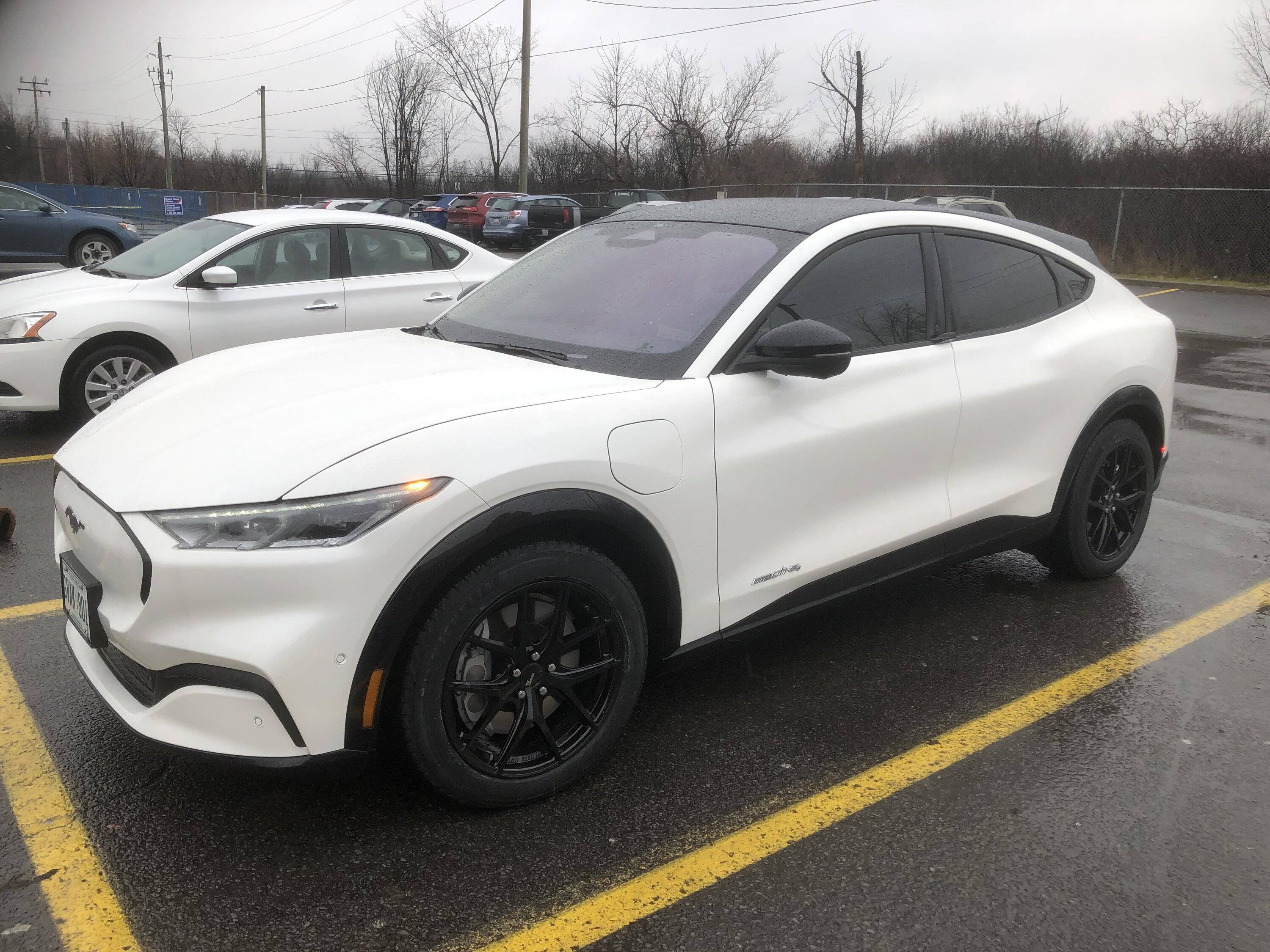

Also using Michelin X-ice for last 2 winters on the Mach-E and they have been good for range and winter handling in snow or ice.

Seems like a good choice of tire for a place that rarely gets snow but does experience temps below 40F for a few months of the year.

We did the PIRELLI P ZERO ALL SEASON PLUS ELECT for our winter tires. Mounted them to 4 new wheels as well from Tire Rack. Then shipped them direct local Discount tire to be install on vehicle.
Snow here varies but we have the Mach E and a Rivian (for the deep stuff if needed)
