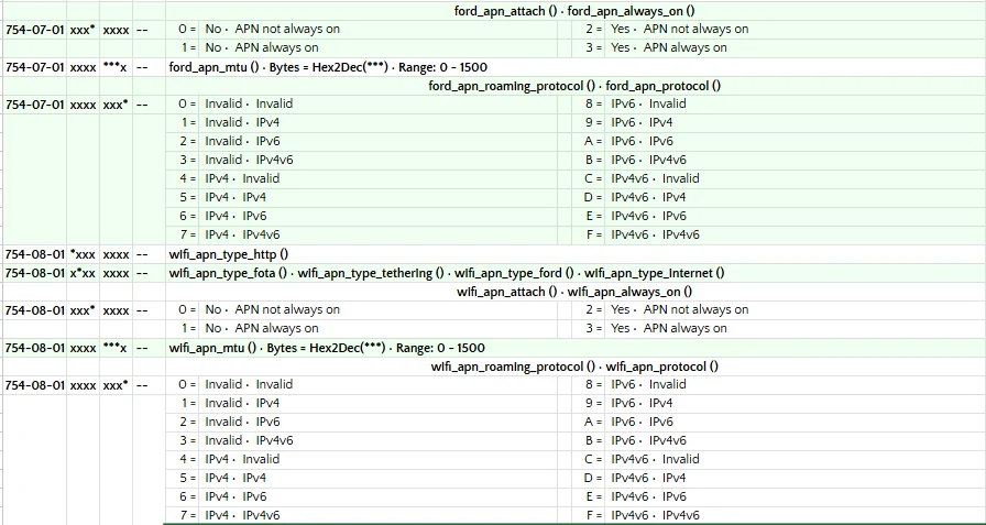

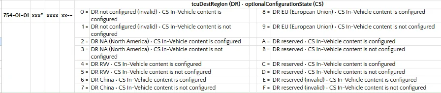

Wait, you will also need to go here and change it from NA (North America) to RW (rest of world) or possibly EU (european union). I'm not 100% sure what Ford uses here for your market.
Ford Mustang Mach-E TCU Conversion NA to EU esim to sim 1783362151407-zh
Some APN config changes may be needed, too. I am not sure what is correct in your country. I would get the VIN of a vehicle in Armenia that was built for your market, pull the ab data from it and look at how the TCU is set up in these areas and manually reconfigure the one you put in to match the Armenian vehicle.
