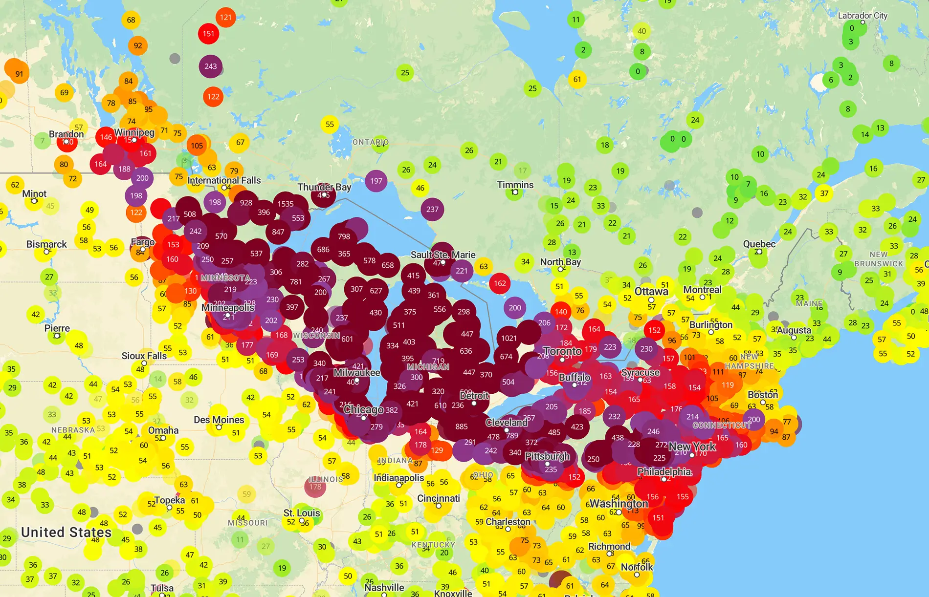

With Canadian wildfire smoke becoming a more frequent and persistent problem each year, it’s worth considering how it affects air quality inside vehicles, especially on heavy smoke days. To investigate this, I tested particle levels in my cabin using a portable particulate matter (PM) sensor while driving through smoky conditions.
Yesterday we had moderately bad air quality (AQI 100+):

The outside particle count was about 32–36 µg/m³ (PM2.5; other sizes were similar), roughly corresponding to an AQI of 100 (orange, unhealthy for sensitive groups).
