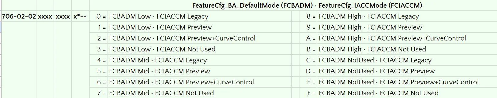

It is a 2021, but I have an F150. I don't have one of these in my household (yet). On my truck, I have newer IPMA software than what is available for you guys, and it still behaves too aggressively for my taste. Very easy 2-minute fix though:
IPMA (as built)
706-02-02
xxxx xxxx x0--
Just change that a zero, write the change and reboot the IPMA.
I know I'm crazy, but I can't seem to get the predictive assist to turn on on my '21 self-flashed IPMA. What should the default value be? I see the entries in the master spreadsheet:
Ford Mustang Mach-E The new predictive speed assist feature 1743617556238-8r
But I'm not sure what the difference is between Low, Mid, and High FCBADM.

A 2 there is what it should be so it defaults to low sensitivity when enabled. What IPMA software are you on? Did you flash it yourself with FORScan or FDRS?

That's very weird. Do you have the toggle switch in your driver assist/cruise control settings for predictive speed and if so, can you turn it on, or is it grayed out or turn off within seconds of your turning it on?
Message me the VIN and I'll poke around to see if I see anything, but if you have a 2 in that location, it should work.

I do have the toggle, and it stays on. The speed sign recognition works - with its associated flaws - but I have entered pretty steep turns at 80mph, with no sign of slowing down. I just checked, and I do have a zero in that field; just switched it to 2, but haven't had the chance to try it.

If you had a 0 there, then for sure that was the issue.
