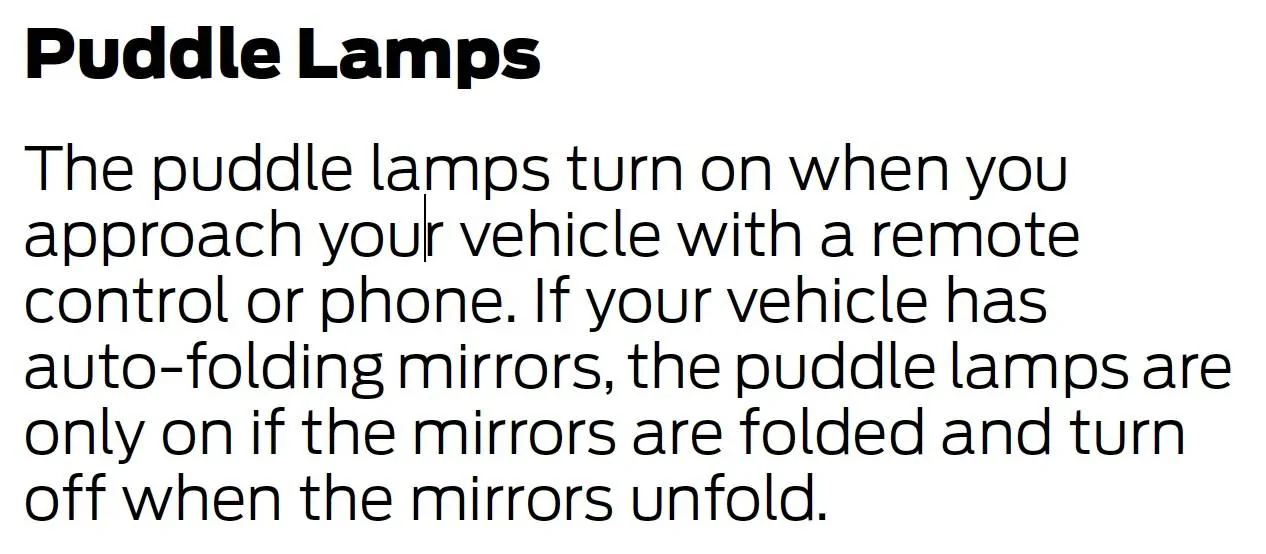

JohnFoxeSheets

it is in the manual that you must have the mirrors on auto for welcome lighting to work
Actually the manual doesn't exactly say that. Since the manual is poorly written, it isn't necessarily the case that it doesn't intend to mean what you say here, but strictly speaking that manual only says if you have auto-folding mirrors they must be closed for the puddle lights to work. (I.e., you could have the mirrors not set to auto-fold on shutoff, yet if they were folded manually, the puddle lights should still work.)
Ford Mustang Mach-E The "shutting off" software doesn't recognize closed side view mirrors when manually done! Screen Shot 2022-07-24 at 4.17.34 PM
