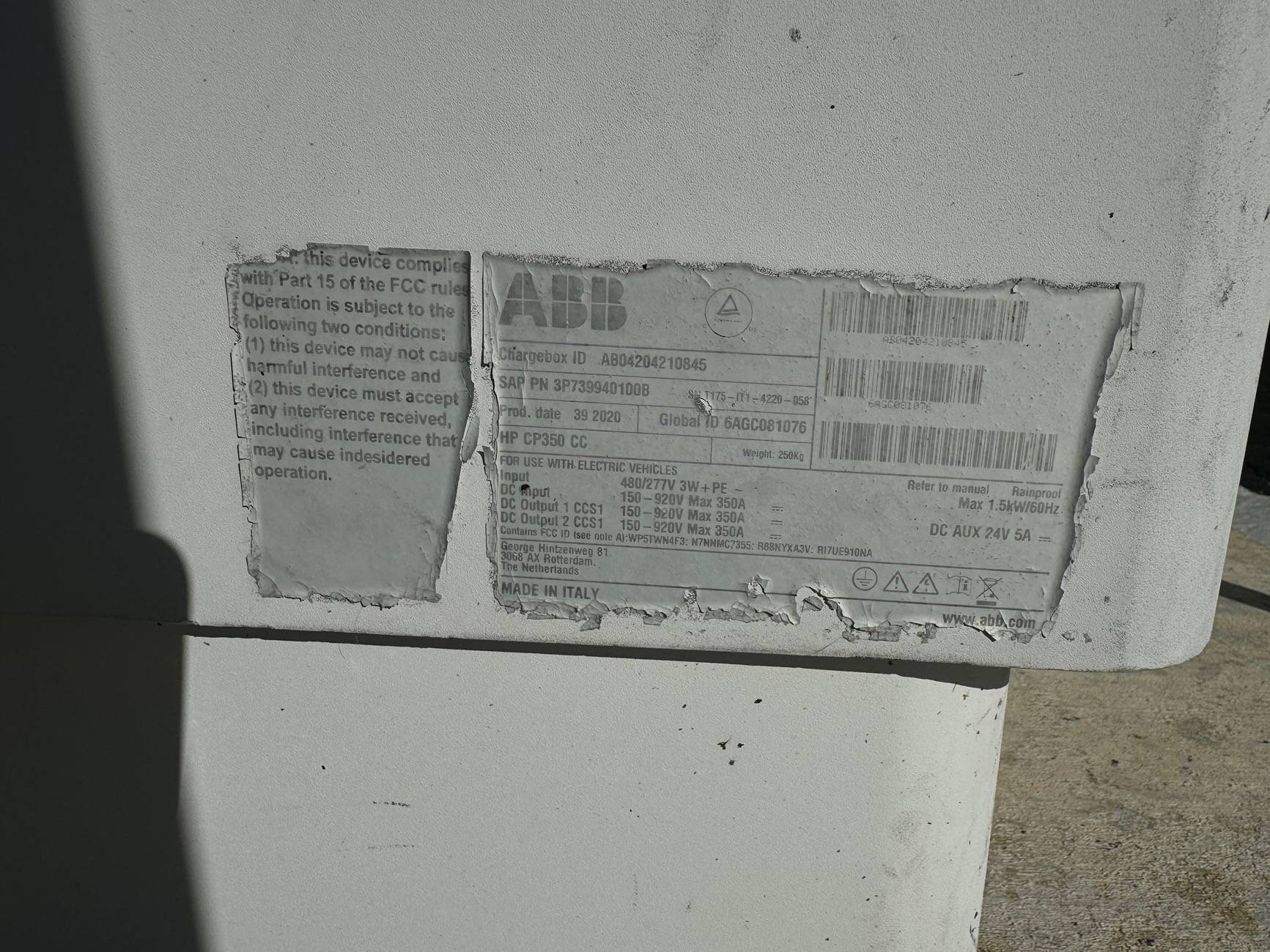

here’s the label on an older EA 350kw charger. It supposedly puts out up to 920v At up to a max of 350a. That should give 280kw under ideal conditions.

The 'up to a max of 350' is a key statement. As I understand, chargers share the main feed so if multiple chargers are being used the total capacity will be divided by the number of chargers in use, at best. Then, the input capability of a vehicle must be factored. My MME can only accept 150kW max.

Many, including myself, have seen speeds over 150kW.
