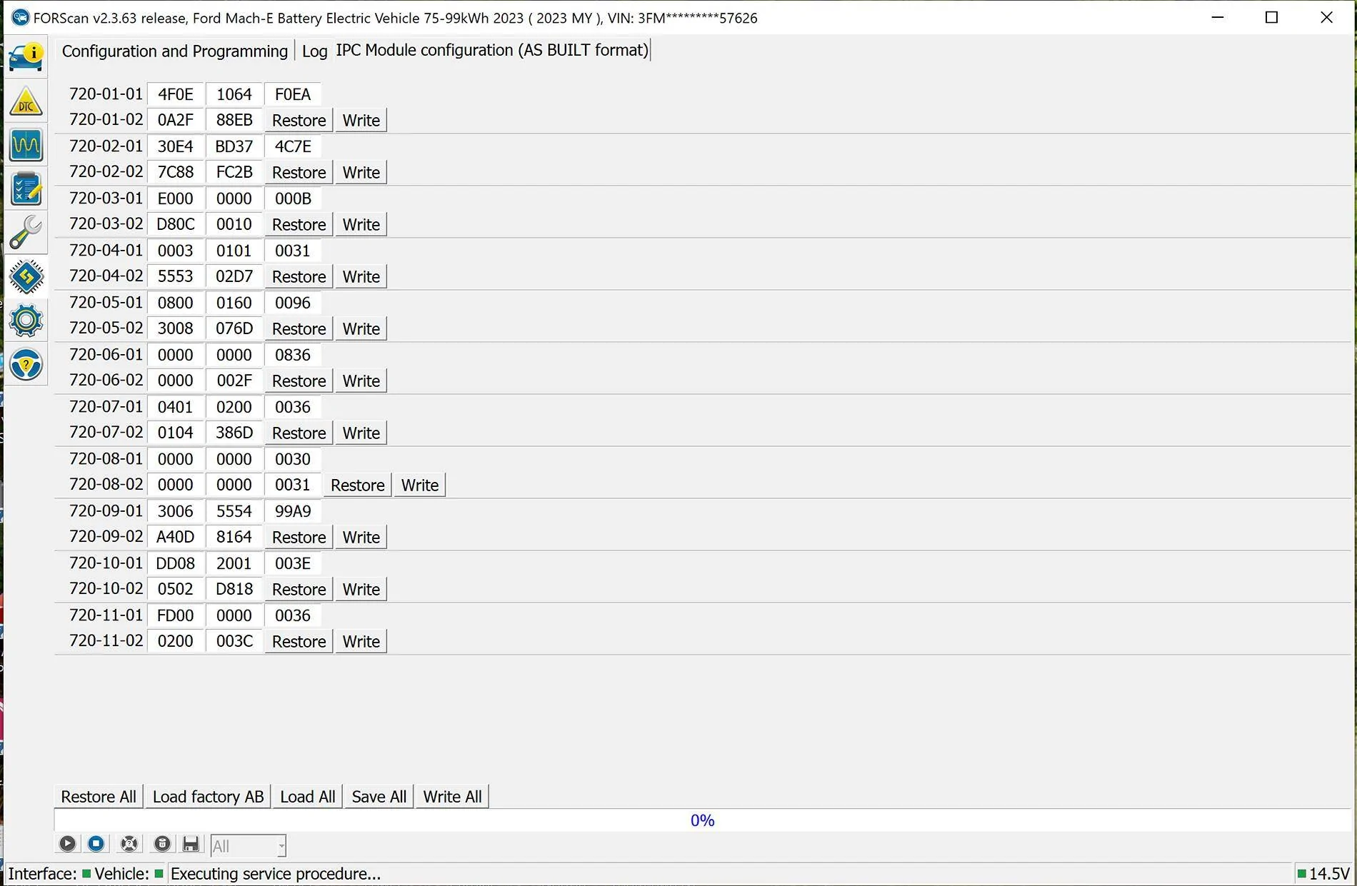

I could not get the Thunder Blue Lightning Bolt to work. I tried twice to change 720-11-02 2nd digit x0xx to x2xx. It saved correctly but didn't work after I turned off accessory mode, (engine was off) waited a short bit then back on. I changed it back to x0xx, turned off accessory mode again. then back on again, changed it back to x2xx, same result. I also tried rebooting IPC the module, same result. Here's screenshot: what did I do wrong? Compass was still there ...
I did get the Beosonic Equalizer to work though, so not a totally wasted session :)

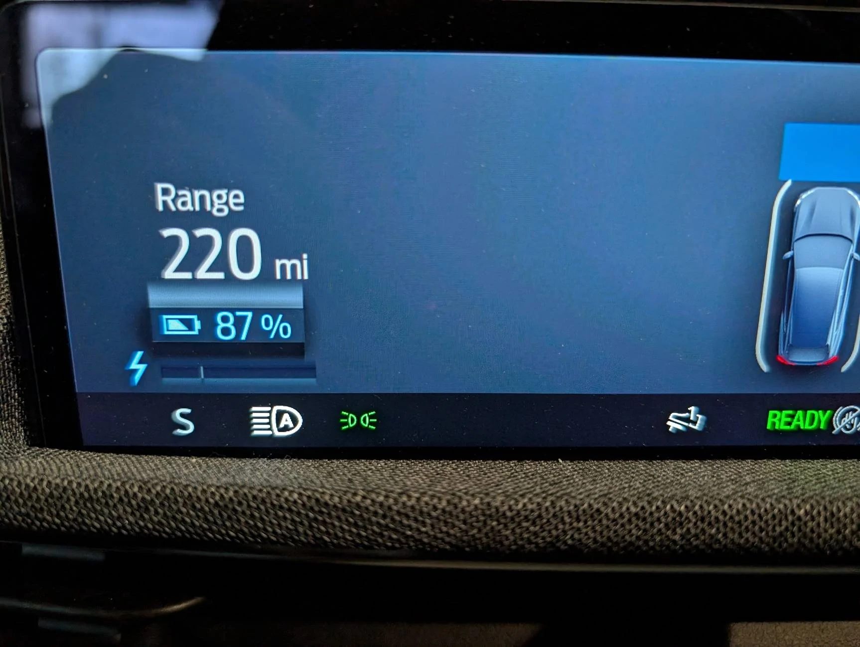

Oops, never mind. I hadn't driven the car after the settings change, but I did this morning and there it was. I was fooled by the compass moving down to the left of the headlamp indicator.
