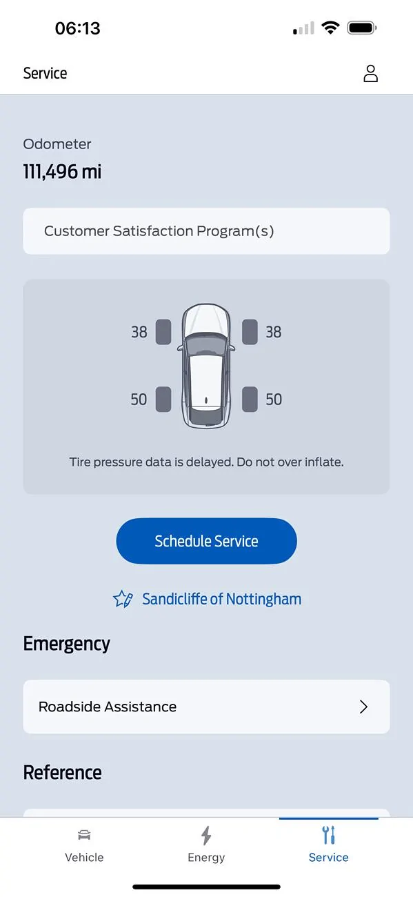

I often find I’m running at around 40/52 f/r when out & about on long runs having set pressures to 37/49 as I’m nearly always fully loaded.
Attached are overnight pressures.
I don’t experience this hard ride I hear people complain about even with my higher pressures.

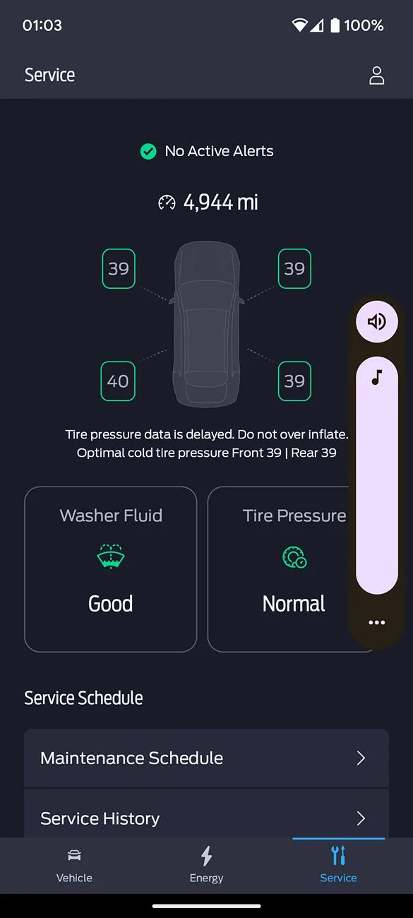

I find my TPMS to be very accurate. I don't fill the tires based on it though because as it says, it isn't real time. I fill based on a gauge and then check after all the tires are inflated.
Of course, the tires don't tend to cooperate with this over time. For instance, the one below at 40 PSI (which was filled to 39 PSI at the same time as the others, and the TPMS said so too at the time).

There’s a bit of rounding going on there, I suspect.
