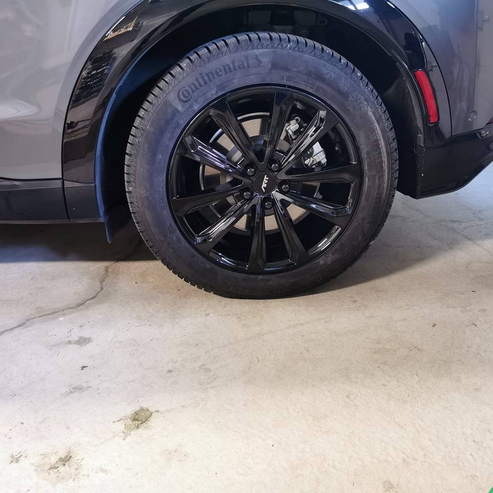

In anticipation of rought canadian winter, I just changed my tires and wheels on my Premium MachE ER for 18 inch.
I bought 4 TMPS (BH SENS UVS3041) on amazon.com because it' s supposedly compatible with the vehicle.
The mechanic installed my set of mags + tires + tmps and he told me that he was not able to program the tmps with his machines. he said that the tmps did not respond.
When I got behind the wheel of my vehicle, I notice that I have no warning about the tpms.
There is even the tire pressure displayed on the tmps page and even in fordpass there is no no error .
Do you think that the vehicle automatically recognized the new tpms without programming?
so i don't need to buy a set of new tmps?
(my interface is in french :) )
