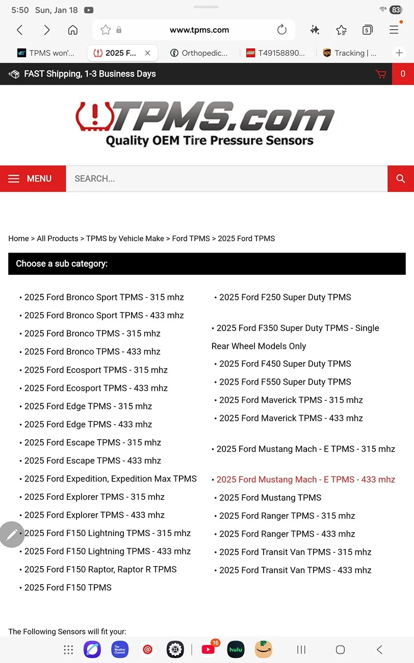

If you follow the tpms.com link above and look up the 2025 Mach E, it actually has listing for both the 315 and 433mhz sensors.
Ford Mustang Mach-E TPMS won't learn sensors Screenshot_20260118_175053_Samsung Internet
