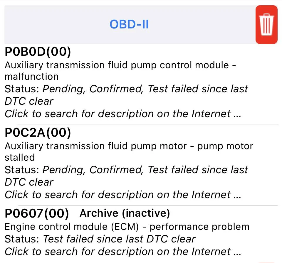

DMO
Dean
Aug 8, 2022
02184
2021 MME GT
I am having the same issue, within 2k of 60,000 miles. Hope they can confirm and get it fixed, the speed limitation has been intermittent so hope the dealer sees the same thing I do.

Nolanbro
Nolan
Jan 17, 2024
174
129
Buffalo, NY
2024 VW ID.4 Pro S
Mechanical Engineering Student
Interesting. What is that last code for? I don't remember seeing that on mine. Also are you getting a warning light on the dash? I am.
