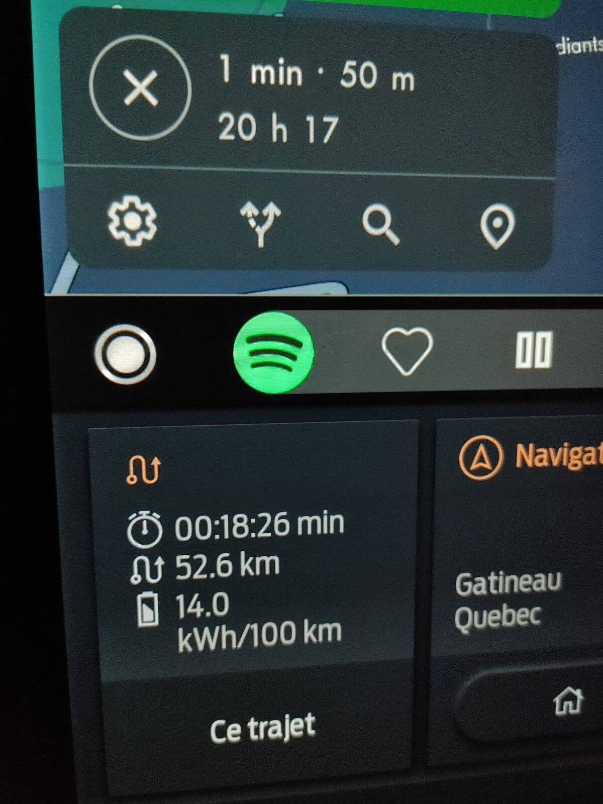

So not sure if this is more generalized but I have been noticing that my odometer is going up faster than I anticipated, based on my previous cars usage. I told myself it might just be because we love driving the MME and that since it's cheaper than buying gas, we've been using it more than the F150.
But then yesterday on a Quebec MME Facebook page someone posted something in that regard, and last night I got this
Ford Mustang Mach-E Trip Distance Error (Odometer as well?) 20211005_201735_HDR
52.6km driven in 18minutes.... that would mean I drove at about 170km/h (while only using 14.0kWh/100km wow that's amazing). No but seriously, that trip was only 16km, why did the trip display 52.6km!!!
I will keep an eye on the trip calculator and the odometer to see if this happens often and if when the trip is inaccurate my odometer also displays an inaccurate addition of km!!! Wouldn't want to hit end of warranty quicker because the odometer adds kms too quickly! As well as repercussions on car insurance etc...

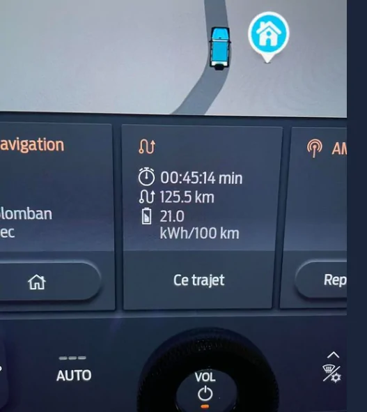

And here's what the other individual reported on Facebook
Ford Mustang Mach-E Trip Distance Error (Odometer as well?) 1633521192822
In her case, that distance and time implies she was driving at about 165km/h
Anyone else noticed something similar?

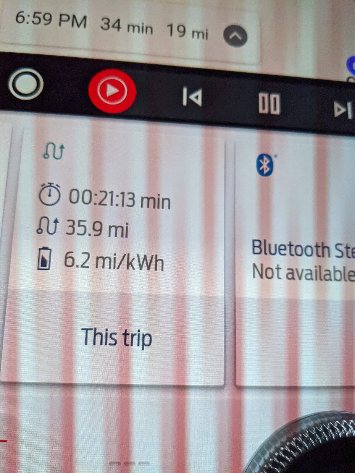

The “This Trip” odometer randomly doesn’t reset mileage. There are days when I drive to and from work and get the expected 10.4-10.5 miles on the trip odometer for each leg. There are also days when I get the expected number of miles for the trip to work but get home with 21 miles on the “This Trip” readout. It’s not a matter of time, since 9 or so hours elapse between the time I arrive at work and the time I leave work for each of these event pairs. ??

There's no way I've driven as far as my odometer is saying I have in a year and I notice my trip meter often is WRONG. For instance my commute to work is about 24 miles. Somedays my trip home is counted as 48. This has happened on longer drives as well. I've never driven this many miles in a year and especially without taking road trips. I'm about ready to sit down with a calculator and count my mileage by hand.

The This Trip meter is supposed to reset to a new trip if the car is off for a certain period of time. There was/is a bug where it would not reset automatically. So, if your trip meter didn't reset from the 24 miles going to work, then the additional 24 miles in your return trip would be added and displayed as 48.
I saw this periodically in the past, but I think one of the OTAs fixed it for me several months ago.
