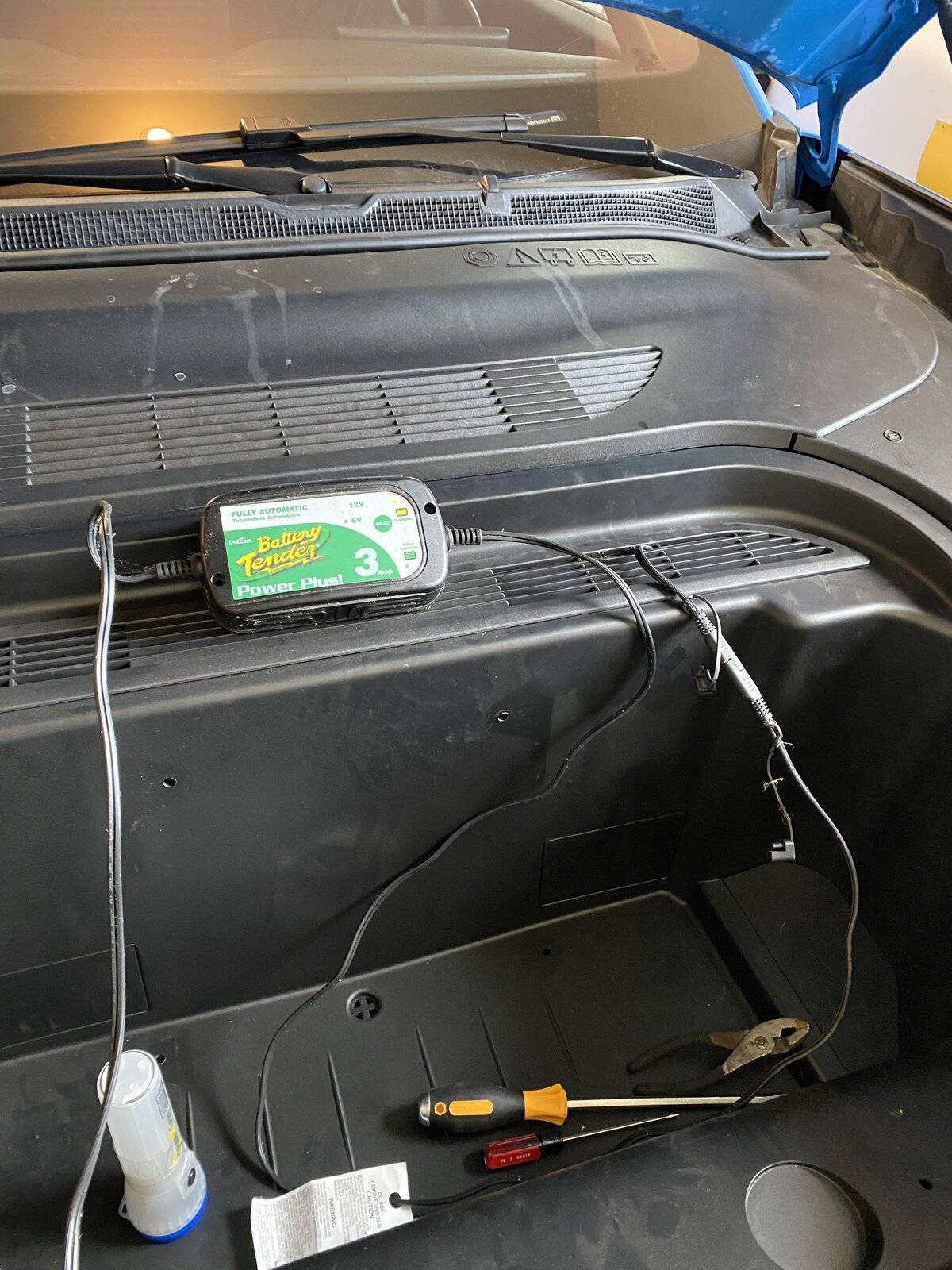

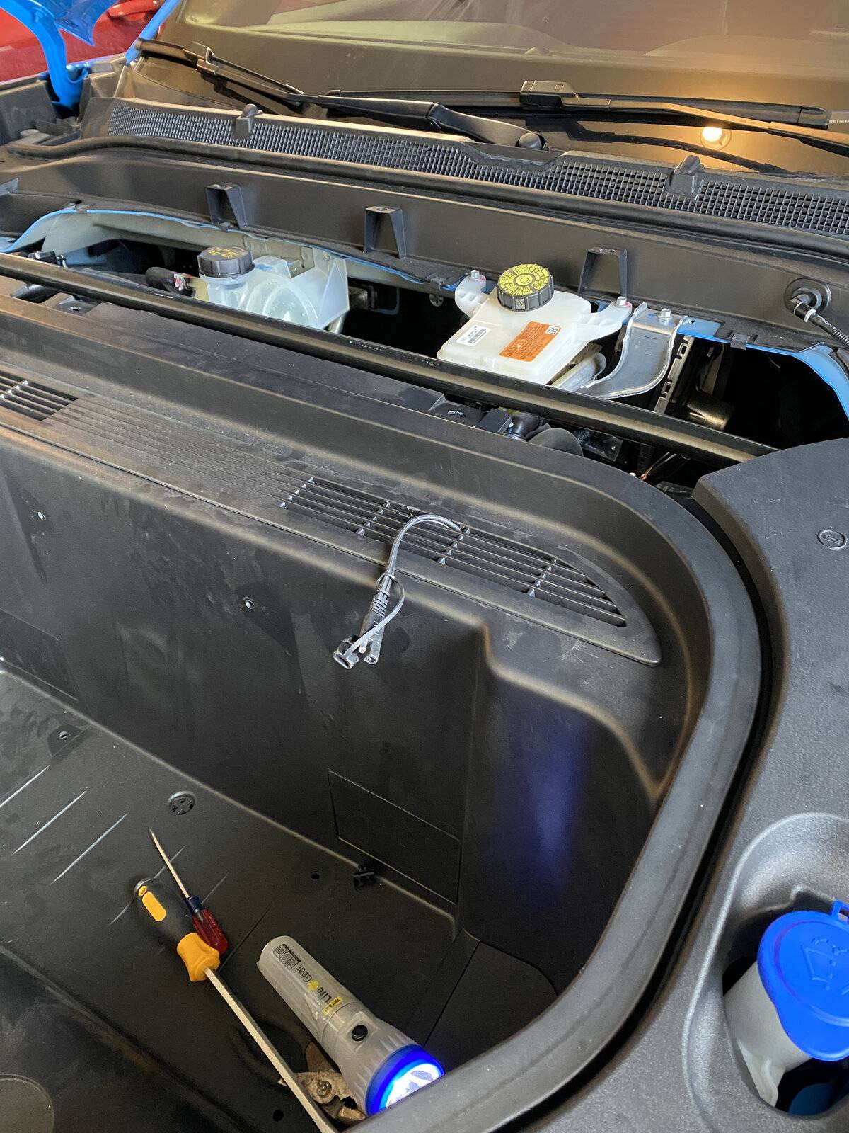

I’m calling the local dealerships tomorrow to see which one is best positioned to provide updated software.
I had to remove 2 panels from the frunk (top and driver’s side)
Incidentally, for those having significant trouble closing the frunk, I note that the 2 posts against which the frunk closes are height adjustable, and might be a couple of turns too high...
Where are these posts? I haven't really paid attention that much.
