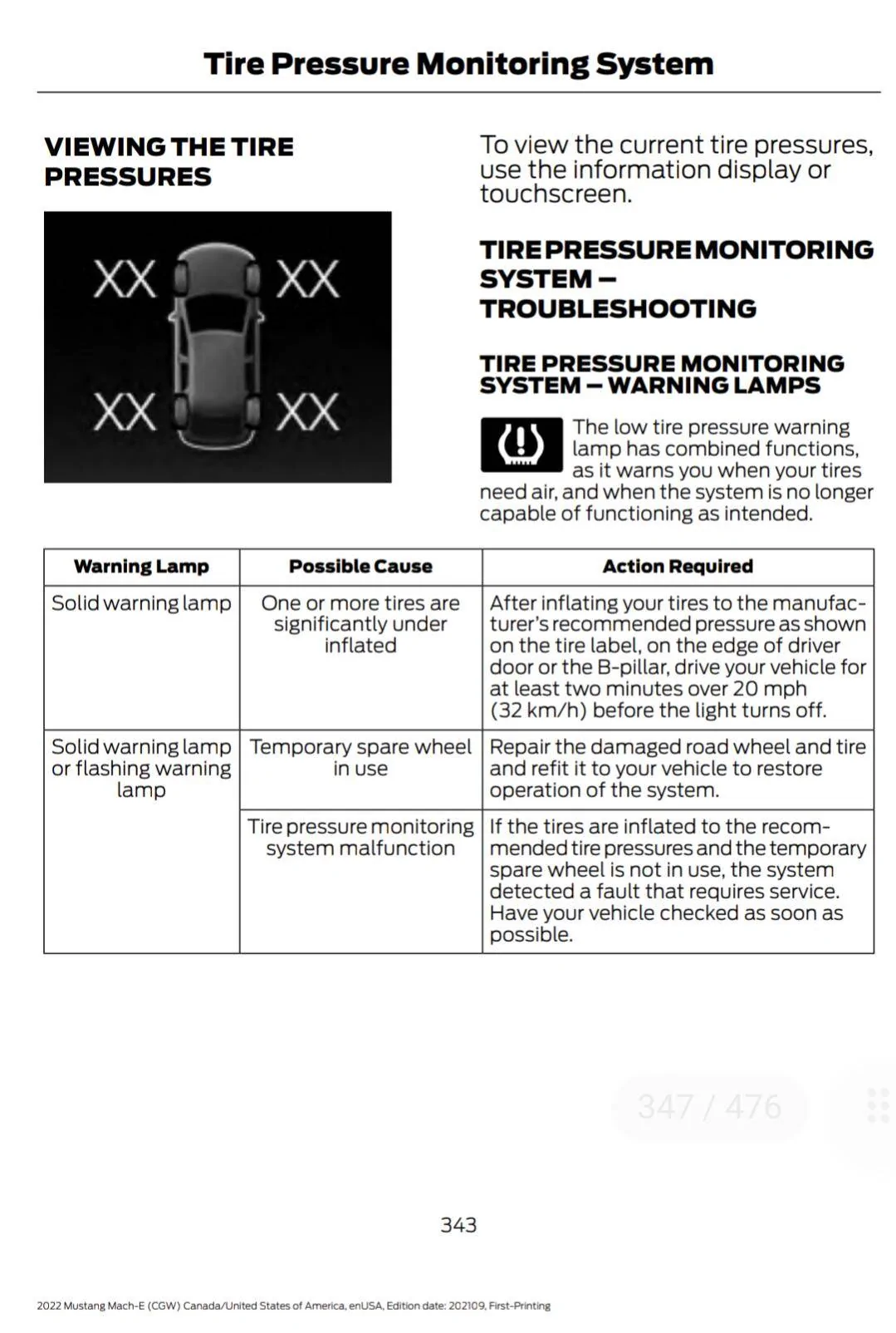

You don't specify if you've followed the procedure outlined in the manual.
Ford Mustang Mach-E Tyre pressure low indicator not going off. Screenshot_20230401-105553
267
17,939
27,947
Drive the car at least 20 miles. If it still shows a warning, or incorrect pressure, see the dealer.
