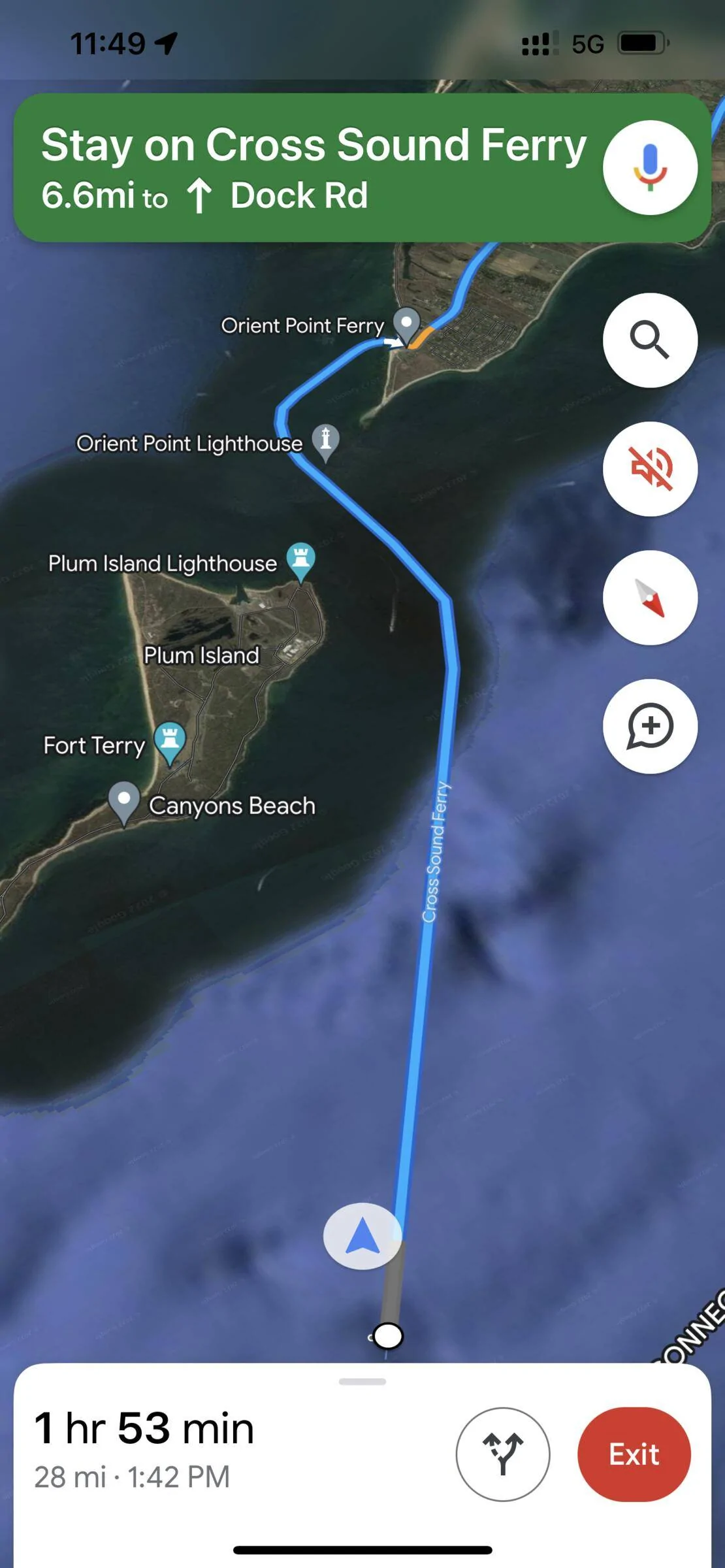

I went on 3 separate ferries about a week ago and my alarm didn’t go off once. I left the car on and got out with the key, it locked and I didn’t have any issues. Granted, the second and third ferry I stayed in it with the car on because they were very short but the first was about a 2hr boat ride. I didn’t read thru the whole thread to see if you already tried that .. but hopefully it helps!
