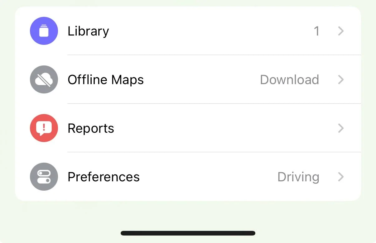

I’ve been unable to add my mach e to Apple Maps since I bought the car about a year ago. I’m hoping someone can help. No matter what I do, I can’t get the “vehicles” option to show up within the Apple Maps menu after selecting my profile picture in the Ape Maps app. I had an issue where Ford sync techs had to reset PAAK on the server side for the app to prompt PAAK setup. I’m wondering if this is another server side error. I do receive distance and turn notifications in the gauge cluster screen when using Apple Maps, just no EV charge options or battery SoC estimates.

Looks like Apple Maps is not recognizing that you are driving an EV. On my screen, I see “vehicles” between “reports” and “preferences”.
