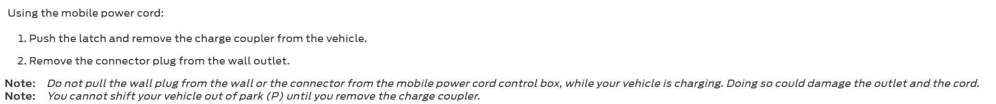

That's incorrect.Thank you for the tip.
Also, there’s no “AC charging”.They’re both DC charging (at home and at a station). The difference is the amperage. That little brick of a charger we have in our garage likely has a rectifier circuitry in it.
The difference between AC charging and DC charging is the location where the AC power gets converted; inside or outside the car. Unlike AC chargers, a DC charger has the converter inside the charger itself. That means it can feed DC power directly to the car's battery and doesn't need the onboard charger to convert it. From home you are feeding AC power into the vehicle which then converts it to DC. This is also why home EVSEs (Electric Vehicle Supply Equipment) aren't really called chargers. The AC/DC charger is actually in the car.
The button on the charger port does absolutely nothing, zero, zilch, nada to AC (L1 or L2) charging. Try it. Go push it when charging and you'll see nothing happens.
For DCFC, you can safely stop a charge by app, at the cabinet, via the car UI, using the button on the handle or using the charge port button. Yes there was bad software that caused a charge port fault, but that was addressed a long time ago. You don't "need" to use the button. In fact, I think Ford is the only company that has a button at the charge port. Use whatever method you like just be sure to wait for the lock to completely disengage from the vehicle before yanking on it.
