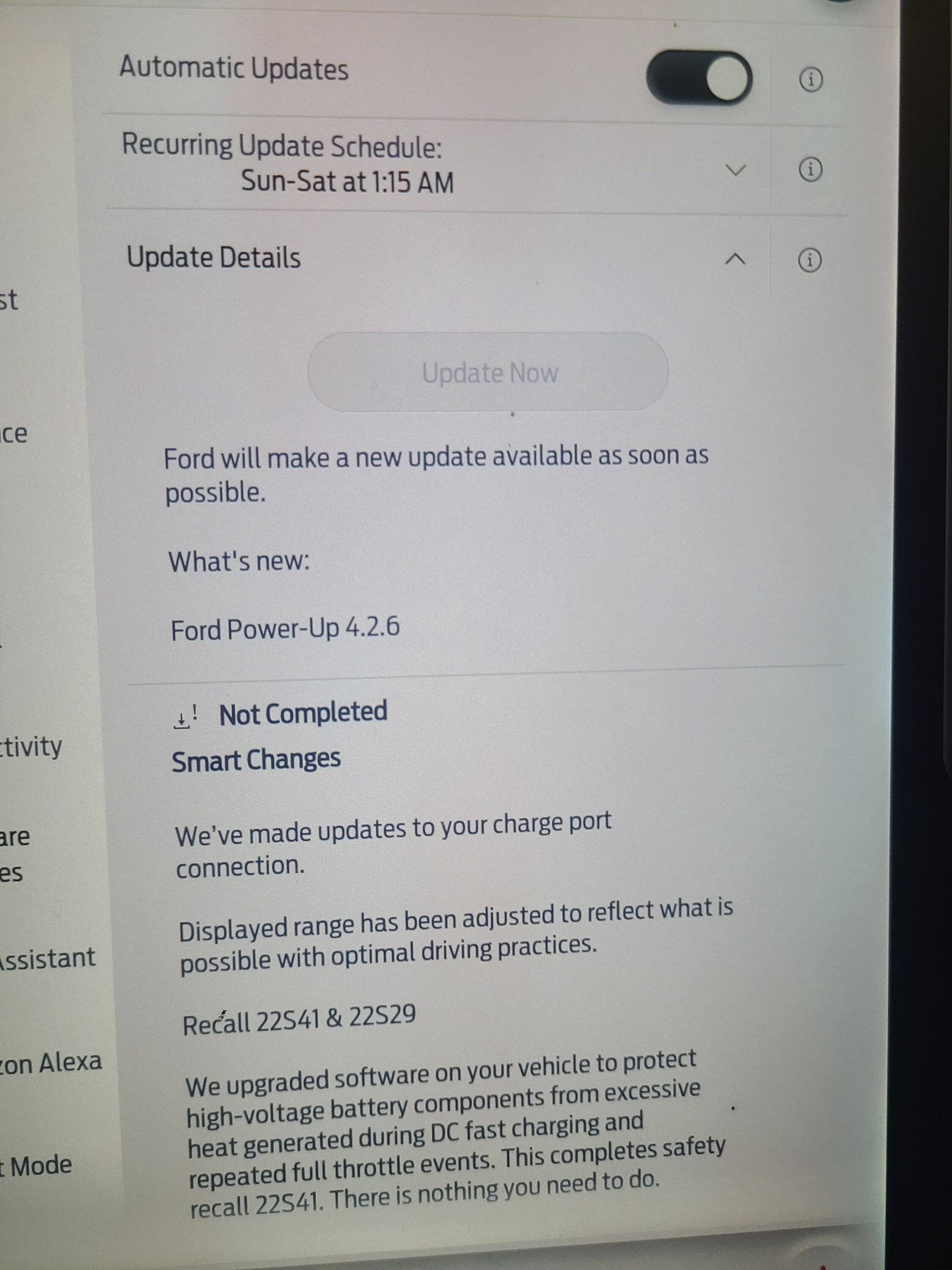

My car was stuck on a 4.2.6 that was not uploaded.

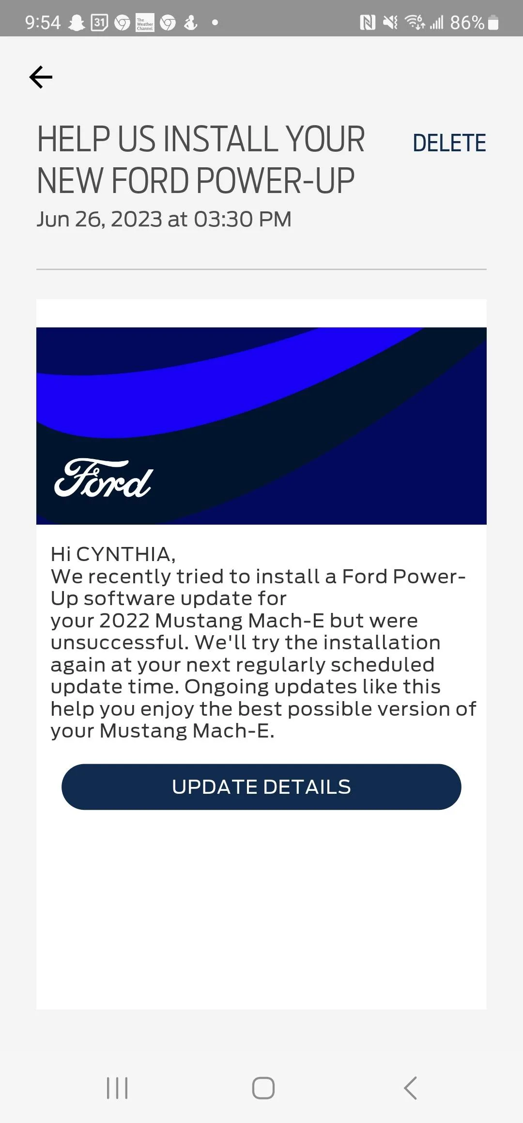

Tried the update again with the light switch off. Stood outside the car and watched. Could hear the car accepting part of the update and the clicks and light activations. then it stopped and i got another app error message.
