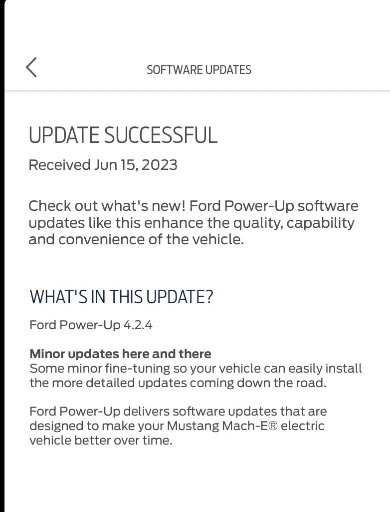

Hello, just picked up my GTPE two weeks ago and I’ve received several updates since starting with 4.2.1. The latest today is 4.2.4 which I believe was suppose to be the voice feedback update but my notes just say it’s an update to make future updates possible. I already had all of the latest features when I took delivery, including the camera button, voice feedback etc. Does anyone know why Ford can’t just push the latest update to my car instead of pushing these older versions? I guess the latest version is 4.2.6?
Ford Mustang Mach-E 4.2.6 update keeps failing IMG_0389
