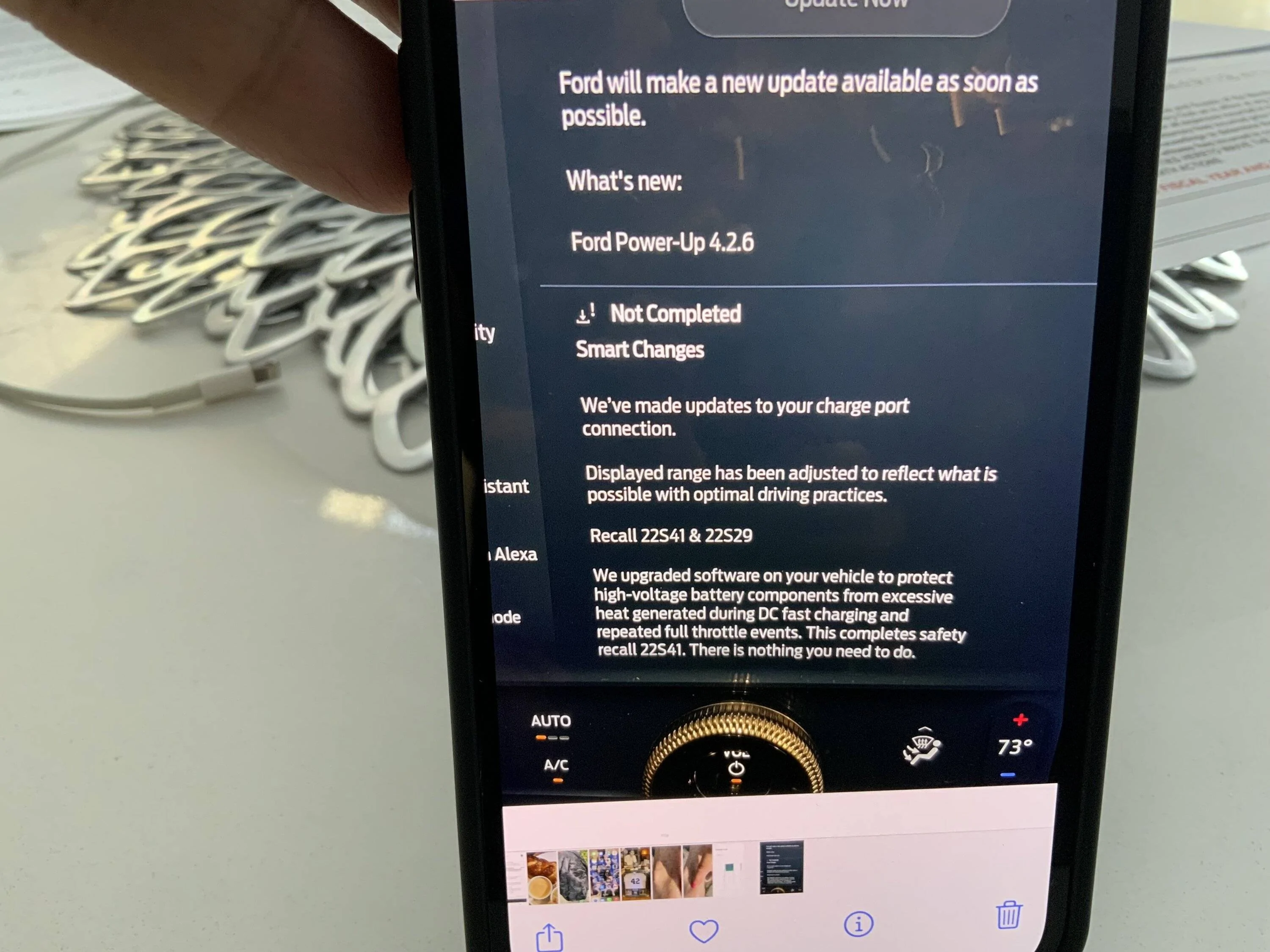

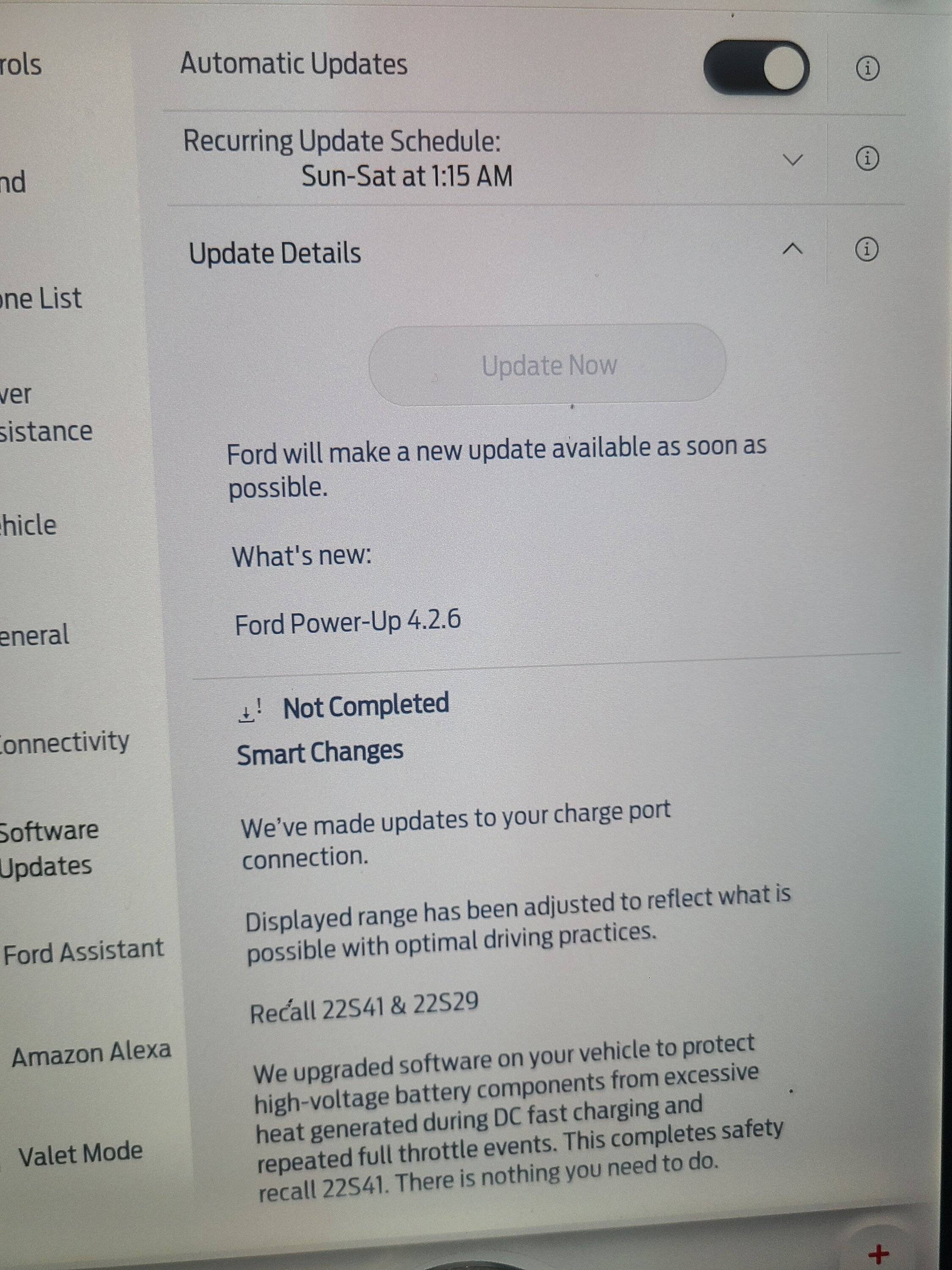

12v 99%, parking brake set, lighs off. Used update now plugged in, unplugged, let it sit over night, short drive, long drive, inside,outside, same error. Tried every trick i read even tried rubbing my belly while jumping on one foot 3x while turning in circle, read sometimes that works.
What bothers me most dealer says nothing is wrong and cant reproduce the error. But looking on screen under updates seems to reproduce the problem . Or at least i thought update failing reproduced the problem. Especialy after having car 3 weeks. Not sure how else to "reproduce the problem" they did get it to move on the screen not sen error everyday. But ford pass still has error message and update screen seems to indicate not complete. I just assumed not completed meant not completed.

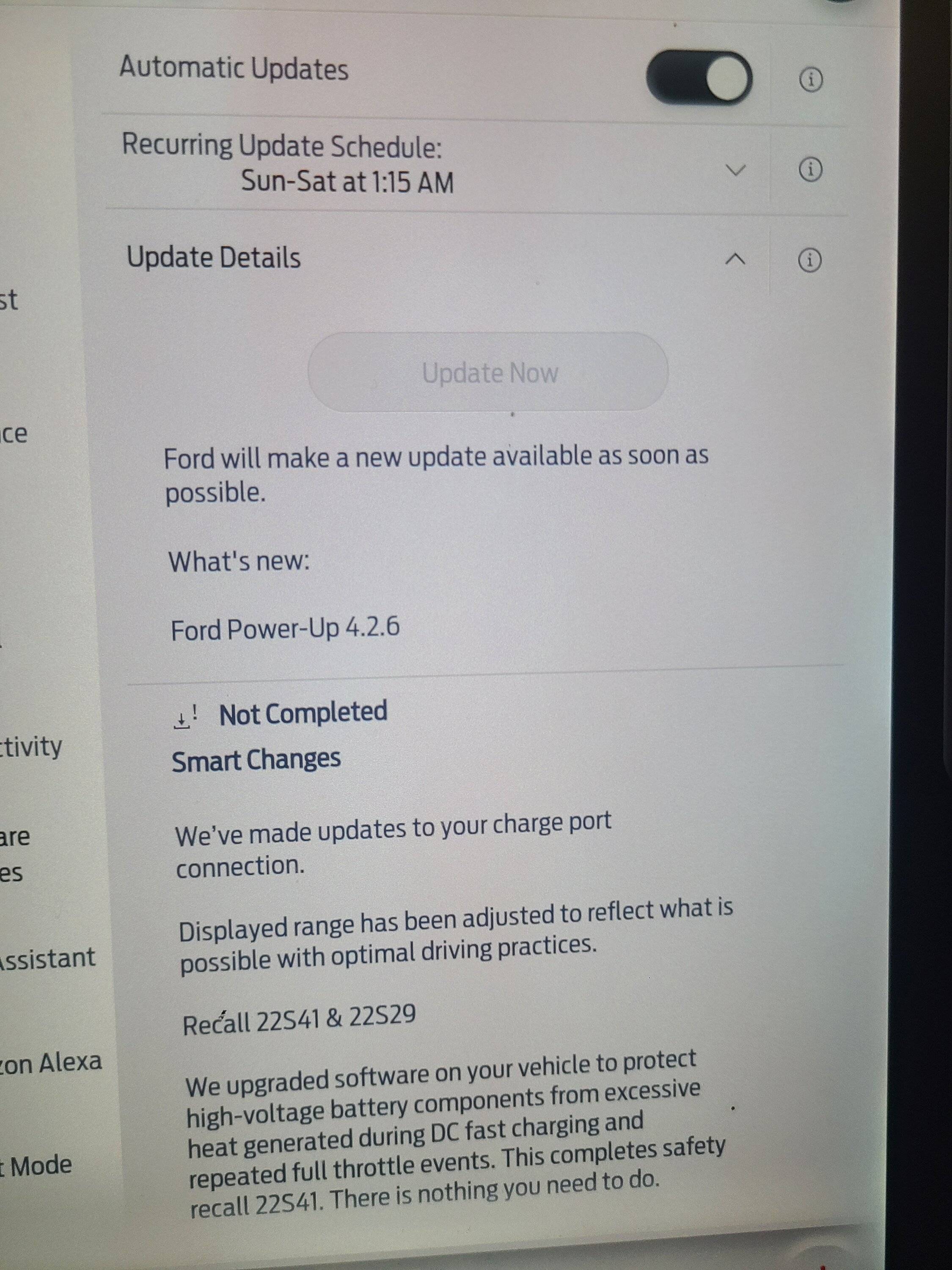

my car says in sync that it didnt complete but I never received any notices. Drove the car for 4 non continuous hours last week and charged for many hours to 100% the night before and no difference. I see many people have this also but since I haven’t received any updates since 6/6 thought it might be holding up future updates
still shows the following, see picture attached.
As I mentioned bringing in the car for service Monday , probably won’t do any good and if I didn’t have the yo-yo charging , 40 amp down to 32 and back to 40 I wouldn’t even bother bringing it in But I am heading on a trip to cape cod and figured better they look at it before I leave.
any words of wisdom would be welcome.
