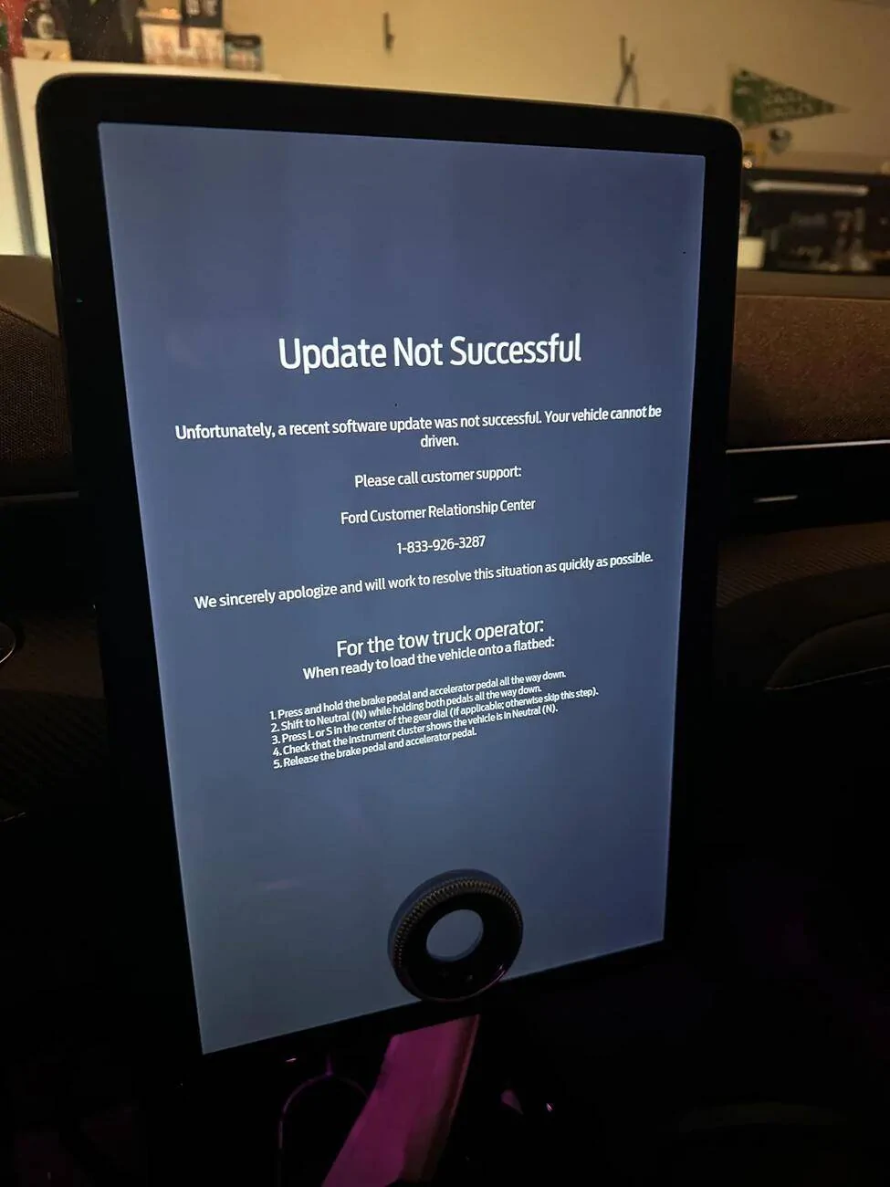

2023 GT. According to my app the last successful update 6.14.0
Strange thing is on the Ford Pass it says vehicle in good health and all updates installed. Then when you get in car it starts to load and then screen message comes on to Tow car to dealer.

Does that tow screen still look like this or did they update it?

Update. So far the dealership has been very attentive and are sending a mobile unit to house tomorrow to fix the issue. Will post how it goes, keeping fingers crossed.

Final Update.
dealer sent mobile unit to house on Tuesday. Got the car started by having car software go back to prior to failed software. They drove car to dealer and successfully uploaded the software. Today Thursday I got the car back.
glad to have Mach Elroy back.
Great attention from Ford and my dealer.
