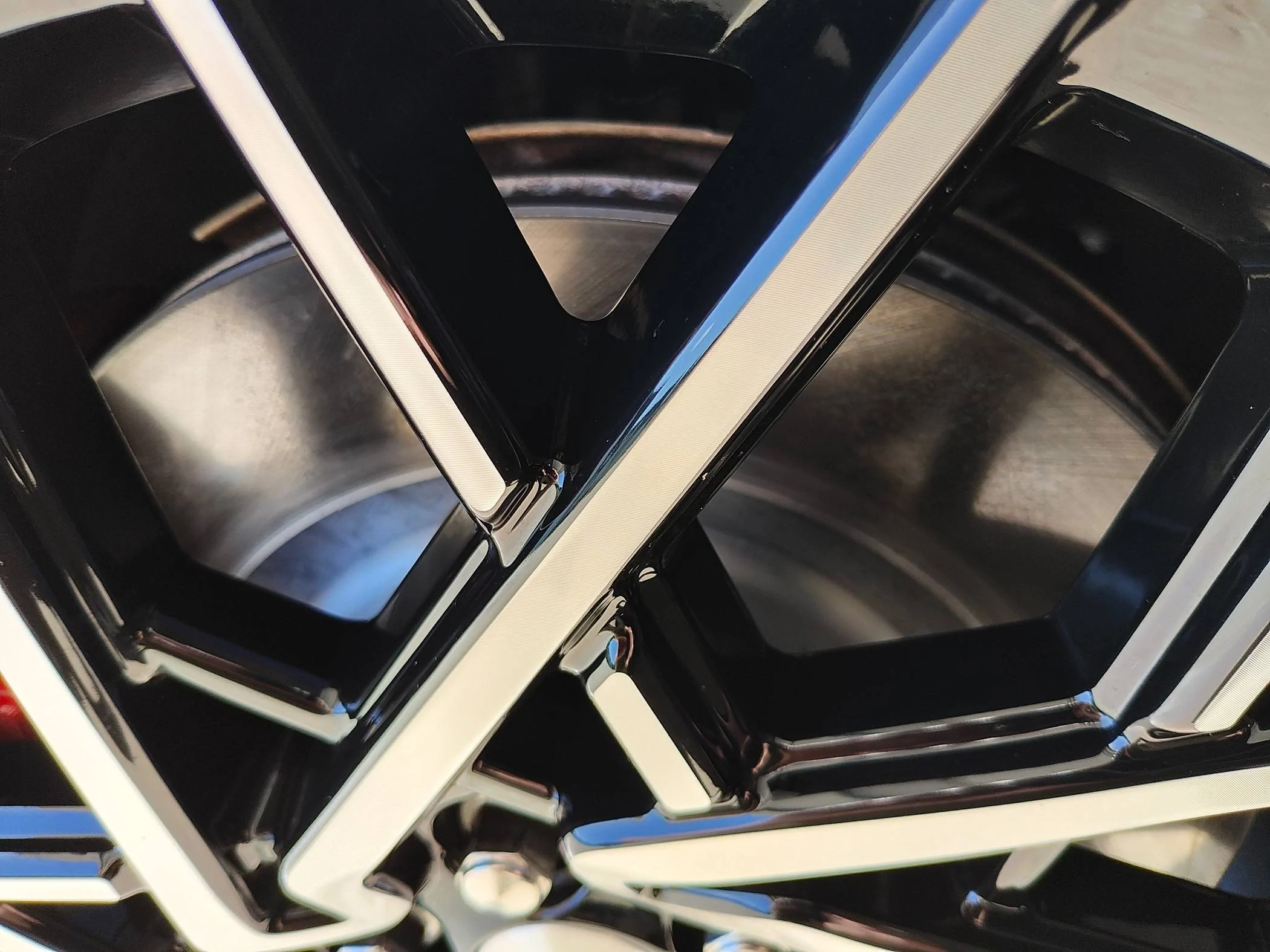

Approximate price?
Total with GA Tax $228.80 and after washing the car twice the rotors do not rust! Great improvement.

I would double-check those parts. The GT and GTPE have different size rotors.
The only rotor I have seen besides the motorcraft part is Raybestos Element 3. Hopefully, those DF are correct I won't buy drilled or slotted rotors for cars that did not come that way stock. When you reduce the friction area you reduce the stopping power.
For GTPE
https://www.raybestos.com/disc-brake-rotor-682859fzn.html
For GT, Select, Premium, & CR1
https://www.raybestos.com/disc-brake-rotor-682744fzn.html
They went back and forth and supplied the correct rotors for the GTPE but they are not drilled just flat but work great and do not rust with the coating on them.

I ordered them from https://www.buybrakes.com/2022-ford-mustang-mach-e/brake-rotors They could not supply the Drilled and Slotted but could do the coating on plain rotors. The photos are after washing the car and no rust!. I have just over 800 miles on them. The measured exactly the same as the OEM and pads were identical even the hardware kit.
The coating will eventually be worn through, whereupon the rotors will rust again. ?‍♂?
Good to hear that you took care of the warpage problem. ??

I am hopeful it is like the treatment a Glock gets and will not rust. You can take a Glock Barrel or slide and polish it and it will still not rust. Yes the Stopping is I would say better then new.

Interesting about the coating. Looks like a pretty cool website. I’d love to hear how they hold up with rain and wear. Seems like their prices are good too.

I can't speak to the rotors he bought but I have put those raybestos element 3 coated rotors on a few of my previous vehicles. Here in Minnesota they protect from the elements for about 3/4 years depending on how many miles you drive. They are a bargain if you get them from rock auto just under $62 each rotor
