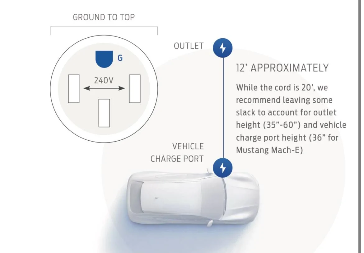

US 240V is not the same as EU or UK wall plug.
Ford Mustang Mach-E V240 vs. V120 L1 charging IMG_5420
Ford version would have to come with different pigtails.
