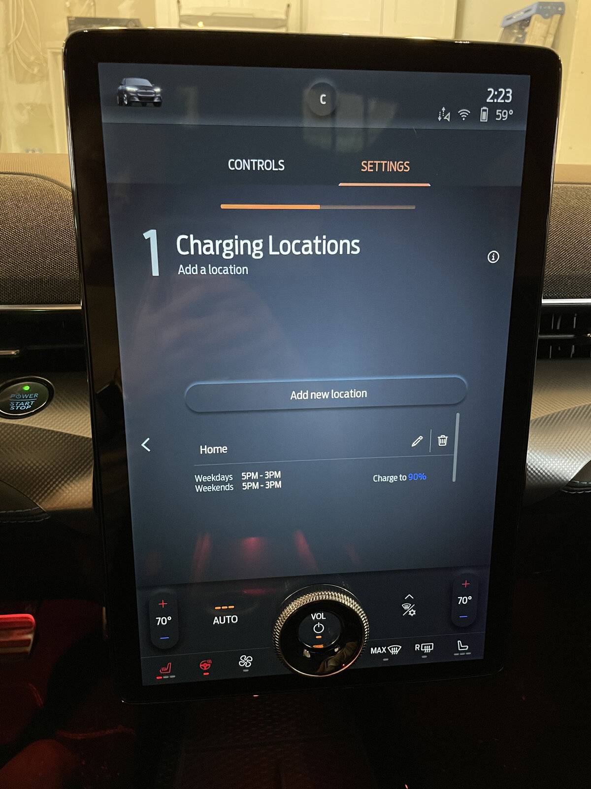

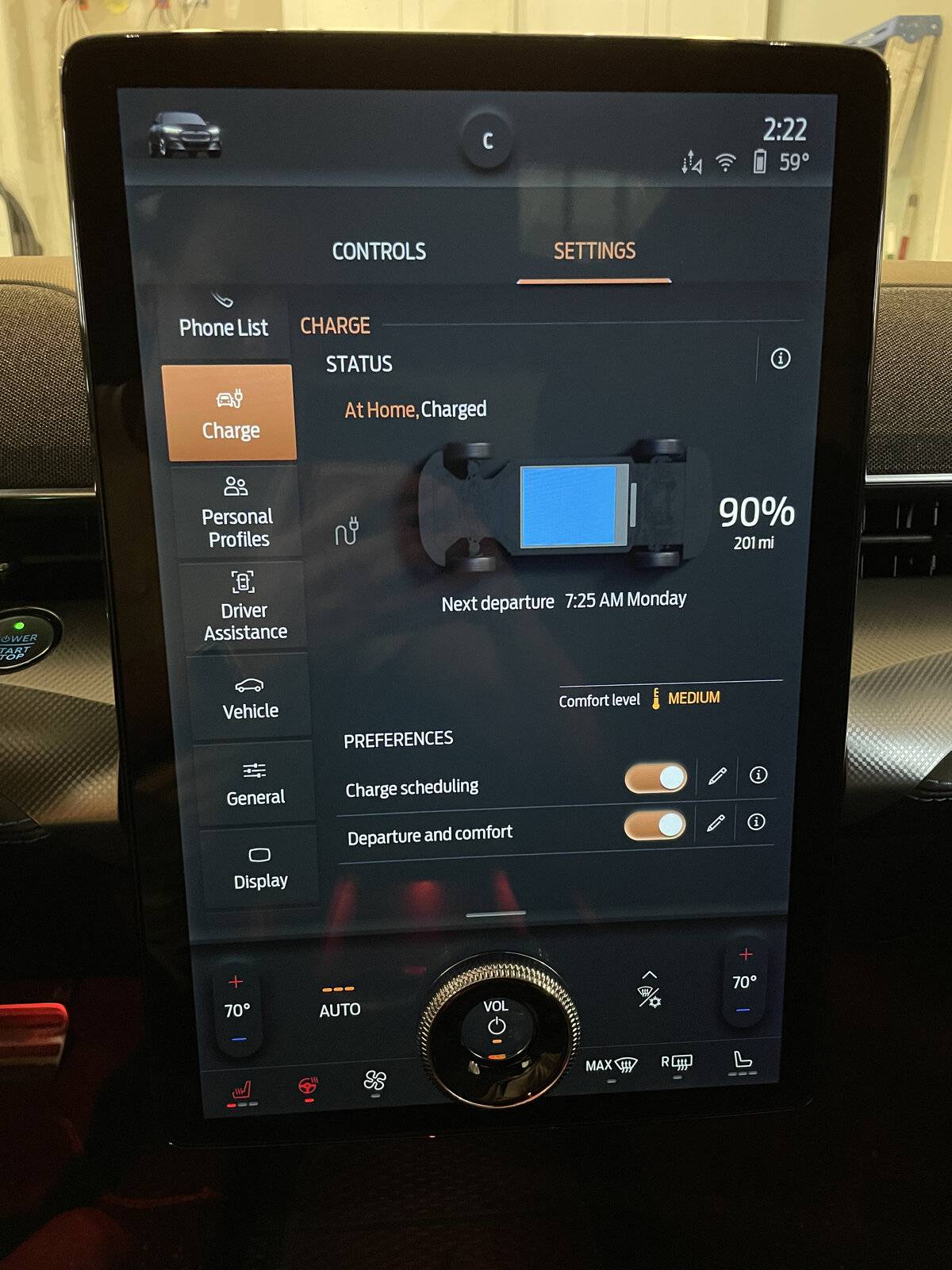

How do you name a charging station? Simple and common settings in other nav systems seem to be impossible in this SYNC4... Can anyone help? I did the setup in FordPass the week before my car arrived, but no way to push/transfer that information to the car that I could find...
To change the name, tap Vehicle Icon on top left>Settings>Charge, then tap the pencil icon next to "Charge scheduling." On the next screen, tap the pencil icon next to the location (I think it will be called Default or be blank if it's not named.) You can also turn off plug in notifications in the FordPass app if you don't want the messages. Manage EV>Notification Settings>Manage Individual Notifications
