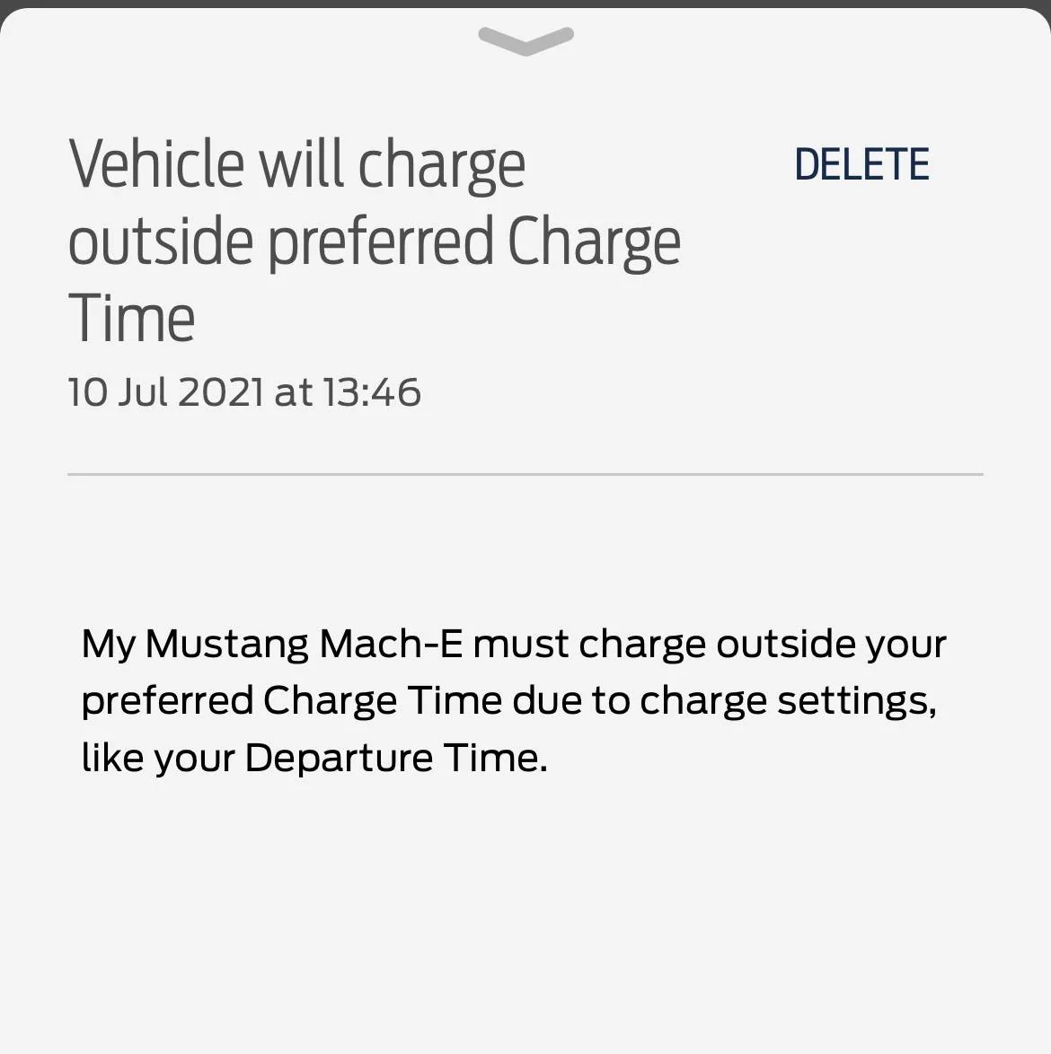

Im having a similar issue… originally it was because I had departure times set, which I’ve since learned you can not use in conjunction with a charging schedule (very annoying). So I deleted all my departure times from my settings in the car and programmed in my new charging schedule, then checked that these had synced with the FordPass app… they had. Car started charging when it should have, which was good, but then immediately threw me this message via the app… then it did the same after I returned with the car from a quick trip to the supermarket. I’m currently waiting to see if it is in fact going to stop charging when it should (in 10 minutes time) and these messages are just bugs, or if it is ignoring the schedule.
I’ve always had it set the preferred schedule as @hybrid2bev has recommended. Will let you know in 10 minutes! ??

So as I suspected, the car will not stop charging at the programmed times.
So not only can I not use departure times with a charging schedule, but the car ignores my schedule all together… It will start on time, but it won’t stop charging when it should. Very annoying. @Ford Motor Company / @Ford Team - any ideas?

I know you weren’t asking me, but I’m going to chime in too, as the OP and I have some similar issues I think.
1) An issue I have with my home charge location is that it is set to some random location 30 miles away, and you can’t correct it. It shows this in both the FordPass and the car. However both FordPass and car show the correct location for the car… it’s just the ā€œHomeā€ location that is miles away and no way of correcting it.
2) Nope, it’s turned off.
3) Set to 80%. Since learnt we can not use departure times and charge schedule concurrently, however I’ve since learnt that even with my departure times off, the car will now not stop charging when charge time window closes. It starts when it should, but doesn’t stop ??ā€ā™‚
