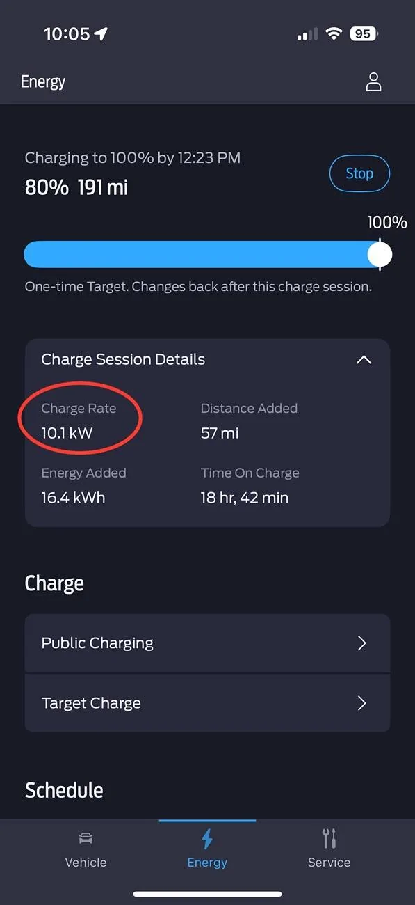

Agreed - it would hurt the car out the battery (and can actually be helpful to the 12V battery since it charges while the HVB is charging). You can check the charging speed in the FordPass app on the Energy screen.

Thanks1 I hadn't realized the app had that info. I checked and the charging speed is 1.2kW, crazy slow for a level 2.
