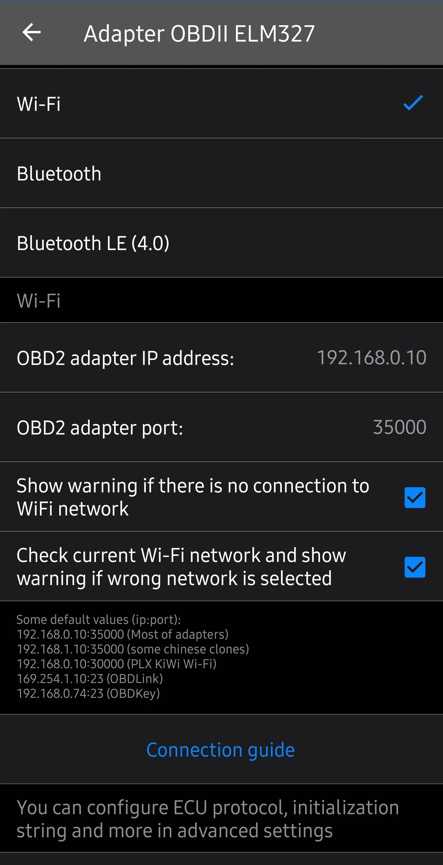

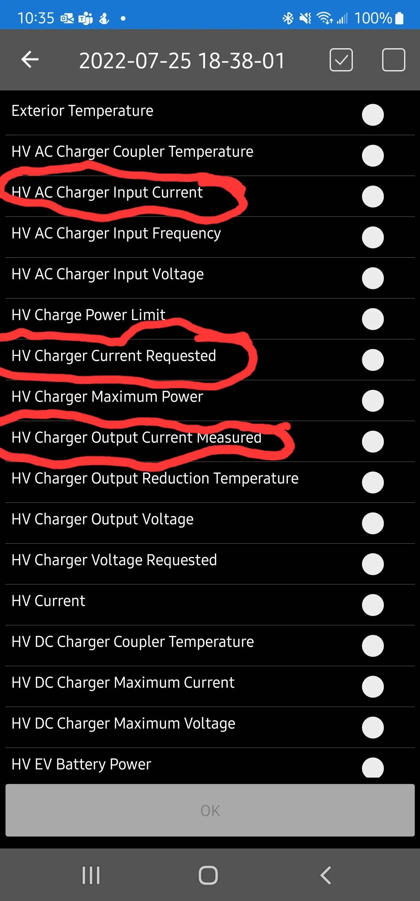

You can get it all with what I mentioned above using Carscanner, but you have to use that adapter. It's actually a good thing it's so tiny so you don't see it if you want to just leave it in the OBD2 port.

You get all kinds of stuff. I took this log sitting on a Volta L2 charger for fun. Here were some readings
HV AC VOLTAGE: ~203V
HV AC CURRENT: 39A
(implies L2 station was 7.9kW)
Now the charger inside the Mach has to convert to DC:
HV CHARGER OUTPUT VOLTAGE: ~377V
HV CHARGER OUTPUT CURRENT: ~19.5A
(implies AC->DC loss yields 7.35kW)
HV CURRENT: ~16.4A [negative]
Note that I was sitting in the car with it on, so HV battery fans running, stereo, a/c, and efficiency loss consumed 16% of that 19.5A. I'd have to test again with the car off to get any efficiency loss isolated.
Neat stuff if you want to have some fun.

Actually I just noticed you mentioned you have a OBD wifi dongle. I *think* any should work with Carscanner since it just asks for the IP and port so if you can guess right you should be money. But for sure it only supports that one Bluetooth adapter and it's cheap on Amazon.
