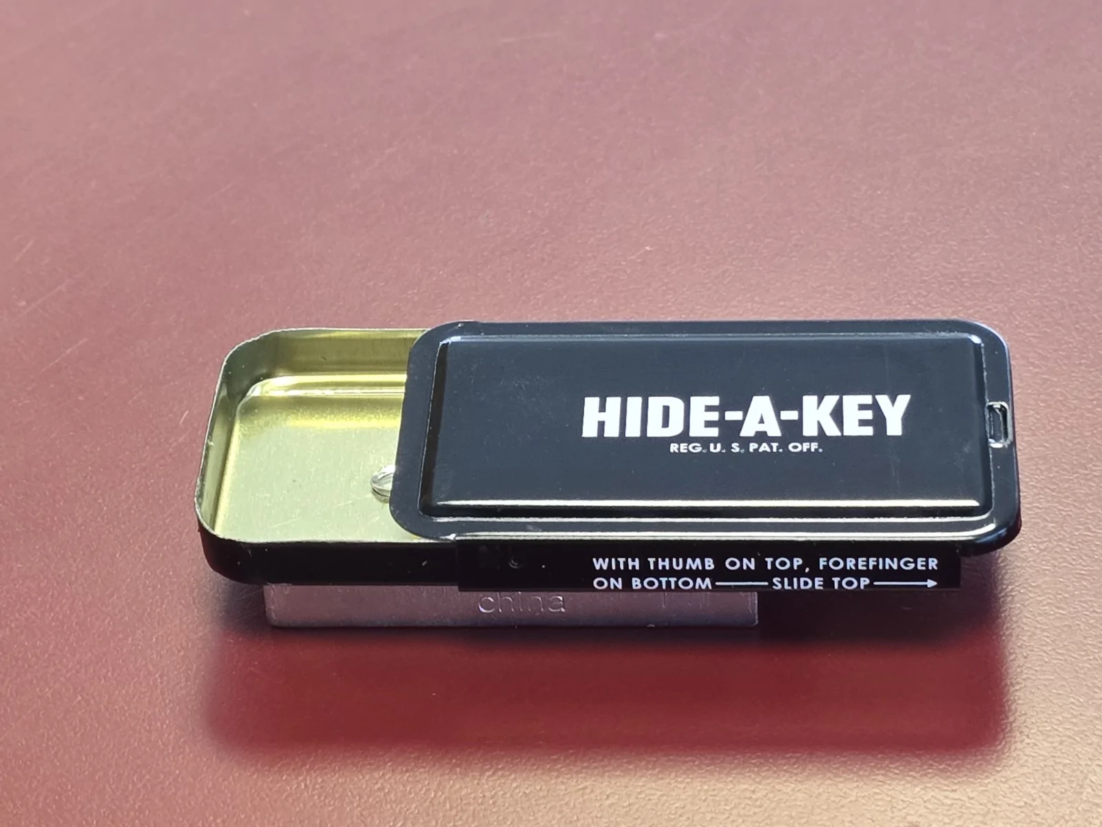

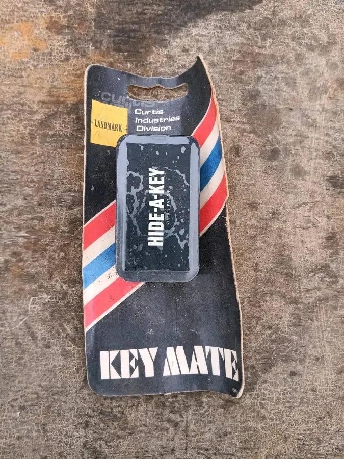

I have one in a faraday pouch, I guess I should double check that.
Modern day version of:
Ford Mustang Mach-E Walk away locking/folding mirror issue SOLVED 1778785031197-a4
Ford Mustang Mach-E Walk away locking/folding mirror issue SOLVED 1778785089903-f4
As kids, we loved borrowing our folk's cars without the need to get the keys from them...
My dad never could find a spot that I wouldn't find...😁
