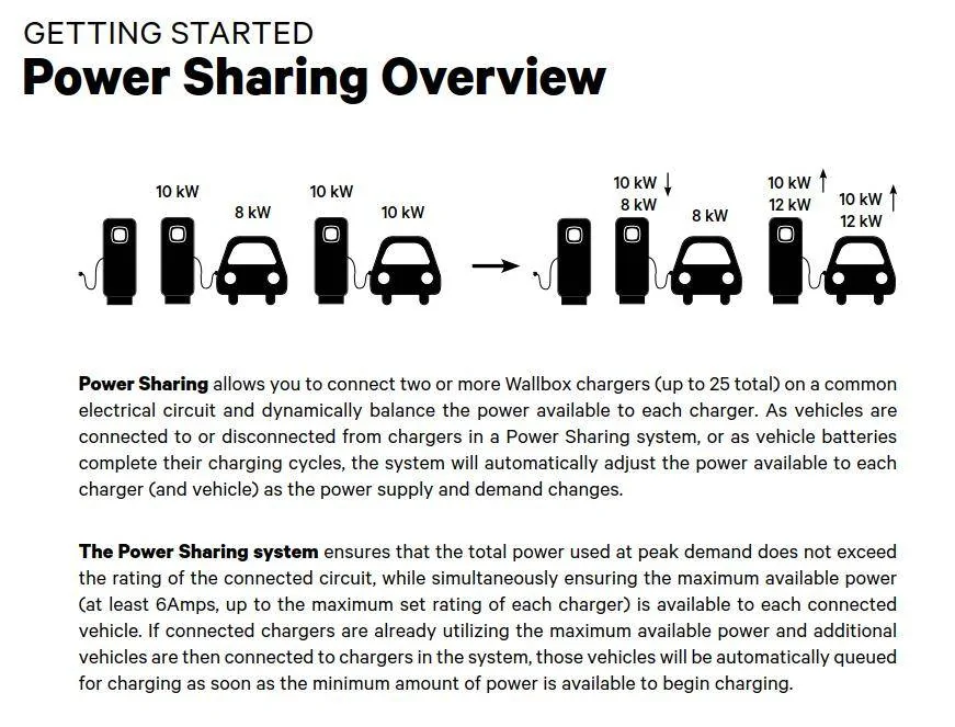

Just wanted to give a small update in regards to Power Sharing - It does seem to evenly split power to each unit, when both are requesting "full" power.
With my i3 and Mach-E both charging, they each get around 4.35kW of power from the Pulsar Pluses. As one tapers off that power is opened up to the other, so far as I can tell.

What happens when the one car finishes charging, but is still plugged in? I have two Juicebox EVSEs setup in a similar configuration and when one car finishes charging but is still plugged in, it reserves 7 amps for that car and the other car that is still charging gets the remainder.

It depends on what size circuit they are on and the power ceiling of each unit. Sounds like you installed your 'straight up' on a 50A circuit?
We recently installed three on a 70A circuit and then set one unit at 32 amps and the other two at 24A max (even though they were 48A units). This was per the customer's request. When we tested, I think we got 6.6kW from the first unit (customer's PHEV), Just under 6kW from the second unit (Mach-E) and the third machine appeared to be waiting until one of the other cars finished charging. We didn't stick around long enough to verify so I just unplugged from #2 and #3 started charging around 24A if I remember correctly (Focus Electric).
I don't know why the customer wanted the different amp settings since the machines are able to control all that themselves but we just satisfied their request and moved onto the next project. :)
So far, they have been pretty good units. I would recommend an installation location that is protected from direct sunlight and excessive heat exposure. Otherwise, no issues so far. (knock on wood....)
The wallbox units dynamically adjust.
