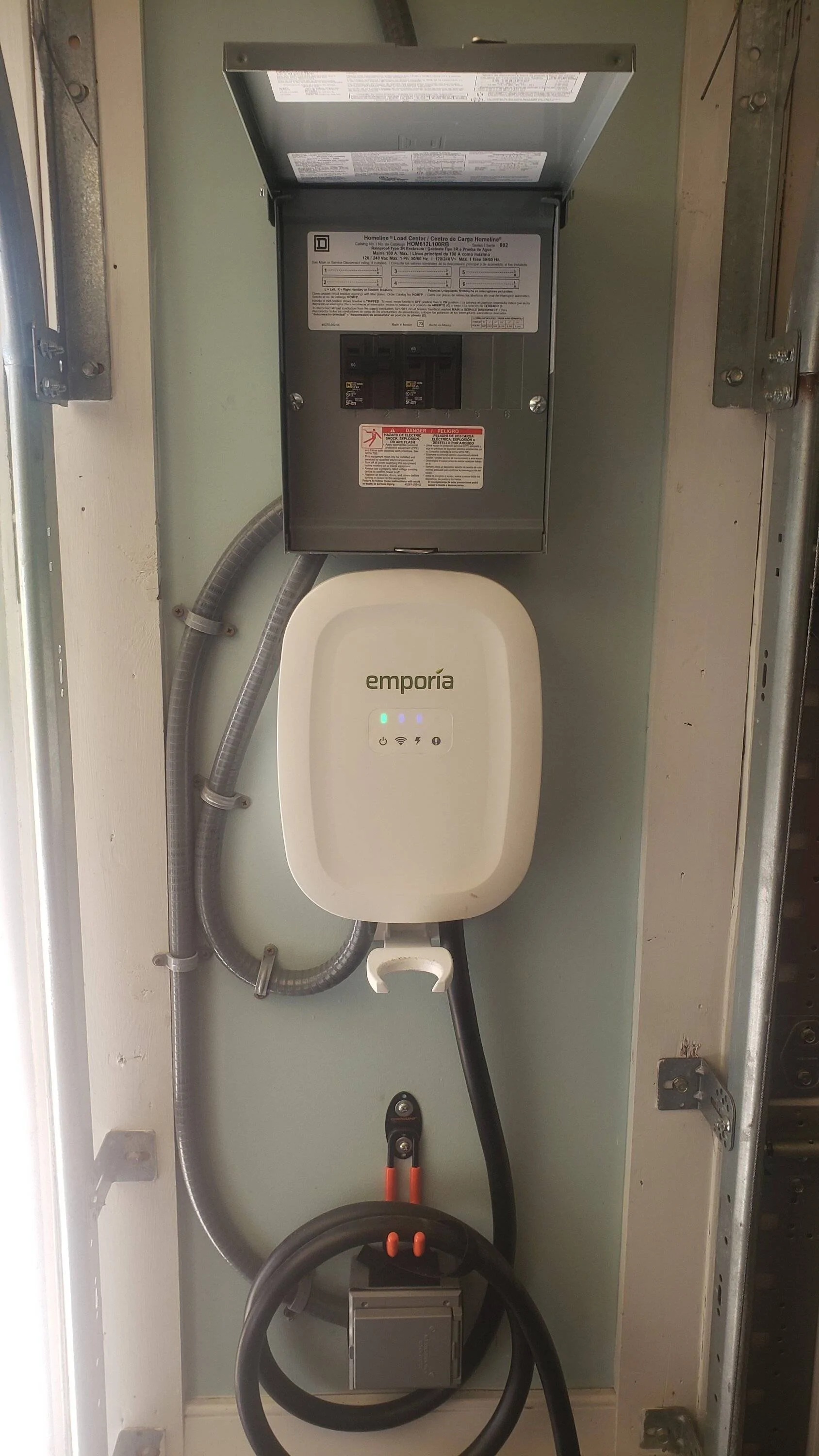

Because I want to keep the outlet in case I need it later, like if the hard wired EVSE dies. Also it might be a convenient place for a 120V outlet which you can run off the sub panel with a 15 or 20 Amp breaker.
Ford Mustang Mach-E What charging receptable to install? 1655561551436
Set mine up with this outside on a panel board with the main GrizzlE Avalanche EVSE on one side and the MachE bracket on the other. We get a lot of cold here and the low temp charge cord of the Avalanche is a necessity.
mkhuffman
Nov 19, 2020
6,875
9,507
This is my setup. I have the 50A breaker for the outlet turned off since I have not used it since I wired in the Emporia.
