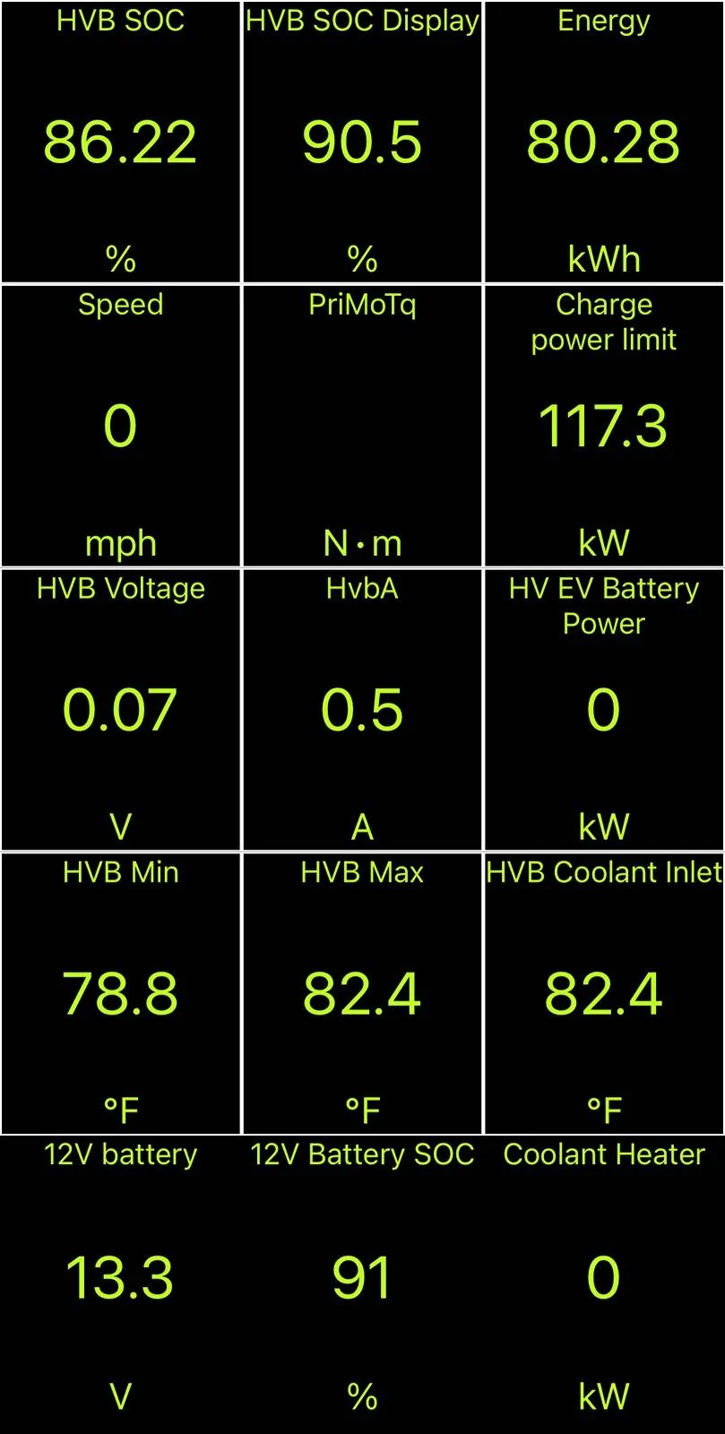

Charge limit set to 90%, it’s been done charging for hours now. The blue light is still pulsing though. Unless PAAK is just keeping it alive all the time? Has been like this for the last two weeks though. If I unplug voltage drops, I plug back in it goes up. SOC% in the 12v is normally 100% by the morning.
Some OBD2 sensors probably stop broadcasting or show strange value with ignition off. HVB Voltage 0.07V is clearly incorrect.
HvbA 0.5A - if true - suggests the HV battery was active and discharging at approx 190 watts (0.5A x circa 380V = 190W).
Looks like my L2 agrees with that. Status it’s currently reporting even though I’m at charge target.
Yes, you have the continuous charging bug and should have that TSB from post #10 done to fix that issue. It's just drawing enough power cover idle loads since the bug prevents the car from shutting down like it should.

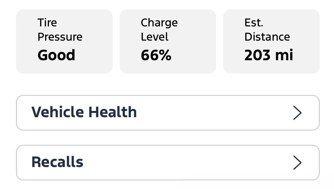

OrchidMania

I don’t know where you are seeing vehicle health. Not on app which website. Signed into ford.com. Nada.
RandyMache
Randy
Sep 30, 2023
243
109
San Marcos, California
2023 Mustang Mach e Premium
Private Investigator

I travel sometimes for weeks at a time. My 12v will go down to about 12.2v and then it goes back up to 12.9v all on it's own. I don't ever plug in my car except at DCFC. I think the it's supposed to boost the 12v battery automatically plugged in or not. At least that is my experience.

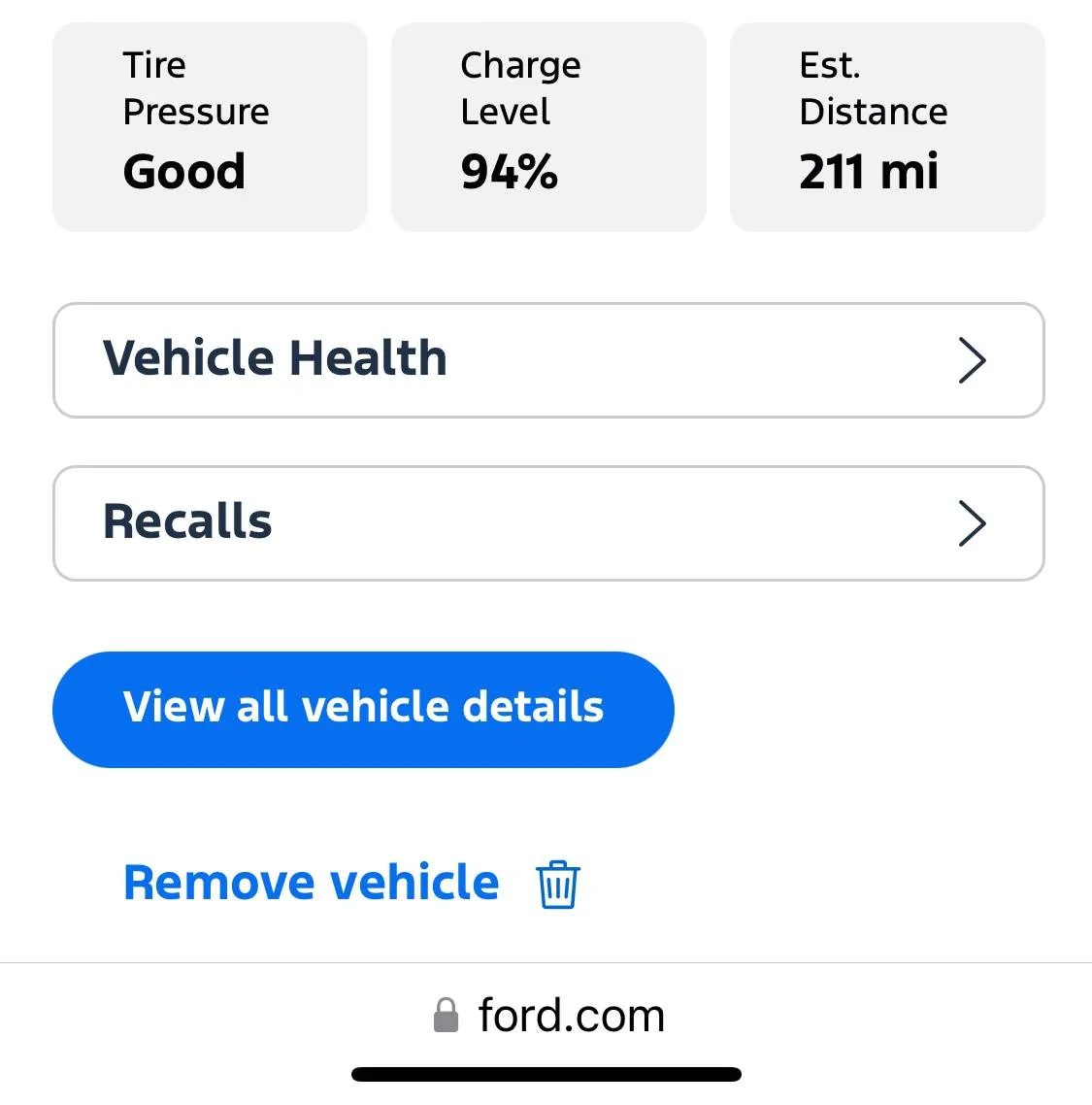

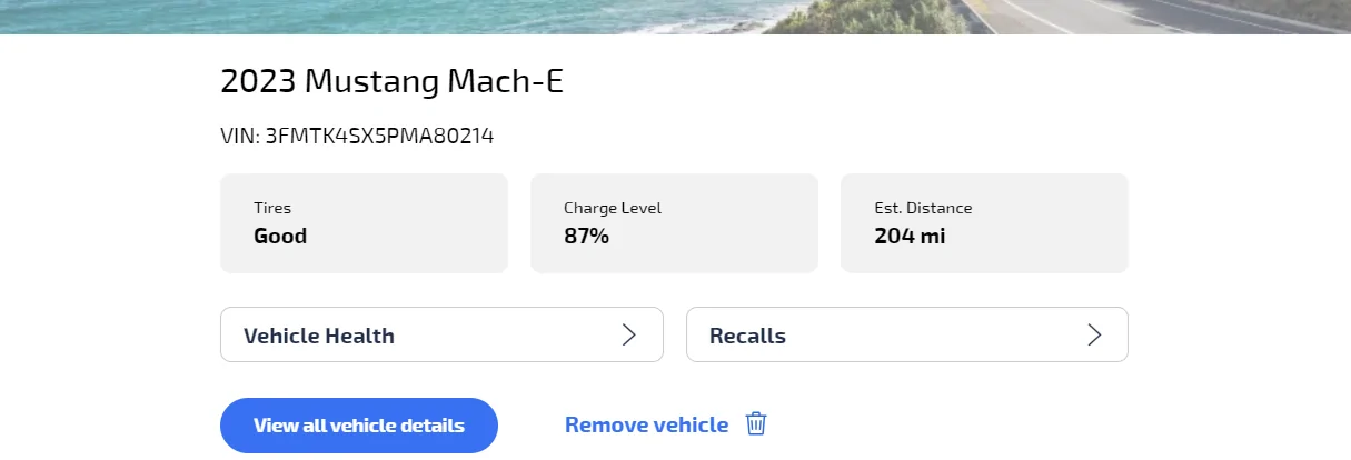

Log into ford.com then go to the upper right corner and click on the person icon, drop down menu, you'll select "...... account' (in my case it's Chris' account" this will give you the screen which shows 12v state of charge percent
