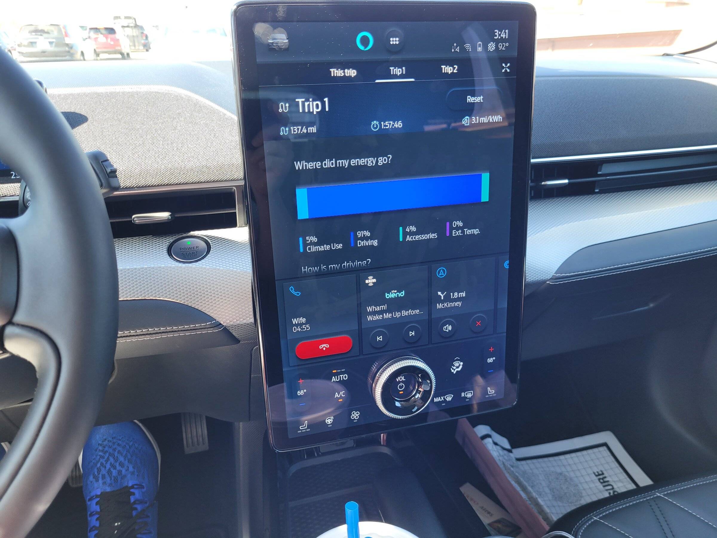

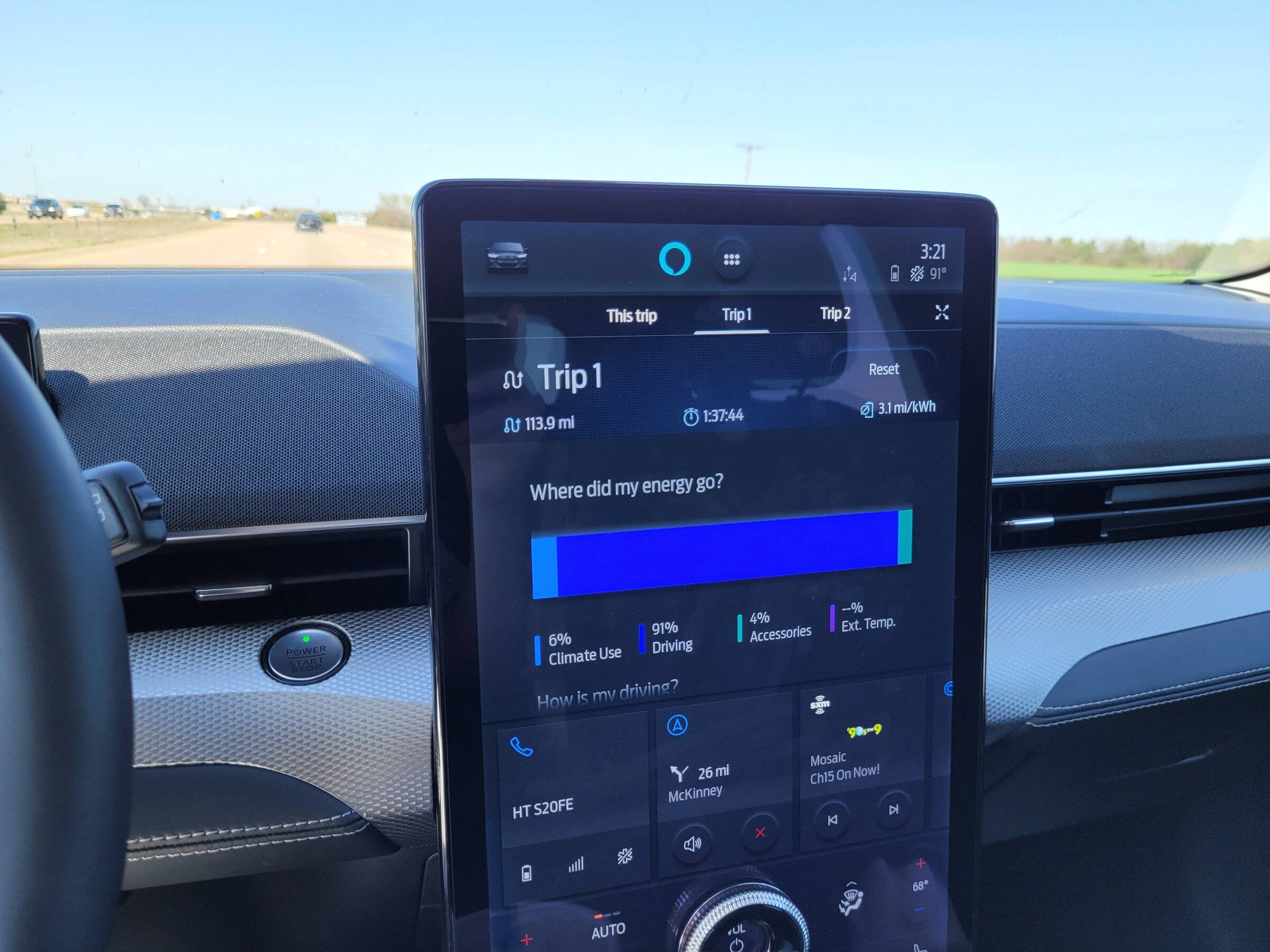

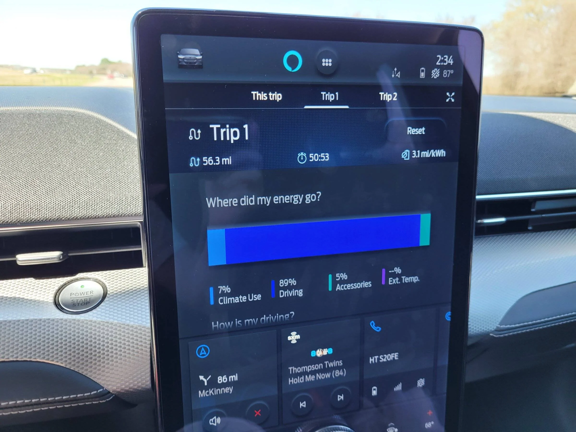

Every range test I've done over the years is the exact same. although I am going to do a 55 mph run this weekend just to compare and contrast with 70 mph. I may start doing 55mph runs also with all the EVs I test it'll be an interesting data point
Ford Mustang Mach-E Where's my range Ford? 20220327_143440
Ford Mustang Mach-E Where's my range Ford? 20220327_143454
Ford Mustang Mach-E Where's my range Ford? 20220327_152140
Ford Mustang Mach-E Where's my range Ford? 20220327_152151
Ford Mustang Mach-E Where's my range Ford? 20220327_154144
Ford Mustang Mach-E Where's my range Ford? 20220327_154155
I drove my Mach-E from Madisonville to Dallas. Here are pics of my screens. I averaged 3.1 miles per kWh when driving 70-75 mph in 85-90F with AC on, tires at 40 psi cold. I drove 137 miles on 59% of battery. If I drove to 0%, it would have gone about 230 miles. Pretty darn good when EPA combined range is 247 miles. So I have the opposite results from you, better than expected range at 70-75 mph.

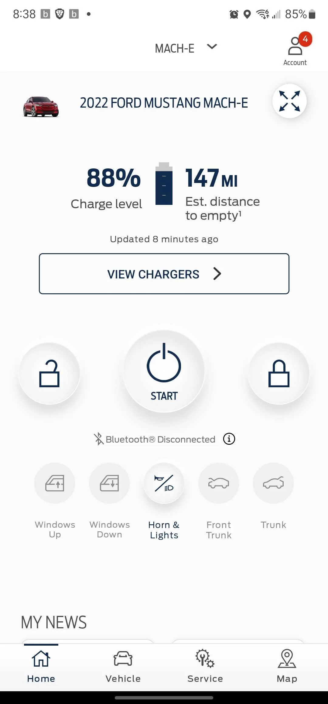

Your gom range is better than mine at 75% then mine is at 88% ? my efficiency just sucks. I can't get over 2.7 going 70.
Ford Mustang Mach-E Where's my range Ford? Screenshot_20220331-083825_FordPass
Could be a lot of reasons. Test again going the opposite direction if possible, note the wind by looking at flags, maybe get an alignment inspection?
I tested it on a 40 mile loop the other day, so I went both directions twice and then about a third of the way again before I ran out. So elevation should be canceled out. I haven't thought about alignment that's a good suggestion I mean the car doesn't pull but I suppose it could still be out a little? I'll just keep experimenting and tinkering and see if I can figure this out.

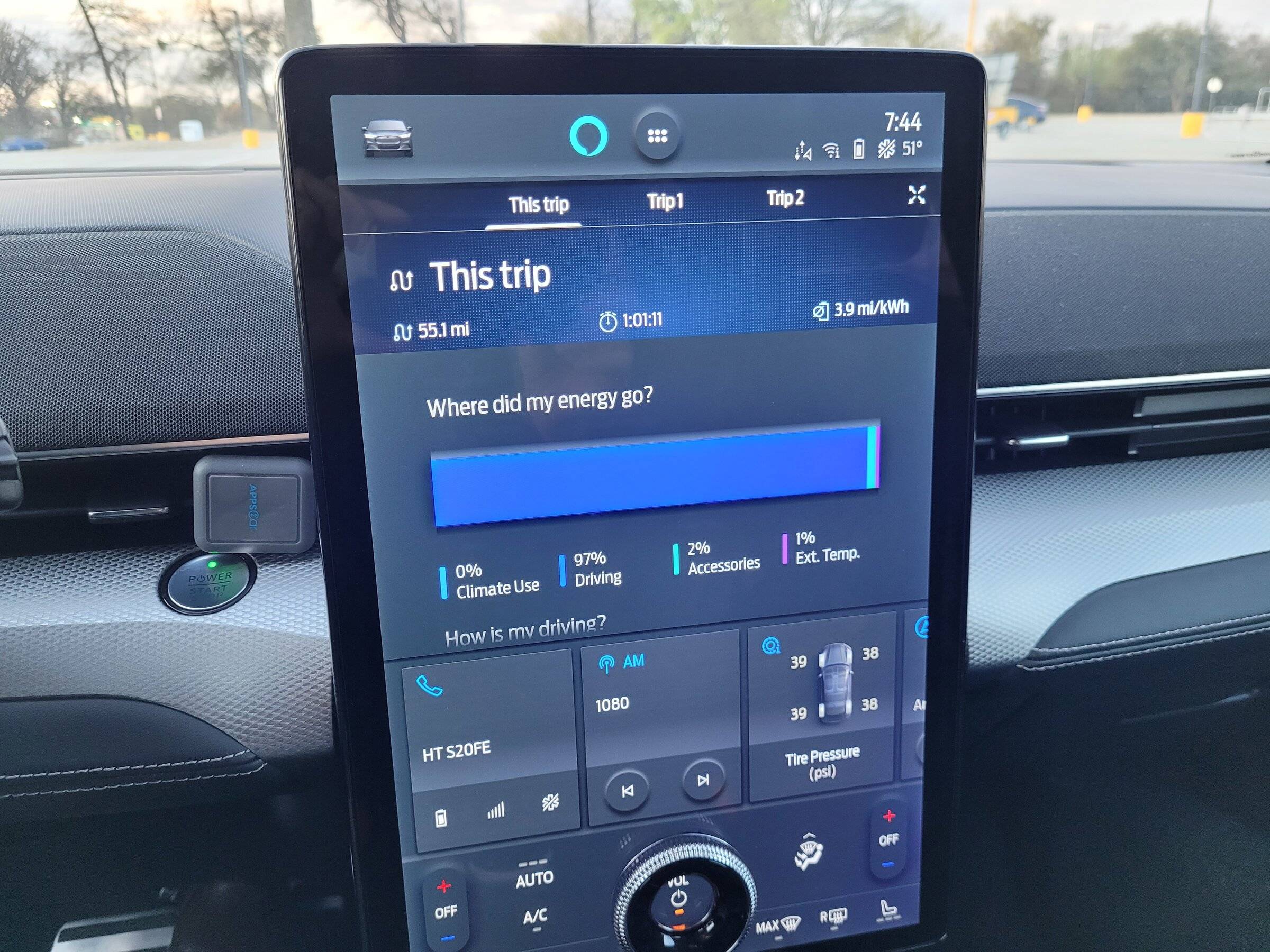

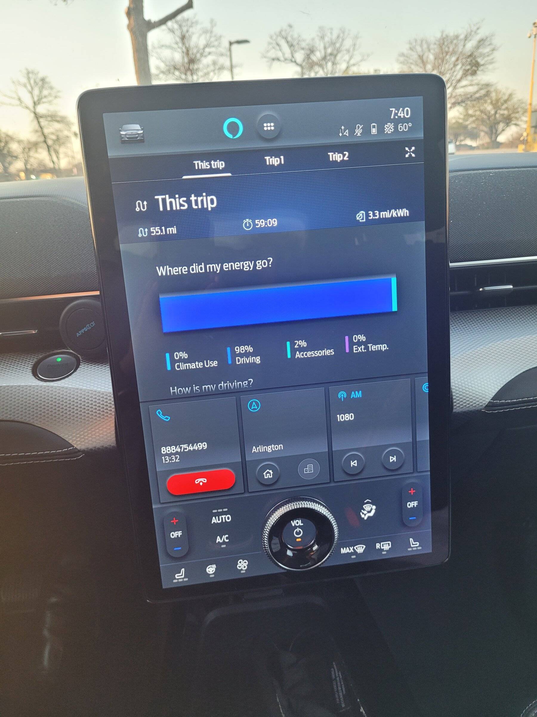

Ford Mustang Mach-E Where's my range Ford? 20220328_074023
Ford Mustang Mach-E Where's my range Ford? 20220330_113345
Ford Mustang Mach-E Where's my range Ford? 20220330_202515
Ford Mustang Mach-E Where's my range Ford? 20220331_074410
My last few commutes. I set my cruise at 75 mph, some traffic, avg mph around 60 mph.
