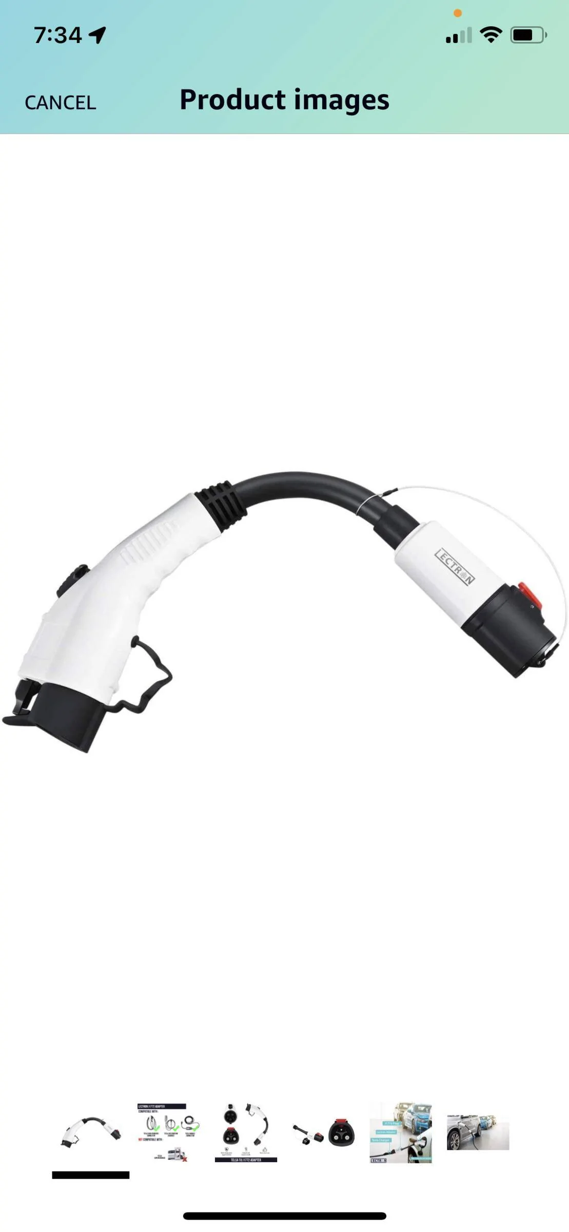

The older Lectron one on Amazon works quite well. No charging errors or faults.
Ford Mustang Mach-E Which Adapter to get? 0044AA5A-4782-480D-AE37-1DB262336594

I don’t think it pulls more. I’ve used it at Tesla 80 amp hotel destination chargers and only got 40 amp which is fine for most purposes such as overnight charging.
I actually find that 40 amp is more than most J1772 or even the Ford mobile charger at 32 amp.
