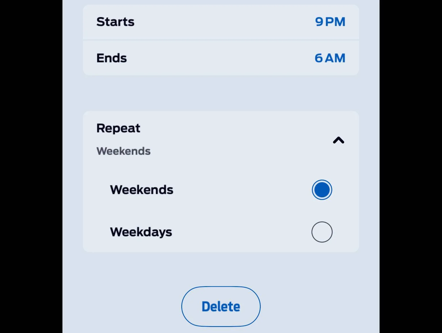

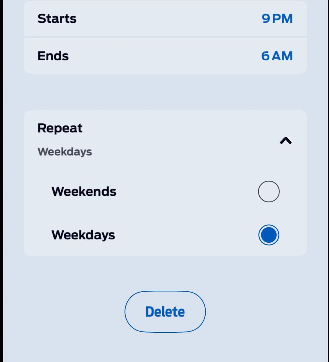

Necro-ing here, but I think I figured it out.
If you set your preferred times for, say, 9 pm to 7 am, the system will try to hit the target charge by the end of that window.
So in essence, your 7 am stop becomes your departure time.
Basically, for each "window," the car tries to reach the target by the end of the window. If it can't, it ignores preferred times entirely.
Really shitty situation for anyone without L2.
