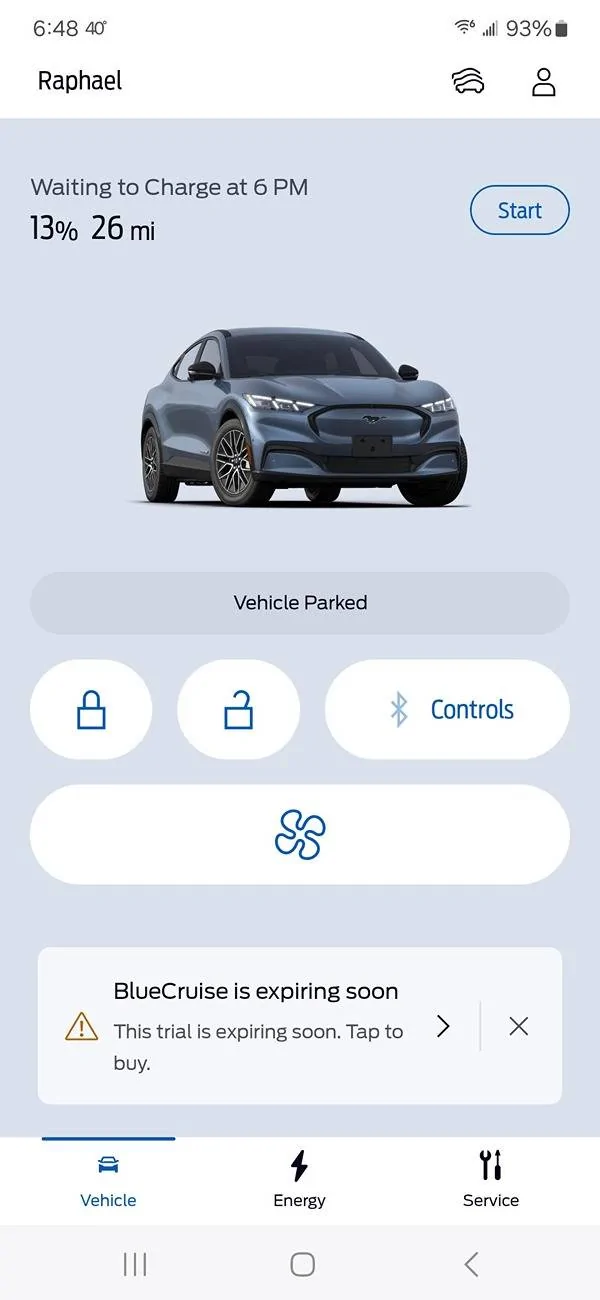

I may have spoken too soon, lol, we'll see later tonight....
Just plugged my car in...the local time here on East Coast, US is 6:48pm....
Preferred charge times are set from 11pm-6am...
"Waiting to charge at 6PM..." ?:oops:
Actual preferred times are correct in the schedule (both in app, and in the car)....
Not sure what's going on with FordPass lastely....another server glitch, perhaps? :(
