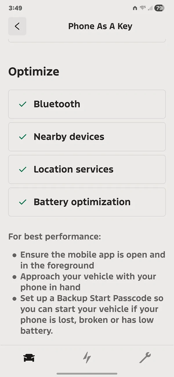

I guess I just need to do what it says in the app and always approach with the phone in my hand. It never works from my pocket but it usually does work from my hand and nearly always when in hand and awake.
Maybe my expectations are too high.

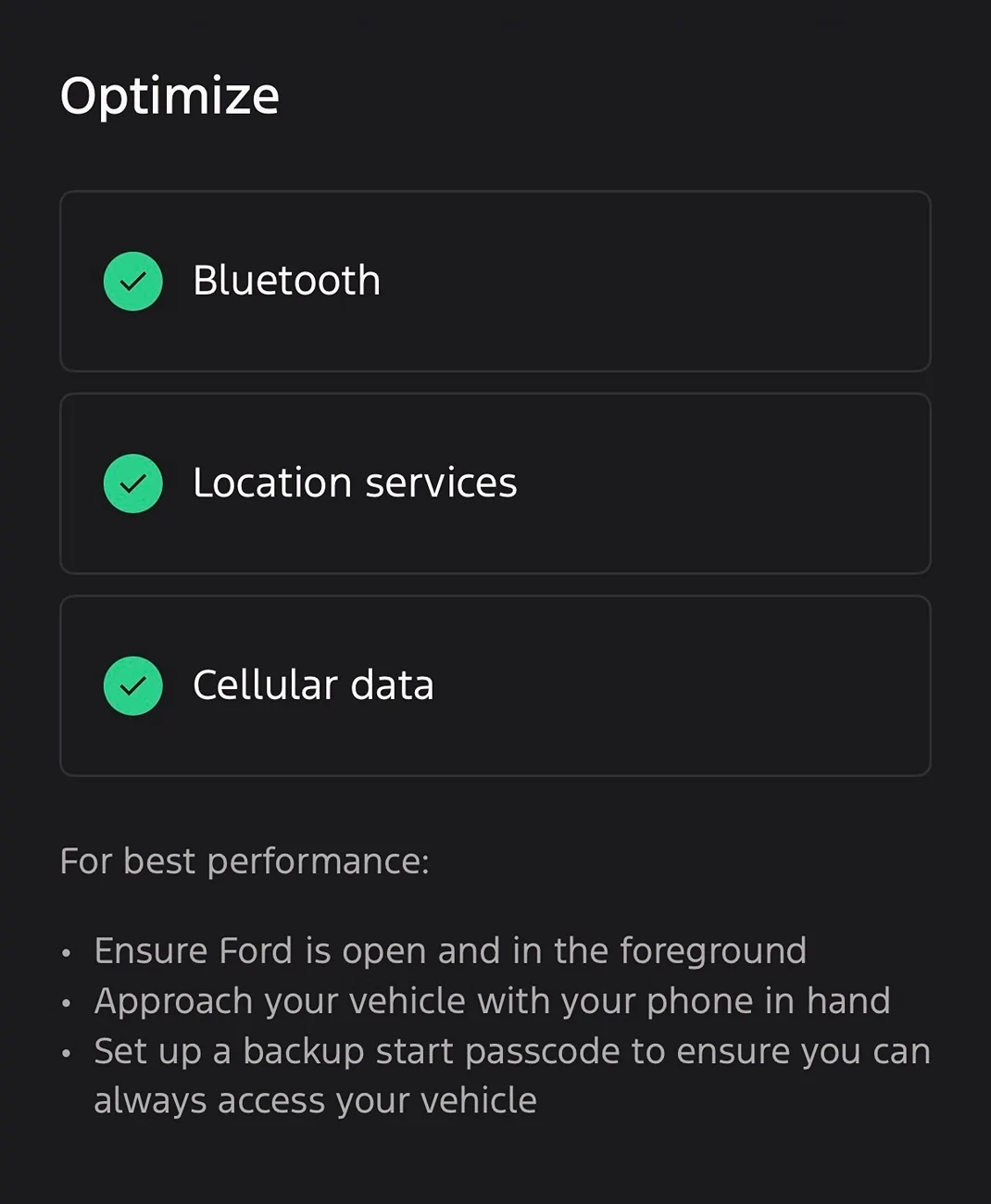

Mine looks a little different. Ford app Location settings needs to be set to allowed all the time.
