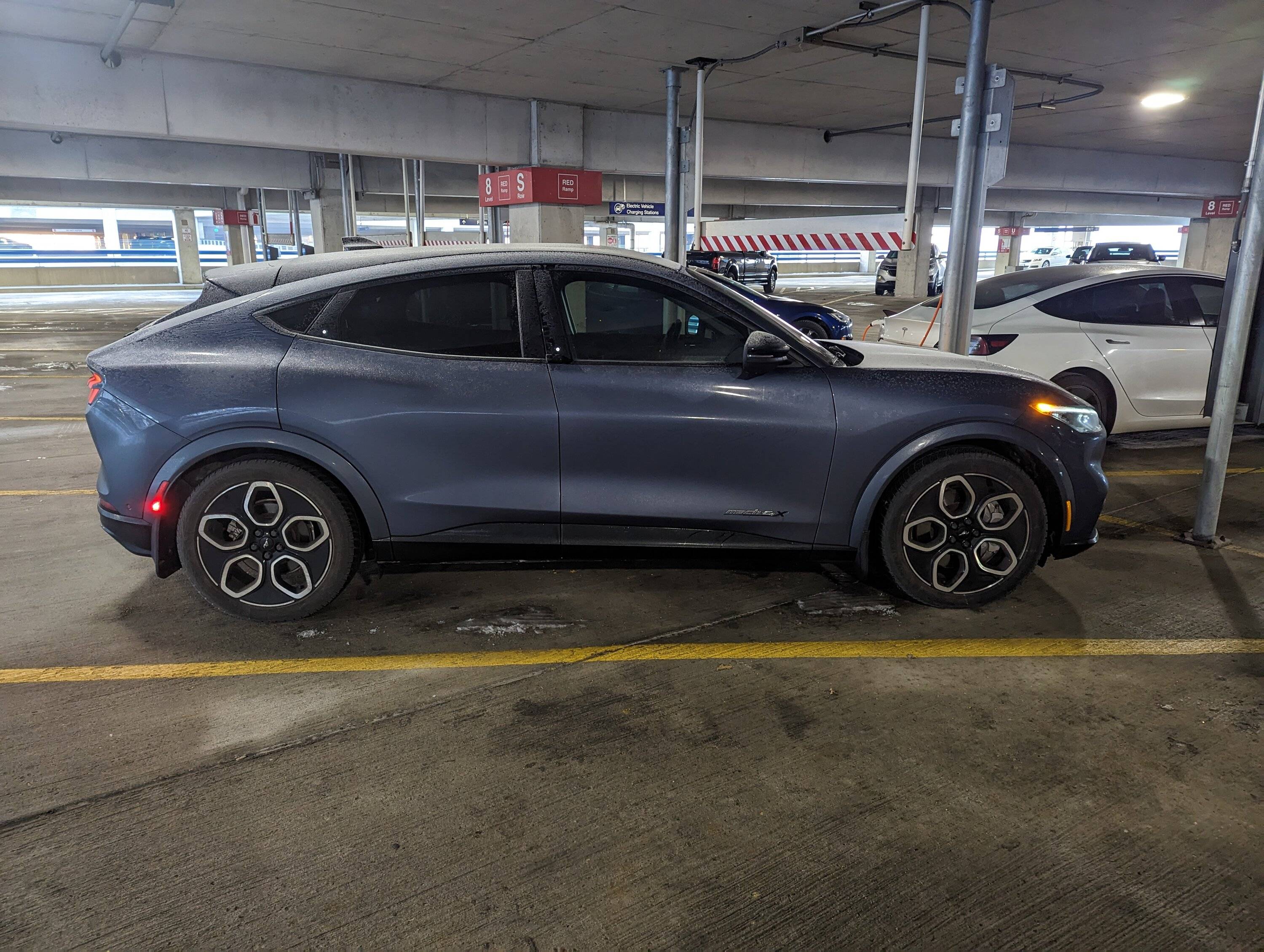

And they definitely have a negative effect on range. I haven't really been keeping track so hard to quantify exactly. Looking at the specs though, the GT is rated at 270 mi of range and the premium with 19-in wheels is rated at 290.
Ford Mustang Mach-E Will GT wheels fit a Premium? PXL_20230206_134046588.MP
