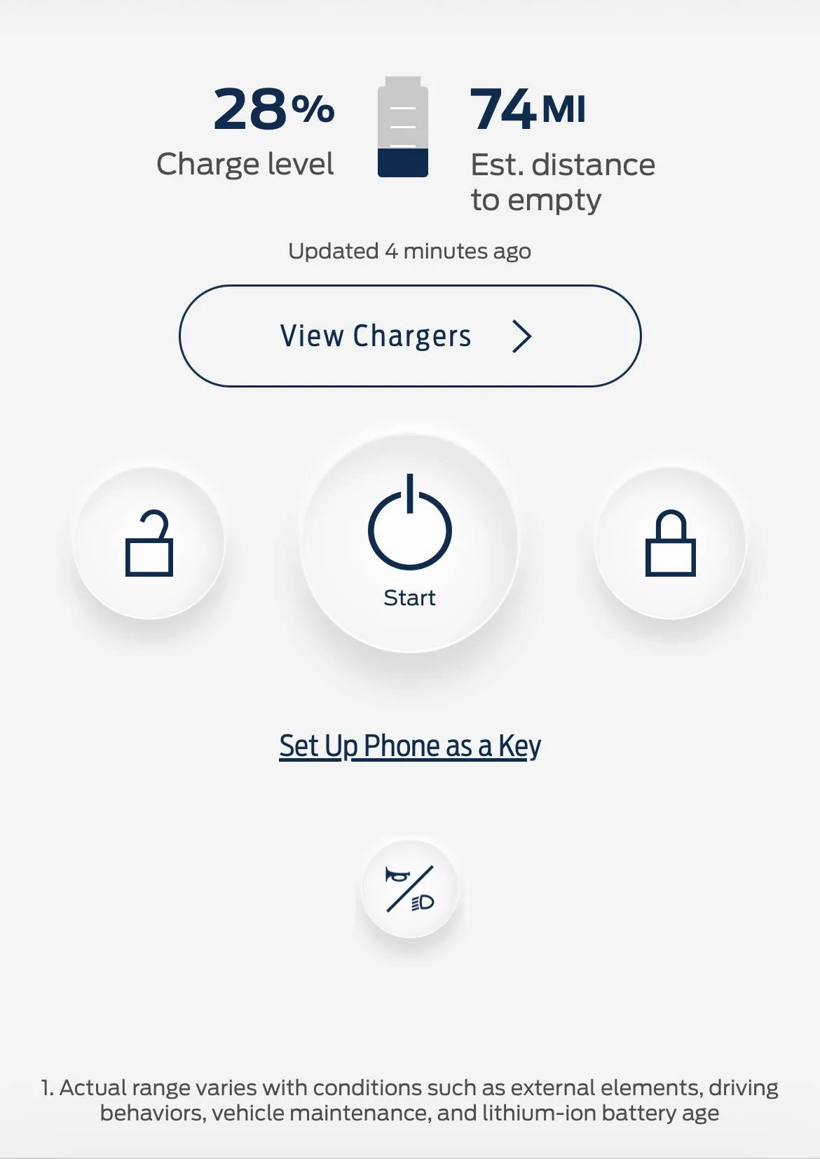

Just picked up my car today and had FordPass activated. I’m not seeing the windows, trunk and frunk buttons.
Do I need to set up PAAK in order for those to show?

Yes. The second row of buttons is only available after the connected features are enabled and PaaK has been set up. ??

Click “setup phone as a key” and follow the instructions exactly.

After the last round of updates (car and app), I had to remove my phone and add it back to my PaaK list in order to get those options to reappear on the app's home screen.
