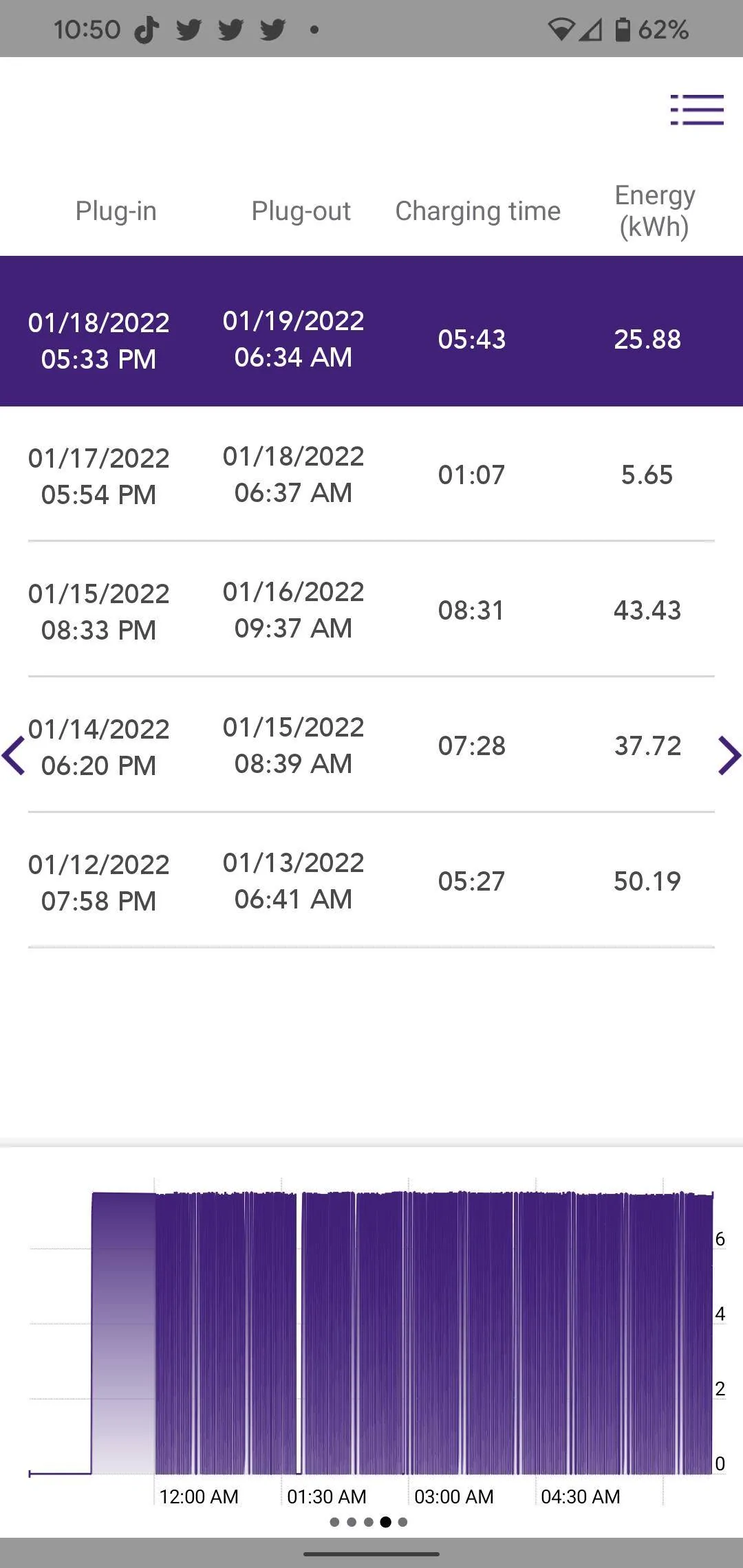

Thanks. I am adding a screenshot from the JB app. I have everything set to 90%, I am also going to take a pic of the % tonight when I charge.

Setting everything to 90% isn't what I recommended, but suit yourself.
I don't think your graph looks right. Mine is solid, not a bunch of very skinny lines, indicating that the charger is going on/off, on/off.

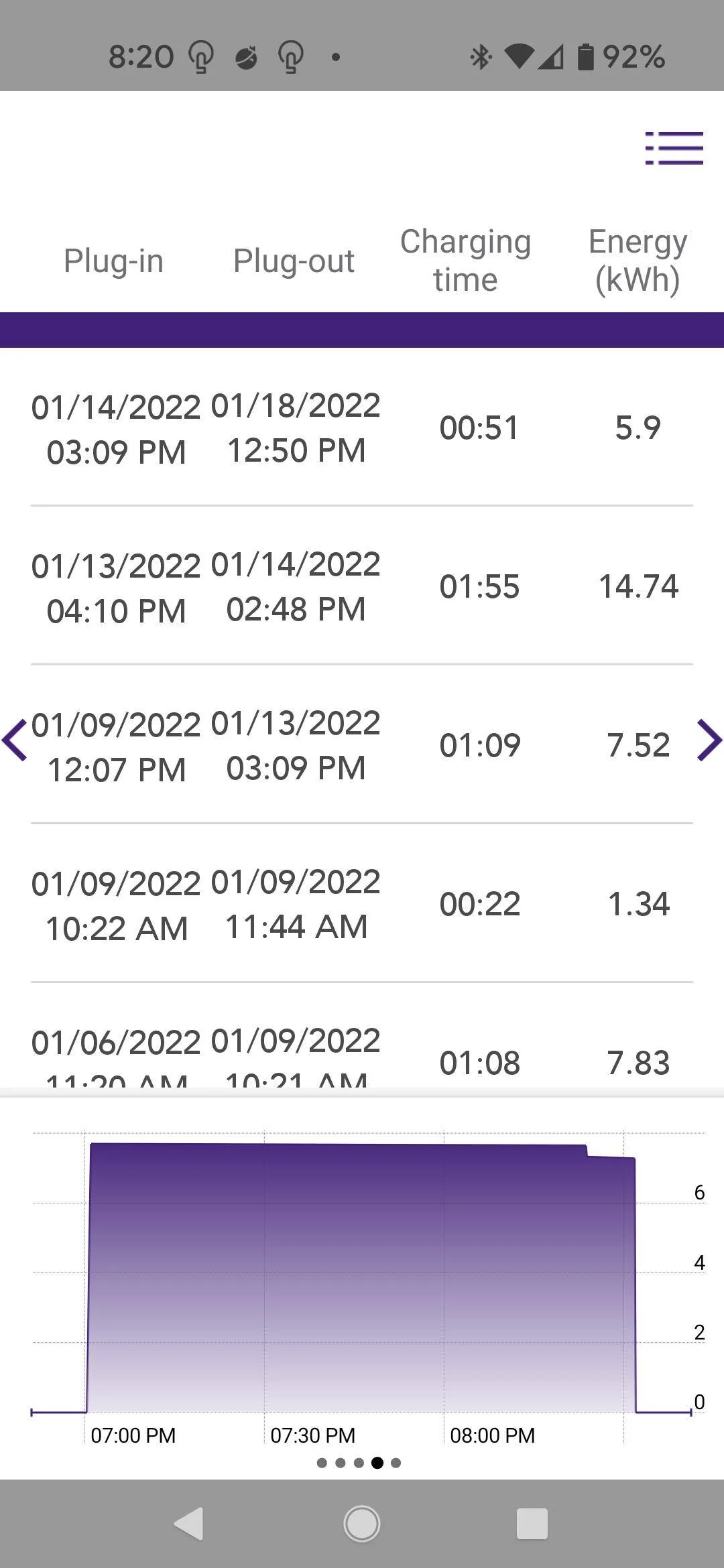

Mine looks quite different:

I'd suggest logging in to the website, home.juice.net. You should see a box where it shows your charger plugged in, and the voltage it's getting, and that it's at zero amps and zero kW. Then click on Reports, then User Sessions, then set the date range to 1/14 - 1/15.
Mine report for the 1/9 session above shows that at 12:07 I started charging, and charged for 33 minutes and 28 seconds, getting 4.217kWh. It then charged from 1:36 to 1:37 and got 0.002kWh, then from 5:00 to 5:01 and got 0.001kWh, and then from 9:45AM on the 10th for 17 seconds and got 0.001kWh.
I suspect you're going to see tons of entries indicating that something's not working right.
I'd then reset my charger to go to 100%, and set the vehicle to 90% and the hours you want to charge.
