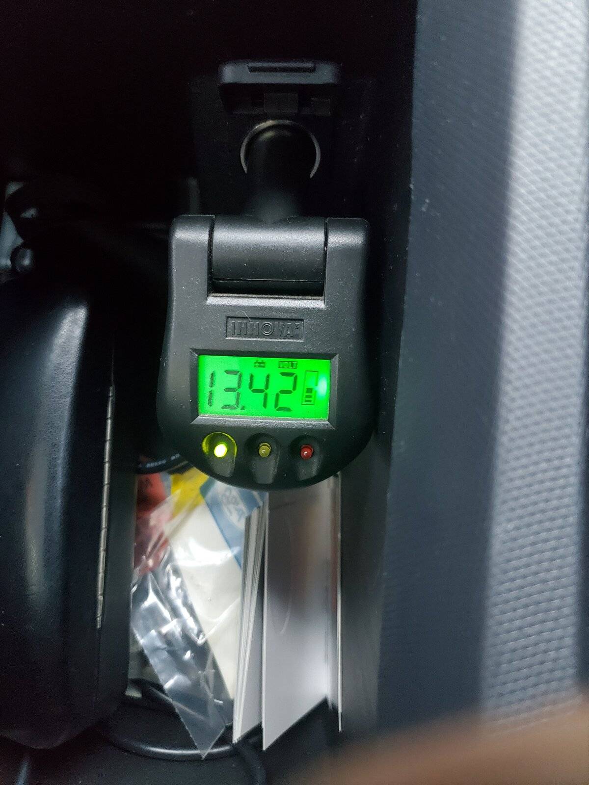

The last couple of days I have been paying much closer attention to low voltage readings. So far I have observed around 14.4v for the first part of my drive. Then after 5 minutes or so, the voltage drops to 13.4 ish and a few minutes later around 12.9. Will then bounce back and forth between 12.9 and 13.4. Usually 12.9 while under power and 13.4 while stationary.
I have no idea if this is normal operation or not. Car had been running fine since around 9:00 am yesterday morning.
Is anyone else here able to see their voltage while driving and if so, are your readings about the same?
That doesn’t seem right, it should stay at the 13.4V level while driving (after the initial 14.4V charge). 12.9V probably means the DC/DC is off and it’s draining the battery? That’s not good unless it’s brief. Low voltage can cause a module meltdown as you know. No reason to cycle the battery like that when it could remain constant.

Yeah. Been monitoring.
I have noticed if the headlights are on then I see 14.4 volts constant.
What was the aux battery SOC during these trips? Voltage is probably lower when the 12v battery is sufficiently charged. Headlights probably impose another control mode?
I started monitoring the aux battery SOC, control mode and voltage in Car Scanner Elm Obd2 app. I observed similar voltage variations but still too early to draw any conclusions...

SnBGC
When you say Aux battery.....are you talking about the LVB?
I don't have any way to check SOC except for voltage readings.
I just have a bargain meter plugged into a power port. So far, the voltage readings are consistent with my earlier observations.

13.42 volts is a charging voltage. A fully charged battery, after the surface charge has been eliminated, is 12.7 volts. A 50% charge is 12.2 volts. A 10% charge is 11.94 volts
Yes, it turned out the obd2 adapter shows not only voltage of the auxiliary 12V LVB (low voltage battery), but some more LVB parameters.
