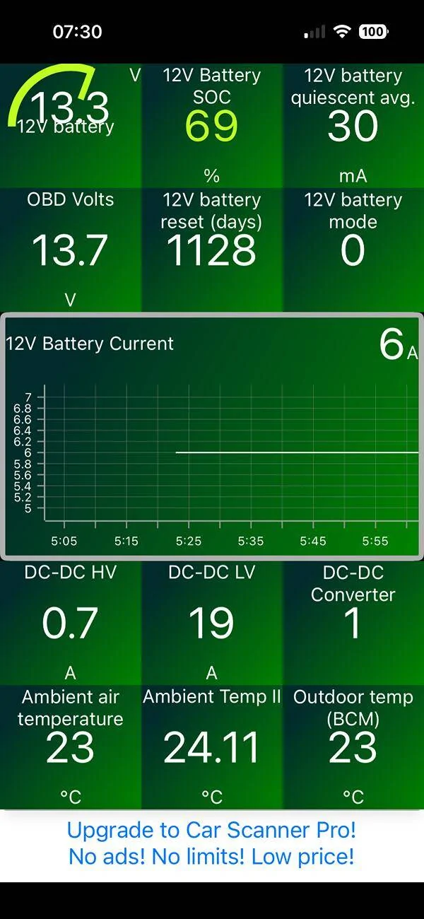

@Mach-Lee Good Day Sir!
I took my second longest road trip. 186 miles round trip with my 23 Select AWD Std NCM Batt, Early Build. Used all my tools and lessons learned from you and had a great round trip without having to charge. The Ford trip planner was off about 10% on the estimated battery usage - on the good side so I had 24% SOC when I got home.
To the question: I was half way into the return trip on I-88 and I popped on the OBD2 reader and noticed that the 12V battery was at 12.0V with a 90% SOC. I think the 12.0V is the lowest I've seen it, but this was only my second time on a trip over 20 miles. Maybe 3rd trip, anyways the Mach e is my daily drive of 37mile round trip while charging at home. Not battery alarms ever.
Should I be worried? It was a nice day Sunday at Byron IL with temps near 90. Parked at the Bryon Dragway for about 7 hours popping into the car once to get some AC. Half the trip is curvy/hilly along the Rock River on 2 lanes roads, the other half is 70mph I-88.
Thank you for your insight and have a great day!
That's a bit strange, I don't think I've seen below 12.6V while driving. You're sure it was that low and not a false OBD reading from the adapter? How long did that last? I wouldn't worry about it yet, that could be some odd software thing or some kind of decay test.
Misterrobot
Ron
Mar 3, 2024
123
81
US Iowa
2025 Mach e Premium
Project Manager
could be a glitch. I haven’t reset or unplugged the reader in forever.
lasted half the trip. About an hour. It’s fine now.
Thee reader is a OBDLink CX Bimmercode Bluetooth 5.1 OBD2 Adapter for BMW/Mini, Works with iPhone/iOS & Android, Car Coding, OBD II Diagnostic Scanner
