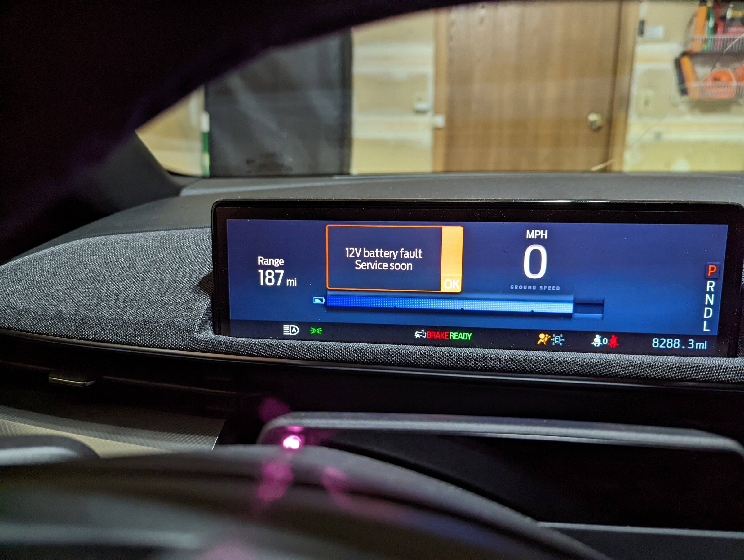

I've been getting this message for a couple of weeks now. I am trying to schedule for my dealer to take a look at it and do the glass recall, but they are backlogged and windshields are back ordered. In the meantime, I'm trying to figure this out and decide if I should leave it parked until it gets diagnosed.
Basically, the first time I start the car for the day I get a "12v Battery Fault - Service soon" message. On other starts during the day, there is no error message. I have the little voltage monitor that plugs into the 12v outlet. When I first turn the car on, it is reading 14.5v. After the car is off, it drops to 12.5 to 12.9v (I'm actually trying to remember the exact numbers, but it was in that range).

@Mach-E VLOG where you ever able to fix this issue?
I had the dealer look at this when I took it in for the glass recall. They said they "addressed the 12v problem" when I picked it up yesterday but they didn't have the details since the body shop and service departments are two different departments. I asked if they could email me the details once they find out but I haven't received anything yet.
But... This morning, I got the 12v warning again. ?

A bit of an update...
I finally got around to troubleshooting some more. I suspected there may be an app or something on my phone that was causing the issue. I started uninstalling apps and the Android widget one by one. It seems like the culprit was Optiwatt. I've messaged their support team to see if they want to work with me to rectify the issue.
Do you remember what was your Standby drain/Quiescent average drain in Car Scanner while Optiwatt was still active, and how low is it now?

Probably the easiest way is to compare how much the 12V LVB SOC dropped overnight with/without Optiwatt.
I would check the values in the evening and next morning, but remove the obd2 dongle for the night.
Standby drain/quiescent can be checked in the morning, it shows average from last night or last 24 hours.

The question is, does this mean Optiwatt the App for telling you how much it cost so charge, or, (i see the OBD dongle mentioned), the Car Scanner hardware?
The Optiwatt app installed on your phone - it seems to wake up and query the car all too often, draining the 12v battery.
Here OBD2 dongle would be used only for reading the SOC of the 12v battery before and after the test.
As for OBD dongles, any OBD dongle left in diagnostic port will eventually discharge the 12V battery (unless you get a better one with automatic power cutoff), so it should be removed after use.

As mentioned in my future post, I turned off background app refresh and closed that app until I want to check. Same with the Widget and same with the FordPass App. Something is draining my battery...

the usual suspects are dashcams run for months in parking mode... but I assume you didn't use a dashcam, as you haven't mentioned it in your post.
I use a dashcam, but I didn't wire it for parking mode. The culprit is Optiwatt. I just need then to update there app so it isn't pinging the car too often.

shrink
